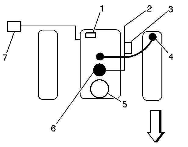

  • 177,000 MILES
My truck has a 5.3liter engine 4x4 1/2 ton, about two years ago a deer had hit the driver side of the bed, body shop did an excellent job of reparing but now I have a vaccum leak that I didnt have before, service engine light is on and it idles rough and there is a loss of power, before I start following the diagnostics machine and start swapping out parts, til I find it, I would like to chase down the vaccum system and see if its just a line that has popped off some where.
Wednesday, December 9th, 2020 AT 3:22 PM (Merged)
HMAC300
  • 48,601 POSTS
Callout Component Name
1 Manifold Absolute Pressure (MAP) Sensor
2 EVAP Canister Purge Hose
3 EVAP Service Port
4 Positive Crankcase Ventilation (PCV) Valve
5 Throttle Body
6 EVAP Canister Purge Valve
7 AIR Module,  if equipped
check by bed first, if it is on engine get choke cleaner and spray around hoses, intake etc.
