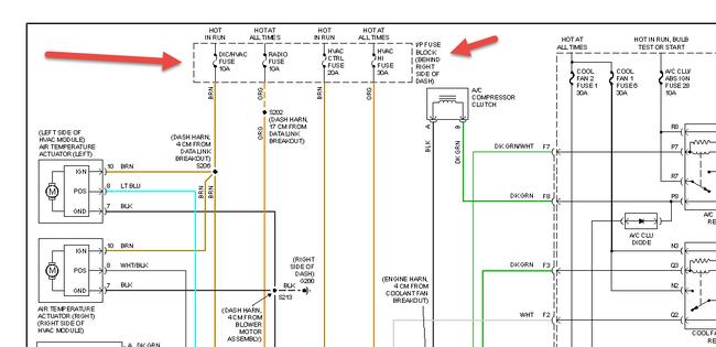

I have the manual dual climate control with the two vertical sliders to control temp. I noticed a couple weeks ago that the passenger side vents would be blow hot air despite the temp setting at full cold. By moving the passenger side temp control up and down, changing the temperature, I am eventually able to get it to blow cold air again. But eventually, after a couple minutes it will go back to blowing hot.
Do I need to replace the blend door actuator, the climate control panel in the dash, or is it something else?

Try pulling the hvac fuse for 60 seconds with key on then reinstall. sometimes it resets the actuators if not have it scanned for codes. that way it will tell if it 's the control or the actuators.

Thanks for the response. I just pulled the 20amp HVAC fuse in the fuse box in the glove box with key on. I replaced after 1 minute with key on position/engine not running, then restarted - same problem. Did I pull the correct fuse? In the owner's manual it says there is also an HVAC fuse in the fuse panel under the hood.

See pic

Thanks will try. Replaced actuator on pass side to no avail. I thinking this fuse pull will rest and make it work. Ill give it a try.

When actuators are replaced you have to do that in order to make them work. The fuse under hood is for the blower not the control unit. If still not working have a mechanic scan for codes as it may be a control problem not the actuator. An auto parts scanner cannot do this

The fuse pull worked! Brilliant. Thanks. Dan J.
