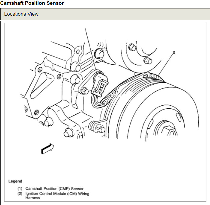

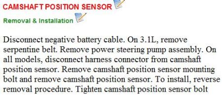

How do I change the cam shaft position sensor. Check engine light is on and a check of computer board blames the sensor.
Wednesday, May 20th, 2009 AT 8:49 PM
13 Replies
ZACKMAN
  • 4,202 POSTS
Here is a guide to help you see what you are in for when doing the job.
https://www.2carpros.com/articles/camshaft-angle-sensor-replacement
Check out the diagrams (Below) the sensor location for your car

MIL: Malfunction Indicator Light = CEL: Check Engine Light.
Difference in engine makes a big different in camshaft sensor location. In your case, the sensor is under the intake plenum.
https://www.2carpros.com/forum/automotive_pictures/55316_00grandprixcamshaft_1.jpg

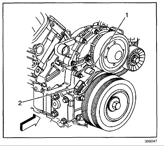

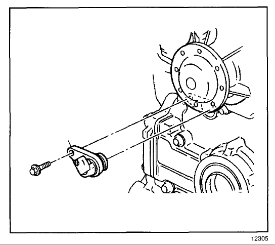

How to replace camshaft position sensor on a 2001 grand prix
Monday, March 19th, 2018 AT 12:50 PM (Merged)
  • 75,992 POSTS
CAMSHAFT POSITION (CMP) SENSOR REPLACEMENT
REMOVAL PROCEDURE
Remove the coolant recovery reservoir.
Remove the drive belt.
Disconnect the electrical connector (2) from the camshaft position sensor (1).
Remove the camshaft position sensor retaining screw.
Remove the camshaft position (CMP) sensor from the engine front cover.
INSTALLATION PROCEDURE
Install the camshaft position sensor to the engine front cover.
NOTE: Refer to Fastener Notice in Service Precautions.
Install the camshaft position sensor retaining bolt.
Tighten
Tighten the bolt to 10 N.M (89 lb in).
Connect the electrical connector (2) to the camshaft position sensor (1).
Install the drive belt.
Install the coolant recovery reservoir.
+1
