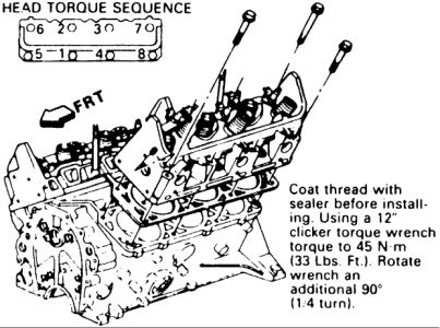

Here is how they go.
"Â The intake pushrods are identified with yellow stripes and are 5 3/4 inches long.
"Â Exhaust pushrods are identified with green stripes and are 6 inches long.
When you torque the head on these, you HAVE to use new head bolts every time. These are stretch bolts and cannot be reused.
https://www.2carpros.com/forum/automotive_pictures/561653_Head_torque_31_1.jpg
