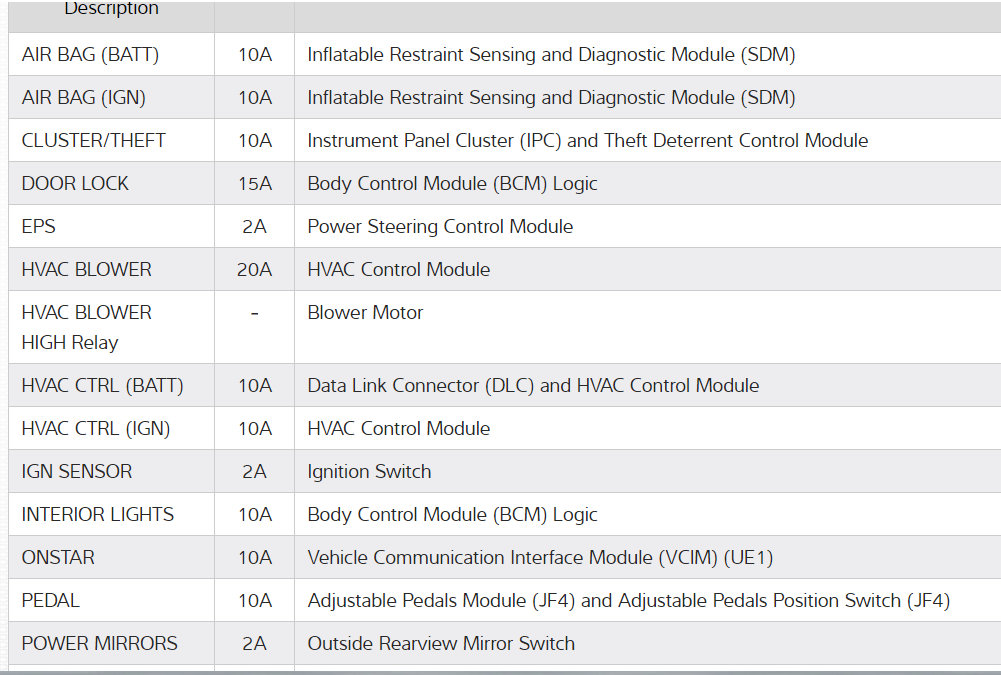

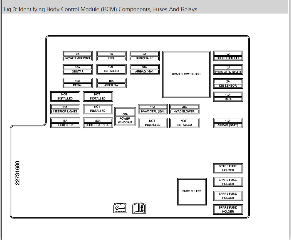

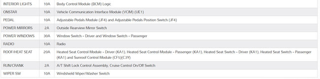

KEN L
  • MASTER CERTIFIED MECHANIC
  • 55,420 POSTS
There is a 2 amp ignition sensor fuse on the BCM. we need to check here is the fuse location and the starter wiring diagrams so you can see how the system works.
