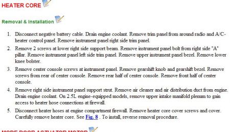

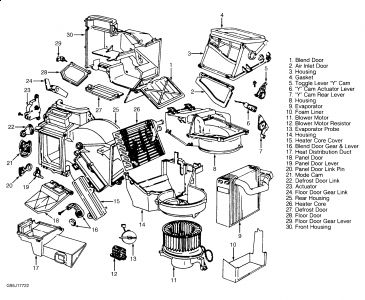

could you please tell me how to remove the heater core and re-install a new one?

Hi there. see text & pic for heater core removal.
