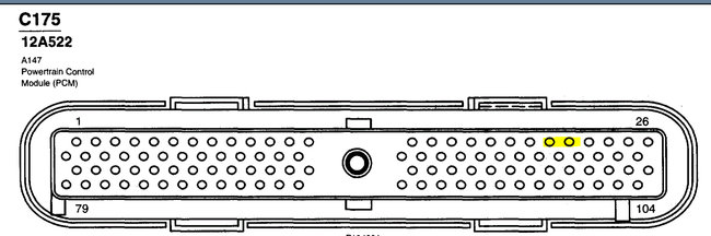

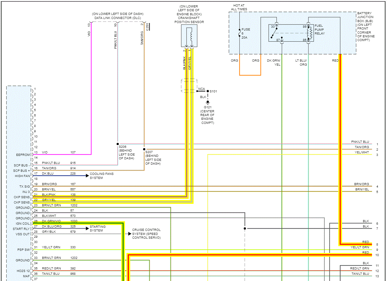

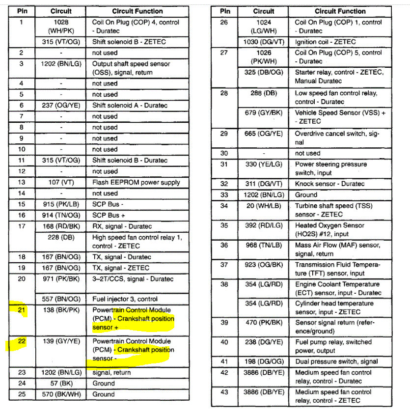

I need a pen out of the PCM for the vehicle listed above with a 2.0 Zetec engine. I have a crank signal, but I have no RPM signal and I am not getting any spark. I have power to my ignition coil. Any suggestions of what maybe going on.
Monday, November 29th, 2021 AT 5:30 PM
19 Replies
  • 110,192 POSTS

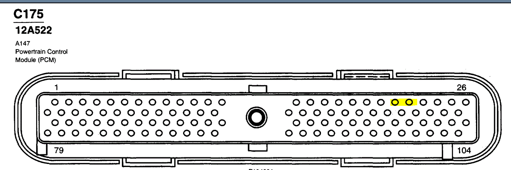

If you aren't getting an RPM signal to a scan tool, but the crank sensor is providing a signal, either you have corrosion at the PCM connector, a damaged pin in the connector, a damaged wire, or the PCM has failed. If you see no damage, check wires for continuity to see if there is an open.
I attached the pin-out for you below. I highlighted the pins in question.

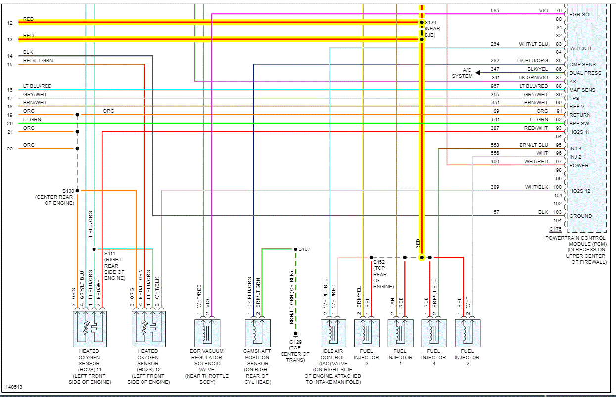

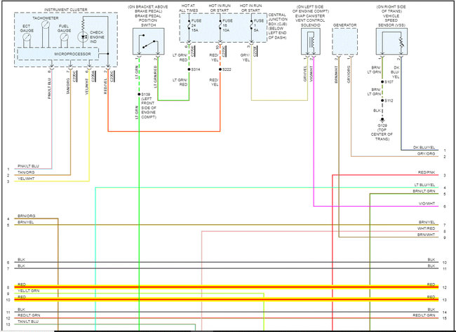

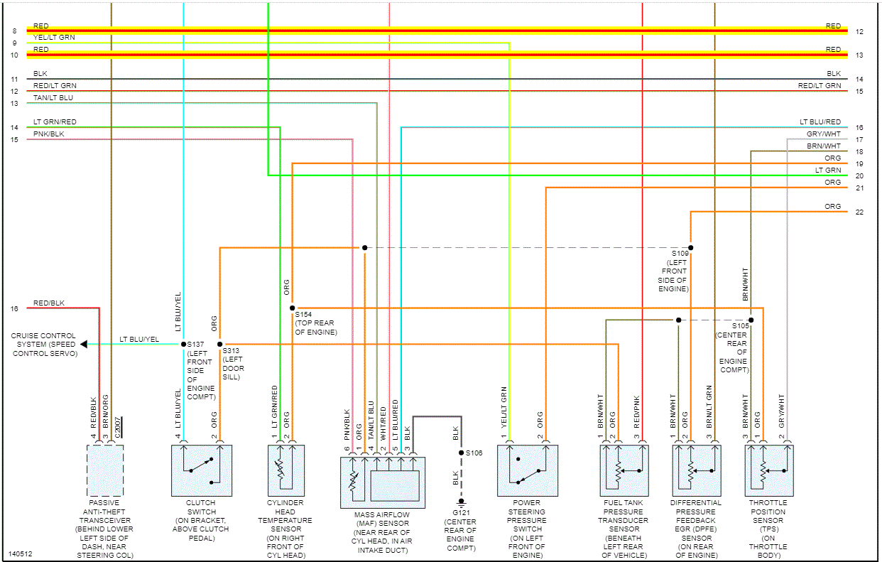

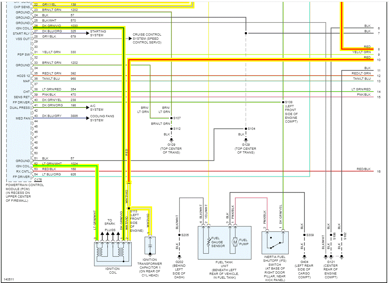

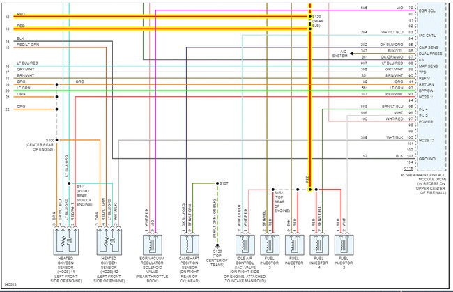

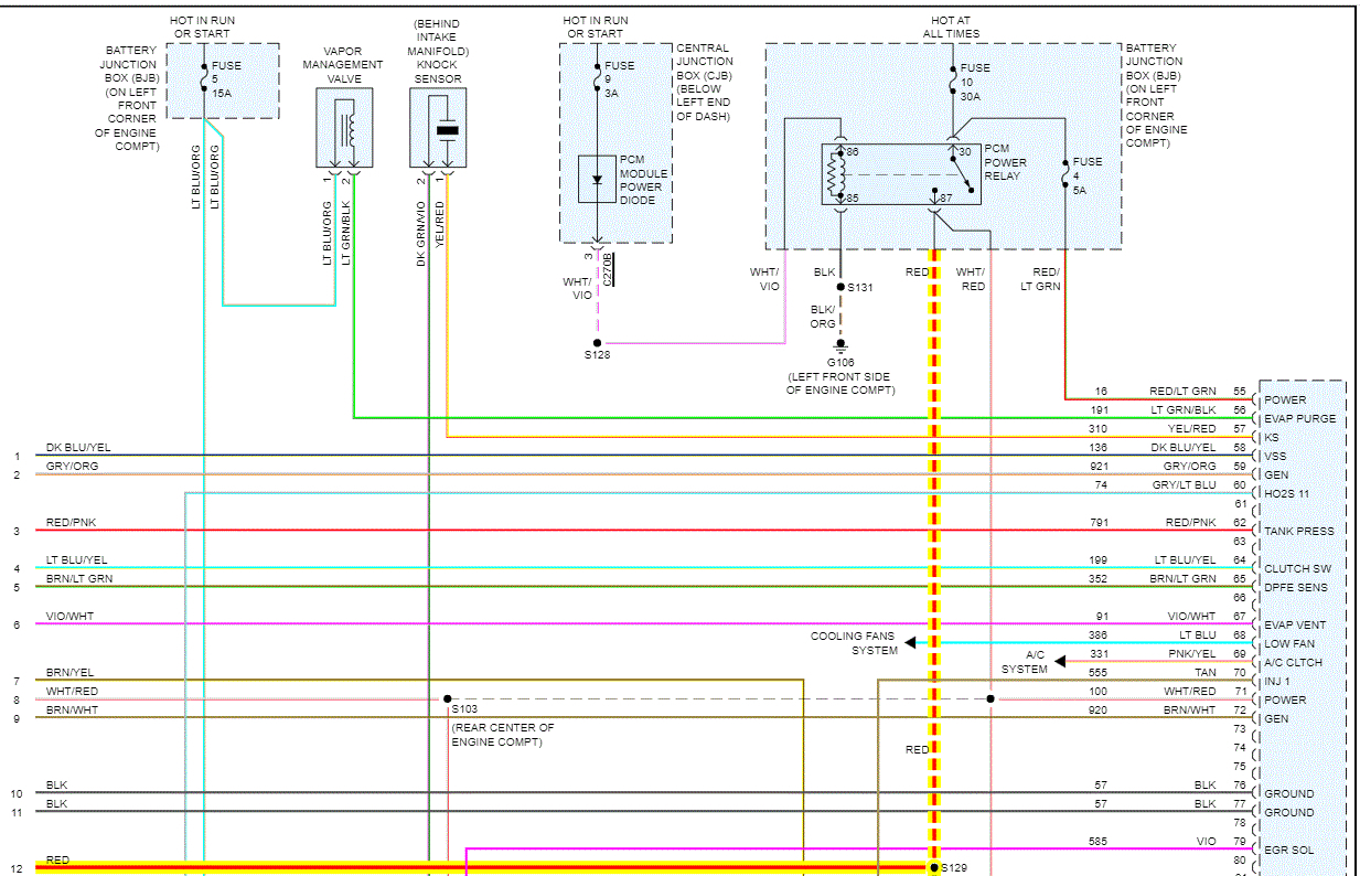

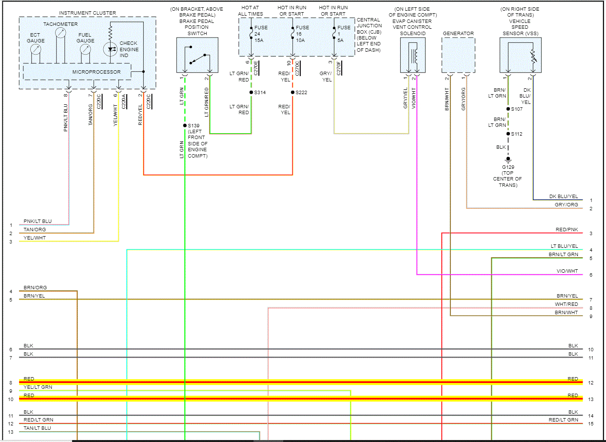

I ran through wiring schematics and started to question if it is a network issue. The tachometer receives the signal via the can which could be why the CKP signals, but you don't get an RPM signal.
I attached the wiring schematics below for the powertrain management circuits. I had to cut each pic in half to make them readable but did overlap them so you can follow from one to the next. Additionally, I highlighted wiring I feel is relevant to the issue.

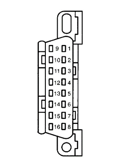

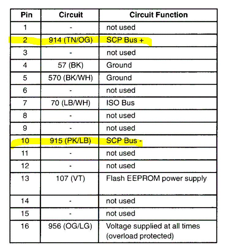

The last pic I attached shows which pins to check for the network. One is a positive and the other negative (pins 2 and 10) SCP bus + and SCP bus -. SCP stands for standard corporate protocol.
These two circuits are inverted mirror images and to properly test requires a scan tool. In this case, use a DMM and check for a 5v reference at pin 2 at the DLC. Do this with the key in the run position.
Let me know what you find.
See pics below. The last two pics are the pinout for the DLC.

On checking the 5-volt reference at the data link connector between 2 and 10 the thing jumps around from as low as 3.86 to 4.22 blinking every second, not a steady signal like I thought I would have. I'm wondering if I'm having a bad wiring harness, I recently replaced my PC M with my old one that was still good and had it reprogrammed successfully. Do you think there might be a problem with the network communication with the weird readings that I gave you up above? And if so, what do I need to check next to correct this freaking error? This truck has been down a little over six months because of this issue.

I get 1.5 volts from the crank sensor when I tested at the base where the two wires go into the harness, but when I get to the PC M side, I don't get anything so I'm thinking it's the harness I've got two other crank sensors that are good. Also that I switched around with it and all three of them do the same thing.

If you are not getting a voltage signal at the PCM, it sounds like that is where the problem is coming from. The 1.5v could be a short in the wiring.

Okay Joe, so far, I have not been able to find the part number for that harness I will give you the VIN number though, it's going to be 1FMYU01B11KB82977. It's a 2001 Ford Escape 2.0 zetec engine manual transmission if that will help you. So, I did some more testing and found that I am getting 1.5 to 2.5 V for the crank going into the harness and at the PCM I am getting 0.735v, so I am losing signal through the harness. I guess that's why I'm getting the check engine light going out but I'm not getting the RPM signal because I'm not getting the full Voltage back to the PCM.

Well Joe, I did an extremely simulated rewire on the crank sensor. I actually took two of the same size wires that it calls for and put a stranded strip down ground around it and then put tinfoil around that and then sealed it with some rubberized electrician tape. I'm actually now getting fire to the coil. It hasn't caught yet but it's trying, at least I'm closer. So, yeah, it has been the wiring harness.
