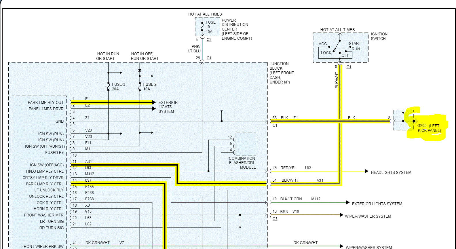

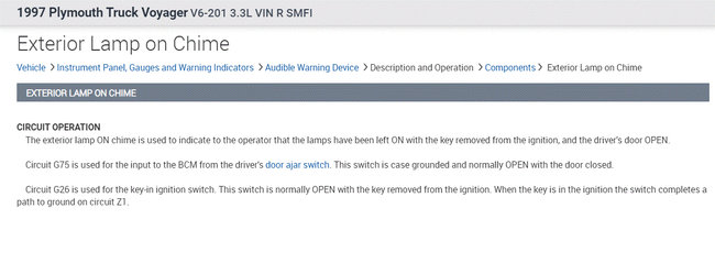

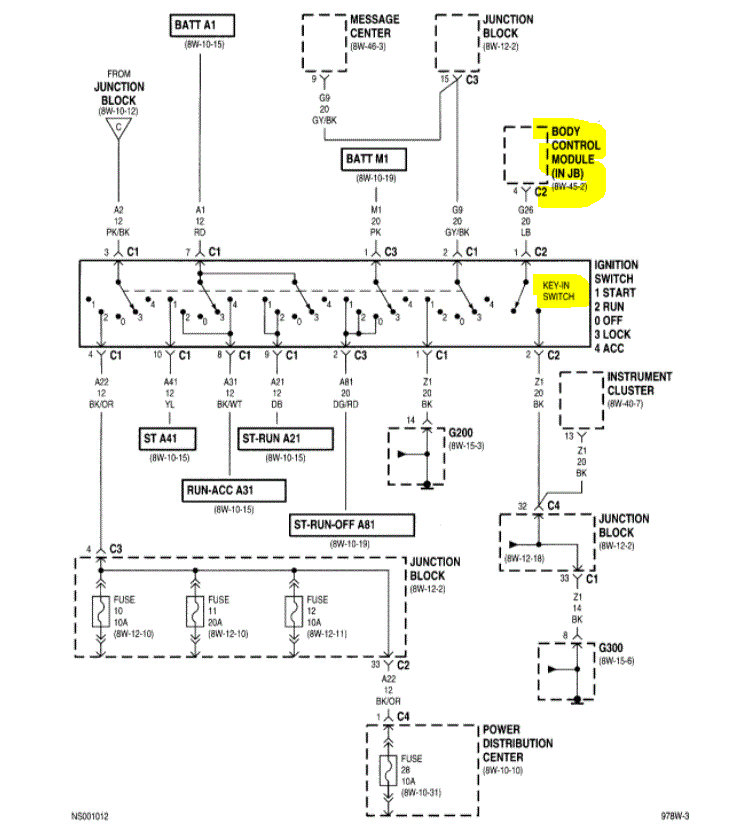

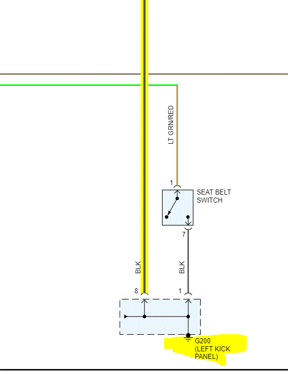

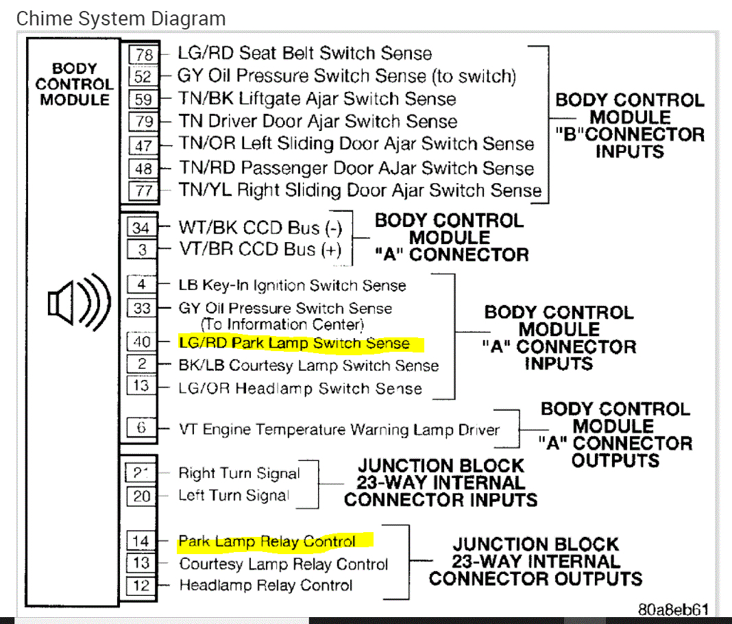

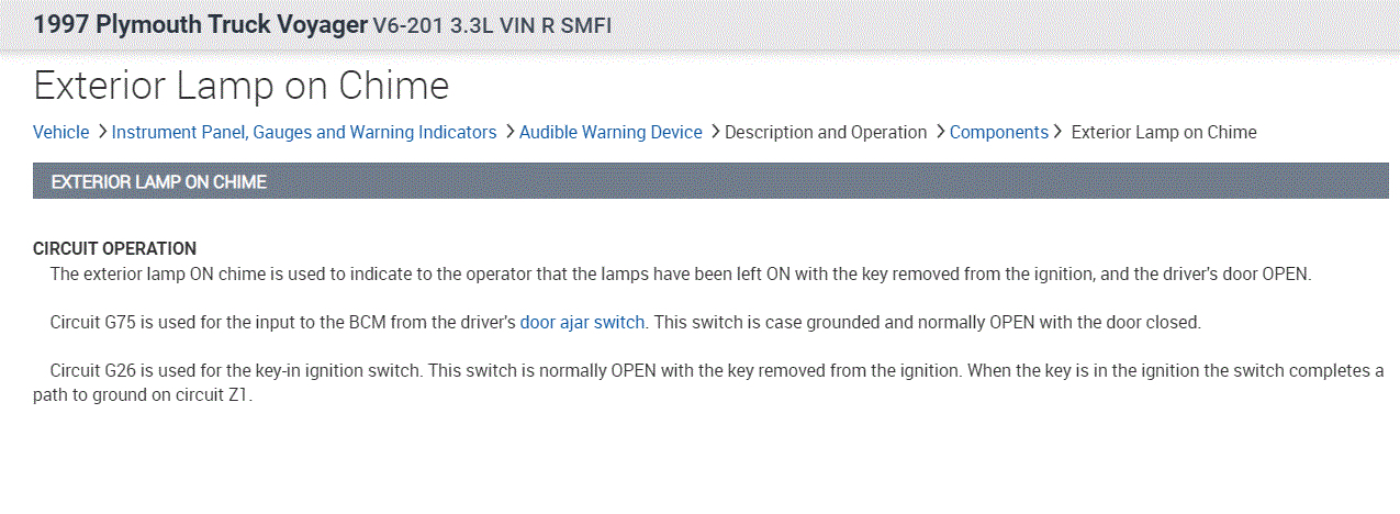

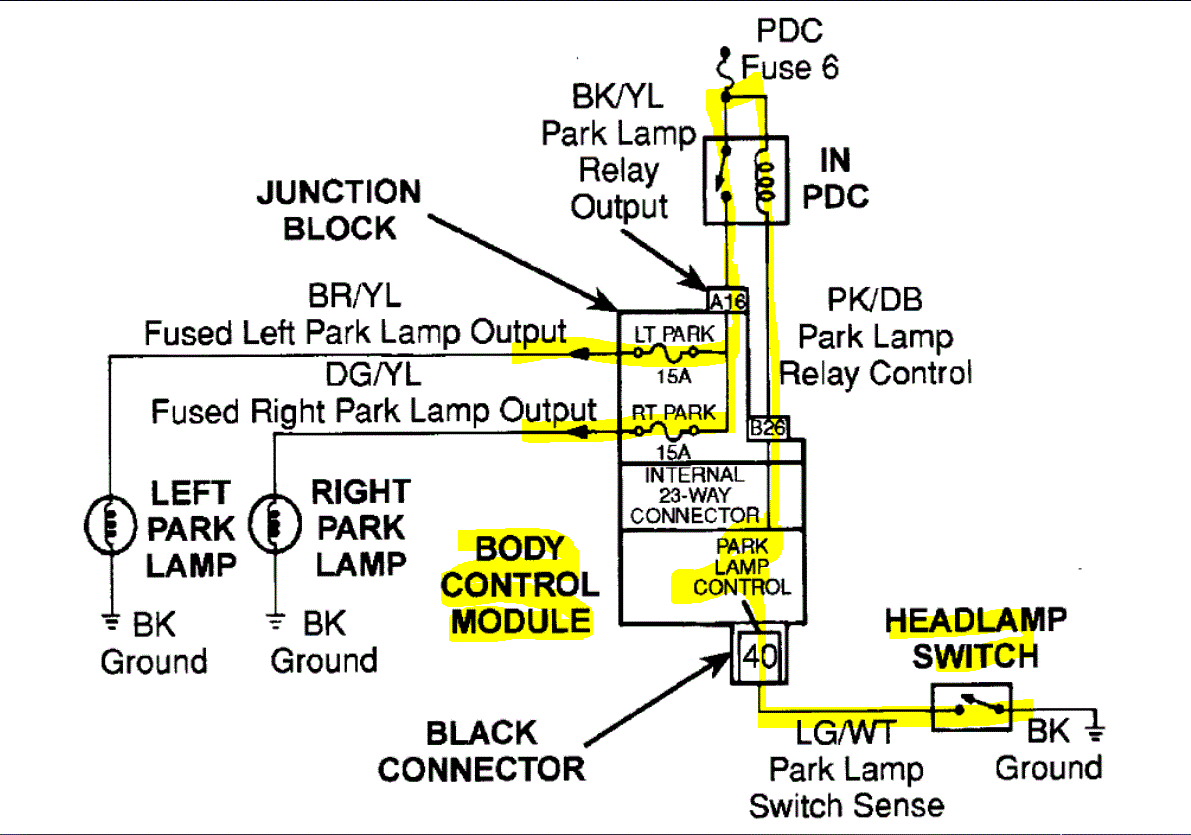

The warning chime is controlled by the driver's door ajar switch. That is what signals the body control module (BCM) if the lights are left on. The idea that the chimes stayed on regardless of the fuses, I have a feeling the BCM may be bad and shorting internally or there is a connection issue. Since removing the fuses does shut power (fuses both before and after the BCM) that tells me the problem lies between the BCM and the lights.

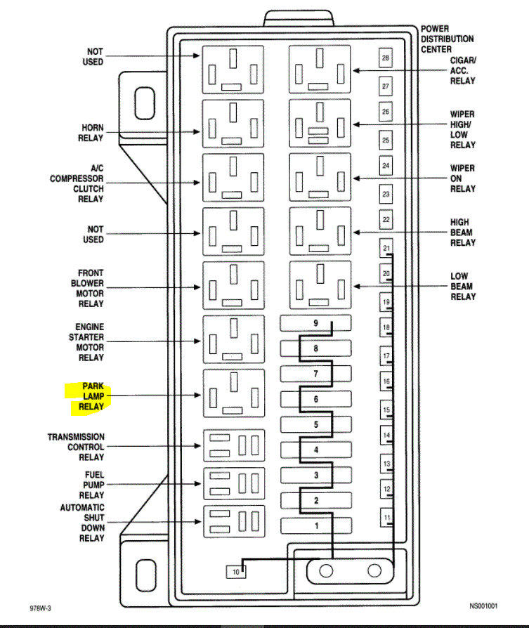

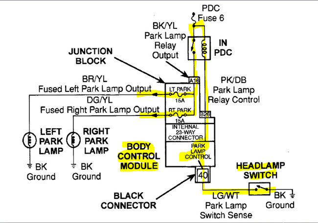

If you look at the pics below, 1 and 2 are specific to the warning chime. Pic 3 shows how the headlamp switch provides ground when the switch is on. So, either the switch isn't opening the ground circuit when off, the BCM is bad, or the park lamp relay is stuck on. See pic 4 for the relay location.
Did you check the relay itself (pic 4)? Since this is happening when the headlamp switch is disconnected, I suspect it is either the relay or the body control module itself.

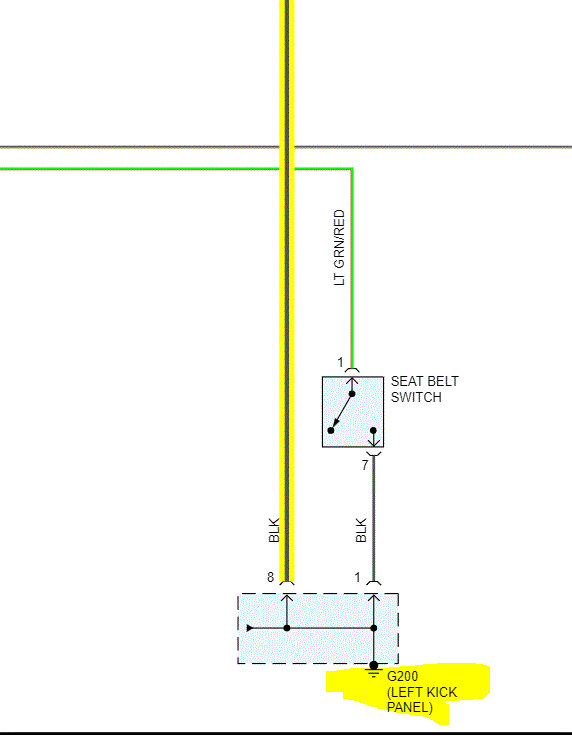

Do one last check for me. The BCM ground for the parking lights is in the left kick panel. That is where you left foot would rest when seated. Check that ground Pics 6 and 7. If that isn't bad, I would suspect the BCM.

It's definitely not the relay. There are several relays with the same number, and I've switched them with no change. So, it must be the BCM. That's the same conclusion we came to on a previous problem where the instrument lights come on then fade to nothing within 10 seconds of turning the headlights on.

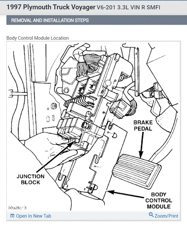

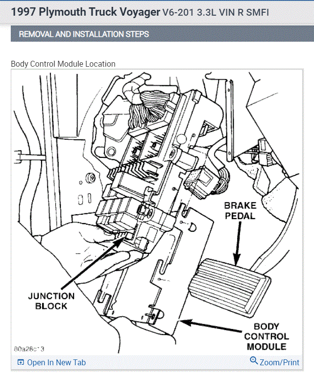

There will be a part number on the BCM. I did some quick research and found only one part number, but I could be wrong. Check out this site. They offer plug-and-play modules.
https://www.fs1inc.com/oem-bcm-body-control-module-plug-play-1997-plymouth-voyager-4686671.html
Please understand, I have absolutely nothing to do with that site, I just came across it. I don't want you to think that I or our site benefits from "selling parts" because we don't. See if you can find one cheaper that is plug-and-play. That way, you only have to remove and install it on your vehicle. The sites usually will ask for specifics such as engine size, VIN, transmission type, and so on.

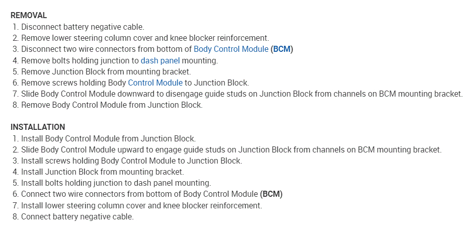

I attached directions below for the removal and installation.
I hope this helps. Let me know.
