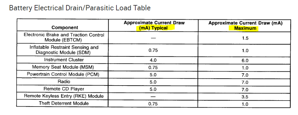

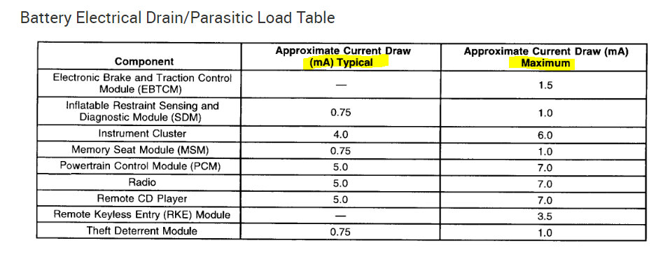

When you get the larger draw, at that point, remove one fuse at a time in the under-hood fuse box. When the draw drops back to .003 amps (3 milliamps), we will have narrowed down a circuit. Normal amperage draw should stay between 50 and 75 milliamps. 0.185 amps = 185 milliamps which is way too high.
Try this and let me know what you find. Once this is done, I can check to see what all a specific fuse powers for you. At that point, we will simply disconnect one component at a time to see which one is causing the draw. Keep in mind, this could be coming from several different areas. For example, an alternator with a faulty diode can back feed power or even an electric seat. Take a look through this link to see if anything helps:

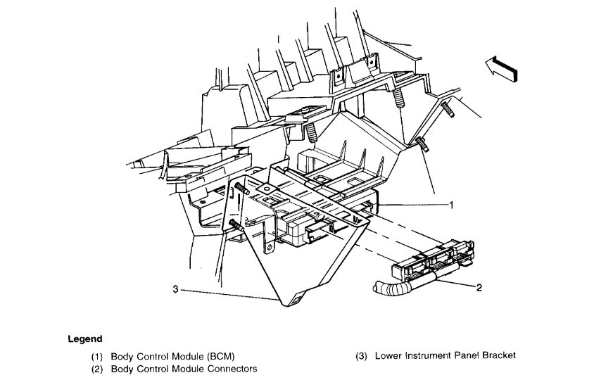

That fuse is for the body control module. Here is what to do next: On the lower left side of the IP below the steering column is where it is located. See pic below.
Disconnect it to see what happens with the voltage. If there is no change, the problem is in either the wiring or the connector. If it drops, suspect the BCM is shorted internally.

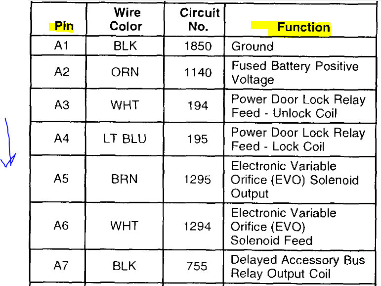

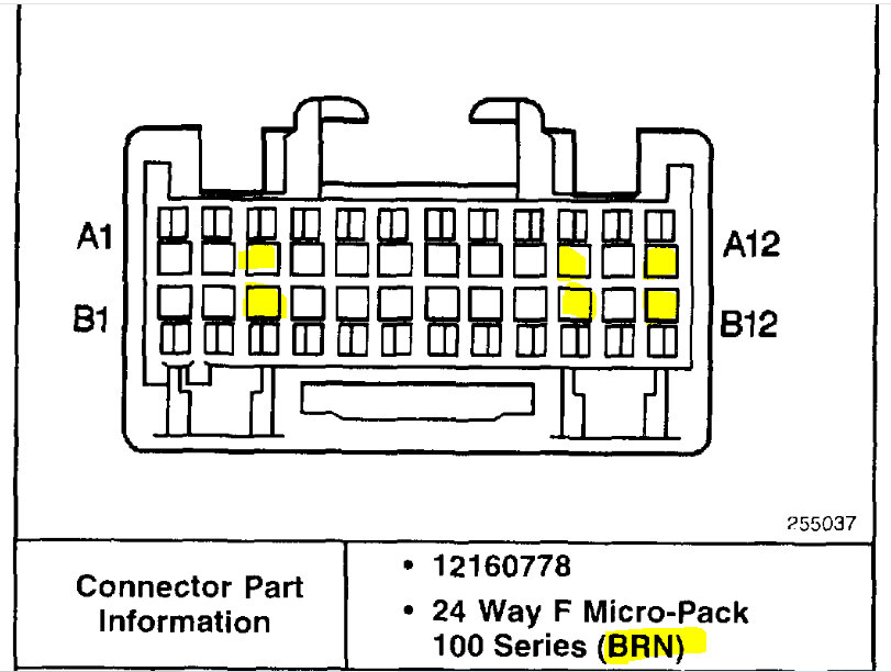

There are 3 connectors that go into the BCM: 1) the right connector is purple and made no change to the draw when removed; 2) the middle connector is lite blue and made no change to the draw when removed; and 3) the left connector is brown and dropped the draw to 0.003 when removed.
I back probed the brown connector with the draw active and found voltage on the top connector pins (3, 10 and 12). These have no voltage present when there was no draw.
Can you see what the pinout is for the brown connector and pins?

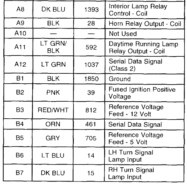

The two rows of connector pins are identified as A and B. The pins are A1 to A12 and on the bottom, B1 to B12.
I'm not sure which you are referring to, so I attached the connector pin layout along with what each pin is for.
Let me know if this helps.

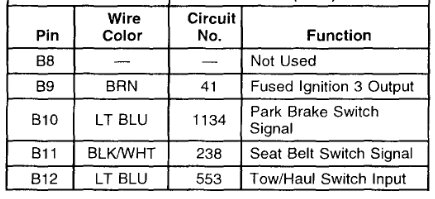

This is nice information to have.
The connectors with voltage with the draw active are B3, B10, and B12. I thought B10 was going to help because that is the parking brake switch. I unhooked the lead at the parking brake switch (goes to B10) and there is no change.
B12 goes to tow/haul mode but the truck has a manual transmission so there is no tow/haul mode.

I'm out of ideas. The best I can get the draw is to 0.067 amps with the CTSY fuse pulled (other than pulling the TBC fuse). I think 0.067 amps is at the upper end of the acceptable draw range.

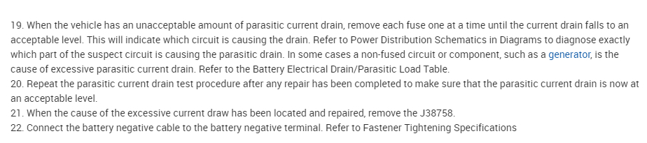

B2 is a voltage reference feed. Do me a favor. Disconnect the connector on the 4wd shift motor on the transfer case and see if the voltage drops.

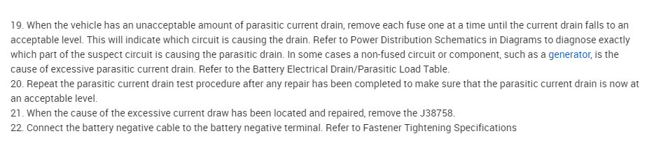

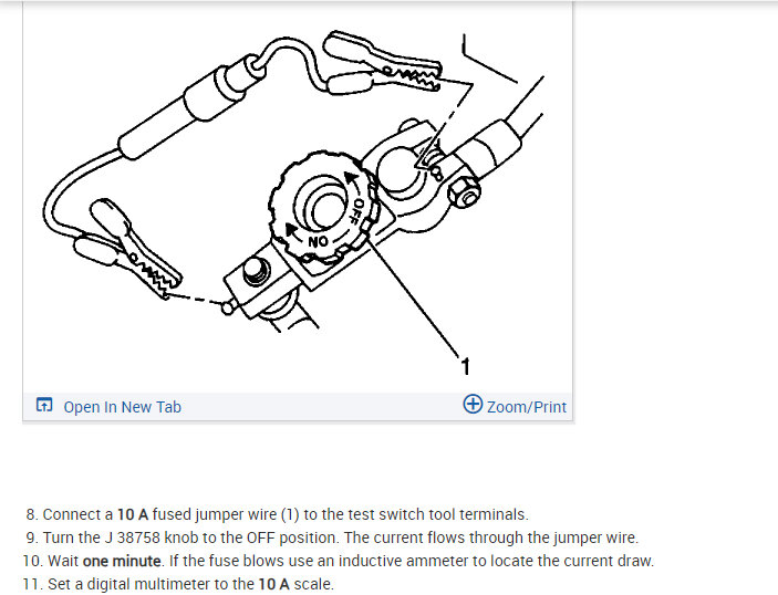

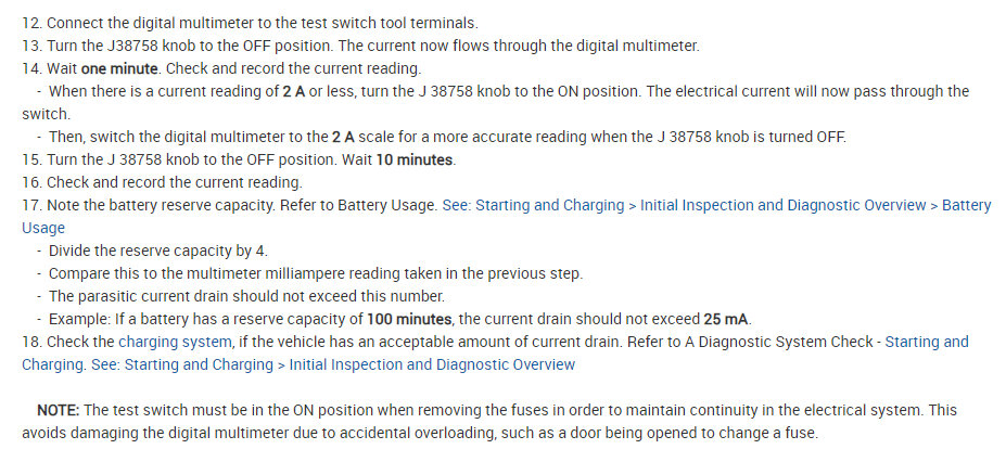

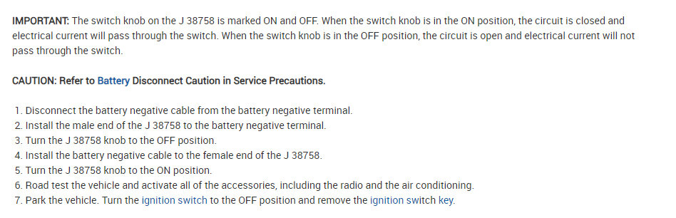

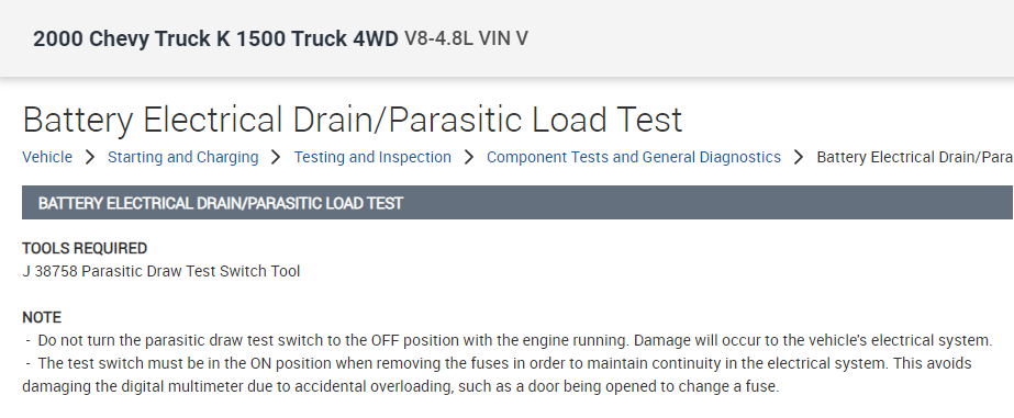

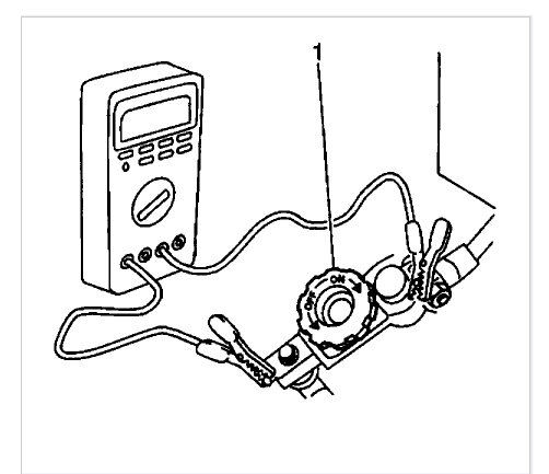

Also, I attached diagnostics below for a parasitic draw. Take a look through them and maybe we missed something.

I don't have the parasitic test tool but I connect my multimeter inline as it describes to measure overall amperage draw. My meter goes up to 20 amps.

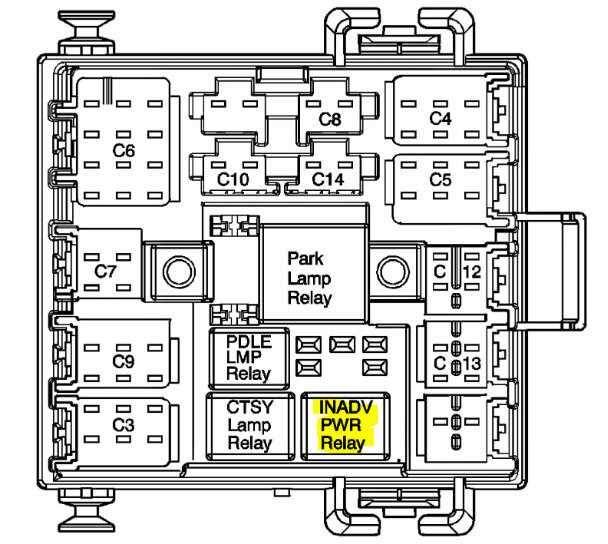

As far as the CTSY fuse, that powers the inadvertent power relay. This relay is what powers things when the key is in the off position, and it is located in the interior fuse panel under the dash.
I attached a pic below showing the relay location. Remove it and let me know what happens to the draw.

With the inadvertent relay pulled, this is what happens:
I connect the negative battery cable and 2 mins 15 secs later the draw settles to 0.003 amps. When I open the driver's door, the draw initially goes to 0.528 amps then settles to 0.110 amps in about 15 seconds. When I close the door, the draw stays at 0.110 amps for a few seconds then settles down at 0.067 amps and stays there.
With the inadvertent relay in, this is what happens:
I connect the negative battery cable and 2 mins and 15 secs later the draw settles to 0.003 amps. When I open the driver's door, the draw initially goes to 2.058 amps then settles to 1.665 amps in about 15 seconds. When I close the door, the draw stays at 1.665 for a few seconds then settles down at 0.184 amps and stays there.
