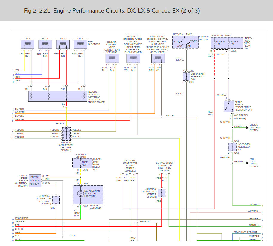

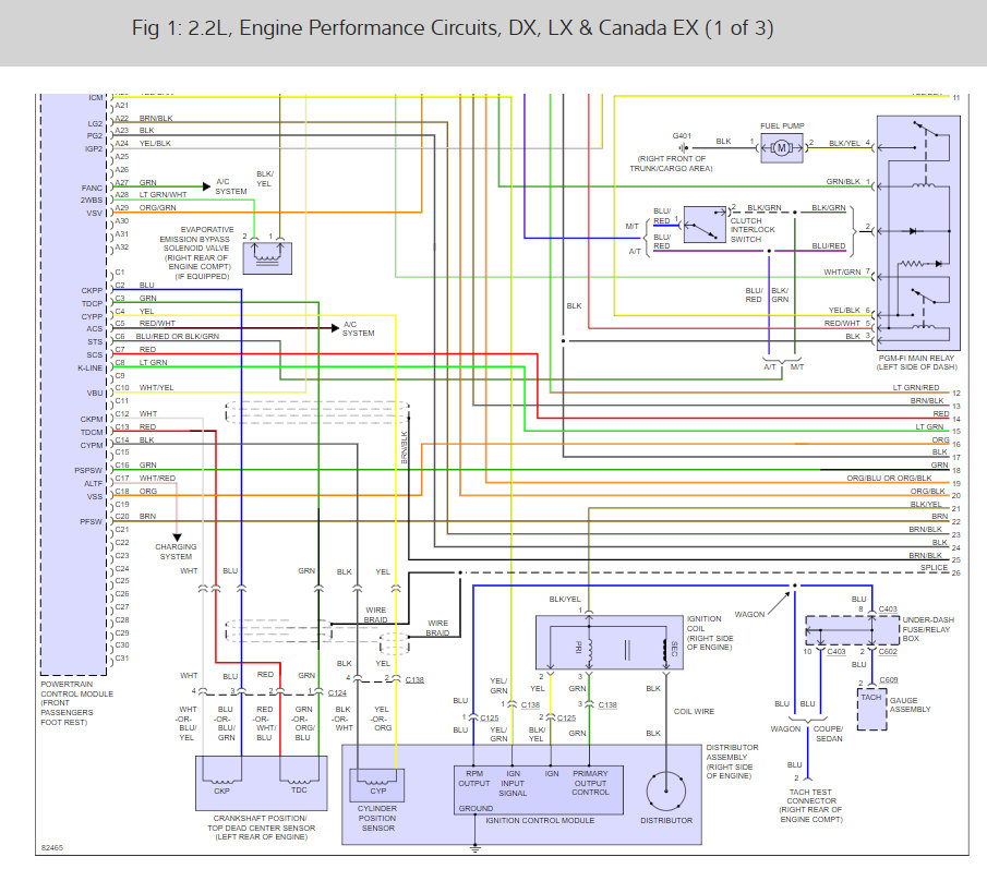

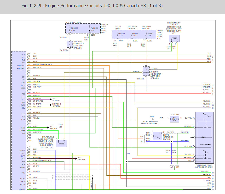

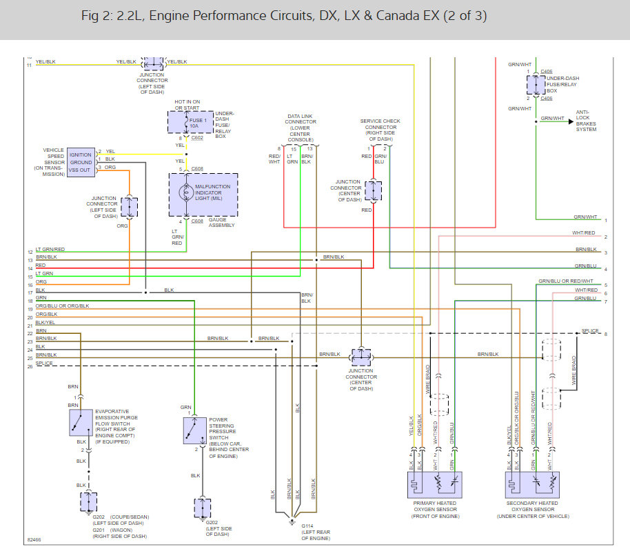

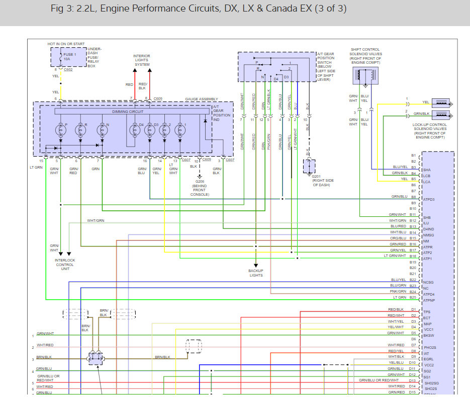

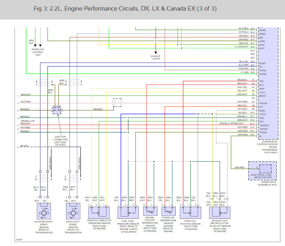

Before we say the PCM is bad lets check the wiring from the distributor to the PCM. Here is a guide to help us get started and the engine wiring diagrams so you can see how the system works. It sounds like you have one wire that is broken.

MIGUEL, we need to make sure the wiring is good. Please run the test above.

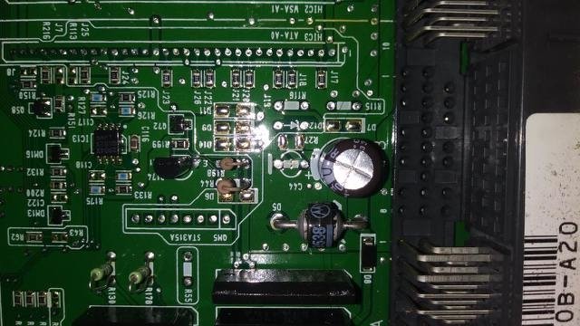

So, I am confused. I looked in under the ashtray that ob2 plug for the scan tool and follow the wires to the ECM/PCM also the wires from the distributor to the ECM/PCM they look fine. I did not want to take the plastic black stuff off because the wires look too good to me. But I want to be sure I am not holding the TCM because I could not find another computer on the other side or in the middle of the radio but on the passenger side under the feet cover. It was only one computer with three connections and I want to make sure if that is the ECM/PCM not the TCM on my car. But, yea I see that there is small corrosion. I am going to post a video and pictures of the computer. It is a 1996 computer it shows the date.

MIGUEL VARGAS2
  • 31 POSTS

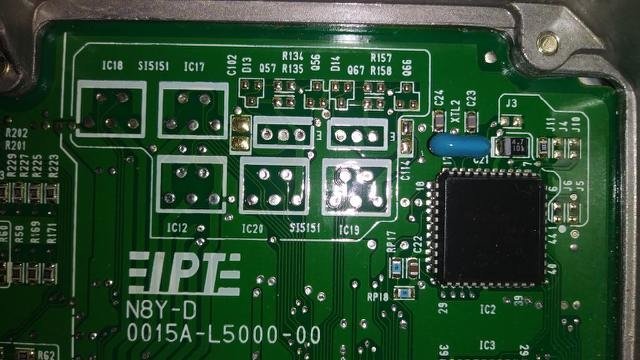

Here are the pictures:
Tuesday, September 18th, 2018 AT 7:23 PM
MIGUEL VARGAS2
  • 31 POSTS
I will upload the video tomorrow. But I have seen the ECM and as you can see the joints are corroded for such an old computer. I do not know if you can see that but the joints are like yellow and at first I thought it was normal copper joints, but it was not it was brown yellowish corrosion around all joints and its small brownish spots on corners of the plate chip itself on the back side. The picture shows the front.
Tuesday, September 18th, 2018 AT 7:46 PM
KEN L
  • MASTER CERTIFIED MECHANIC
  • 55,361 POSTS
Yep, that does not look good. Can you smell a burnt electrical odor? If so I would get a used PCM and plug it in to see what happens. These computer sit low in the car and are subject to moisture.
