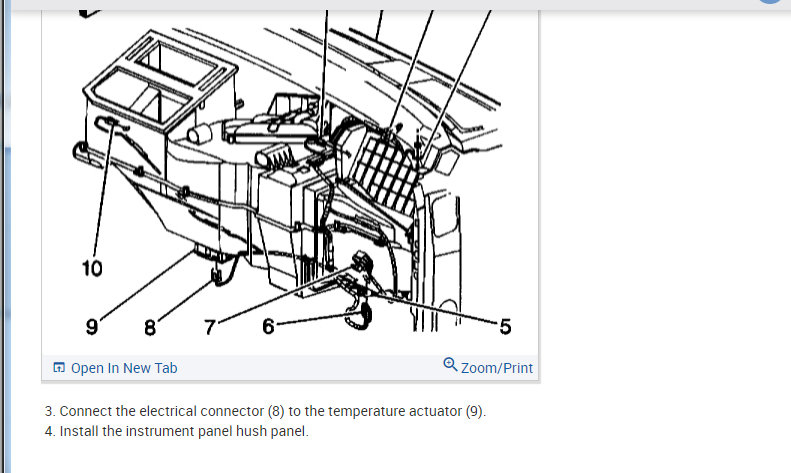

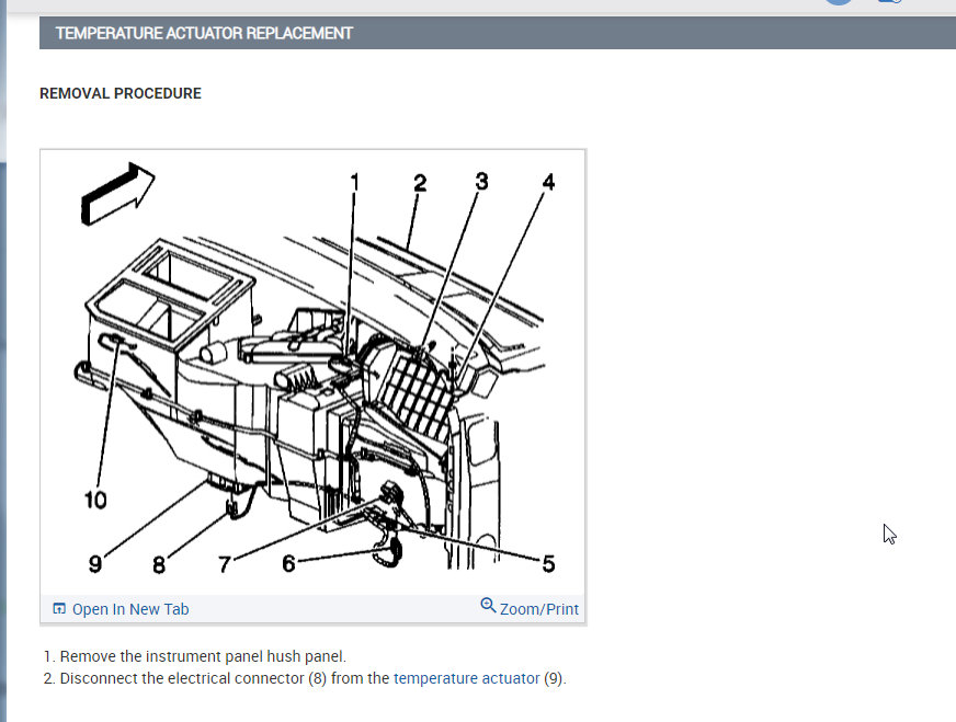

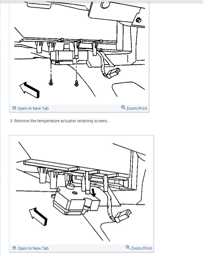

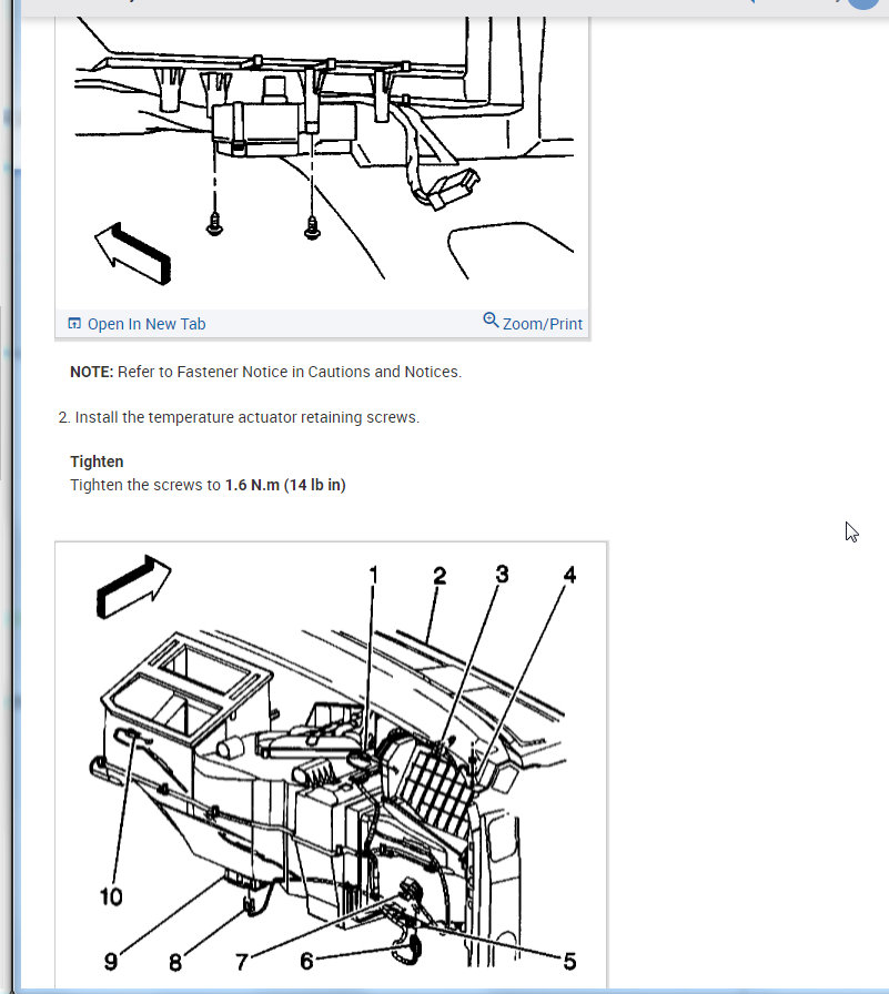

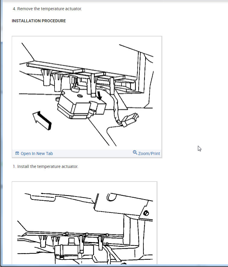

Driver side blows cold air while passenger side blows hot air when heat is on. I changed the blend door actuator for driver side still blows cold air. I even moved flap for blend door by hand to see if changing the position would make hot air come from driver side vents. But it did not. Still blows cold air I am at a loss for what it could be.

Drivers side of HVAC case under dash. Check out the diagrams (Below). Please let us know what you find.

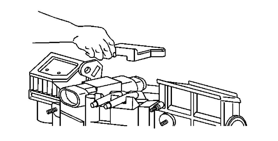

The blend door is in the EVAP case. Do not try this if you are scared. The dash is going to have to come out. That is a process all by itself. The AC system will have to be discharged as well. Remove the case from the firewall. Before we jump into that, lets check the operation of the actuator first. The door in question is controlled by an electric actuator that receives its signal from the AC control head. I do not have the information in front of me because it is Sunday and I am at home, but I think it is on top of the evaporator case and nearly impossible to get to. I will know for sure tomorrow when I get to work and can look at my computer there. This is way more likely than the actual door being stuck, although that can happen. Rats can build nests in there and block the door. The blower can suck a Sonic napkin out of the floor into the case and there is no telling where it will end up. But, before you go to that trouble, check the actuator. Try turning the temp control from hot to cold. (with the vehicle on) Do you hear any change at all? listen closely behind the glove box for anything. Start there.

ALWCURLZ
Sounds like my issue. Found out the problem was the "air door actuator", GM P/N 52474810. This part is about $100.00 at the dealer. Save some money and get it at O'Reilley's Auto Parts for $46.00 with a lifetime warranty! Also, you can check eBay and find them there. The actuator is underneath, near the center of the underside of your dash accessed from the passenger side. You will need to remove the three screws that hold that cover on and you will see it there.
https://images.2carpros.com/forum/automotive_pictures/332933_20090316_01524_1.jpg
Here is the post that turns the flap inside. You can manually move it if you are in a pinch where it is real cold and you need heat until the new part goes in.
https://images.2carpros.com/forum/automotive_pictures/332933_20090316_01526_1_1.jpg
https://images.2carpros.com/forum/automotive_pictures/332933_20090316_01526_1.jpg
Another picture here shows part of the problem. I believe the problem is that little blue gear which is attached to some type of potentiometer that has contacts exposed which gets grease in there. Also note another indication it was going to fail: Check the motor where it has markings on it. It says: "China" bet the whole unit was made there.
https://images.2carpros.com/forum/automotive_pictures/332933_20090316_01523_2_1.jpg
https://images.2carpros.com/forum/automotive_pictures/332933_20090316_01523_1.jpg
Here is the new one installed. This one I bought from O'Reilley, using the GM part number 52474810. This part also has a lifetime warranty! :)
https://images.2carpros.com/forum/automotive_pictures/332933_20090317_01530_1.jpg
Here is the new one: https://www.amazon.com/gp/product/B0012PQX3U/ref=as_li_qf_sp_asin_il_tl?ie=UTF8&tag=2carprcom-20&camp=1789&creative=9325&linkCode=as2&creativeASIN=B0012PQX3U&linkId=484be50463f80c7d6cf715954050752d Please let us know what happens.

This is correct that the blend door is most likely the issue. Below is the info from the manual on how to replace this. Please run through this material and let us know if you have other questions.
Here is a guide that will help with this as well:
Below is the info from the manual. Thanks
