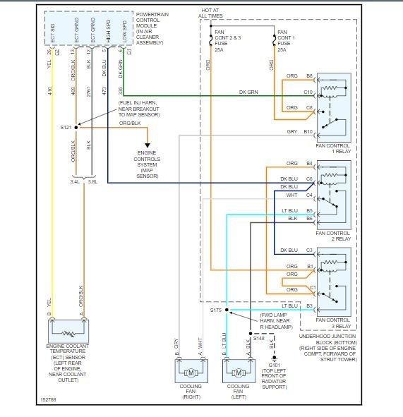

The car overheats in traffic.
Tuesday, June 11th, 2019 AT 8:42 AM
MECHANIC
52,796 POSTS
Good morning,

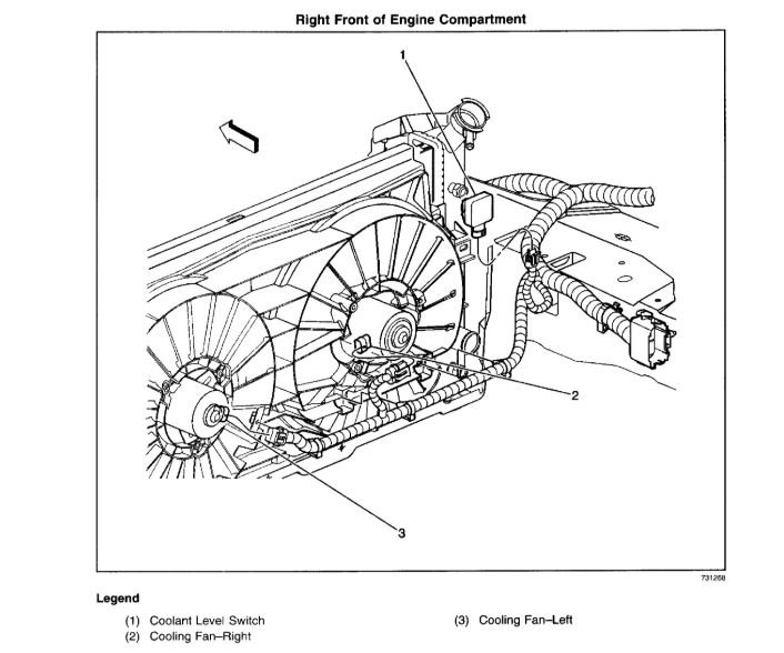

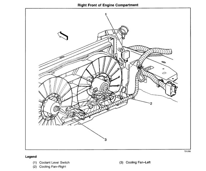

It sounds like the cooling fan is not working. That is what keeps the engine cool when you are not moving.
https://www.2carpros.com/articles/how-an-electric-cooling-fan-works
I attached a wiring diagram for you. Check the fuses listed for power on both sides.
