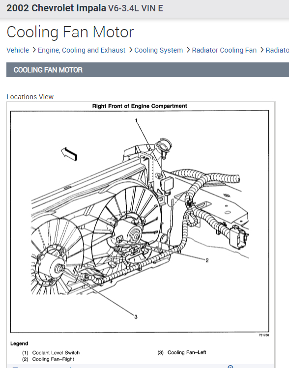

My car was overheating so I bought a thermostat for it. Still it was overheating, I then found out it was the radiator that was cracked so I bought a new one and installed it with a newer thermostat.I also found out the intake gasket was cracked so I got a new one put in. Ran the car for a while. Ac worked fine heat came on fine just like brand new. But the car still was overheating too fast. Im wondering if its da water pump?

It could be the water pump, but also it can be the cooling fans.
Do you know if they are coming on as they supposed to?

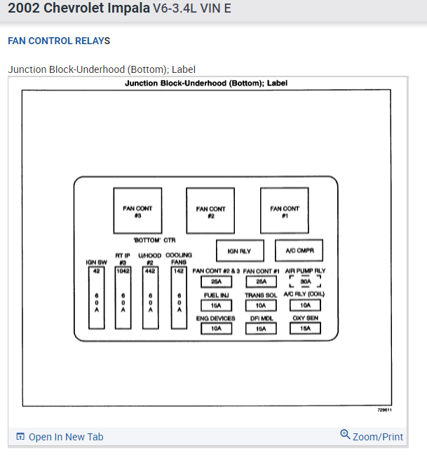

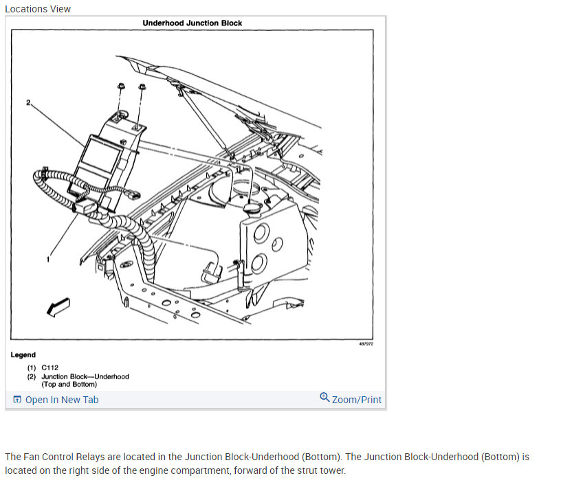

First you need to check the relays for the cooling fan and verify that they are good.
Here is an article on how to test relays:
If the relays are good then you will have to check to see if there is power going to the fan.
I have attached the diagrams for the relay and fan.
