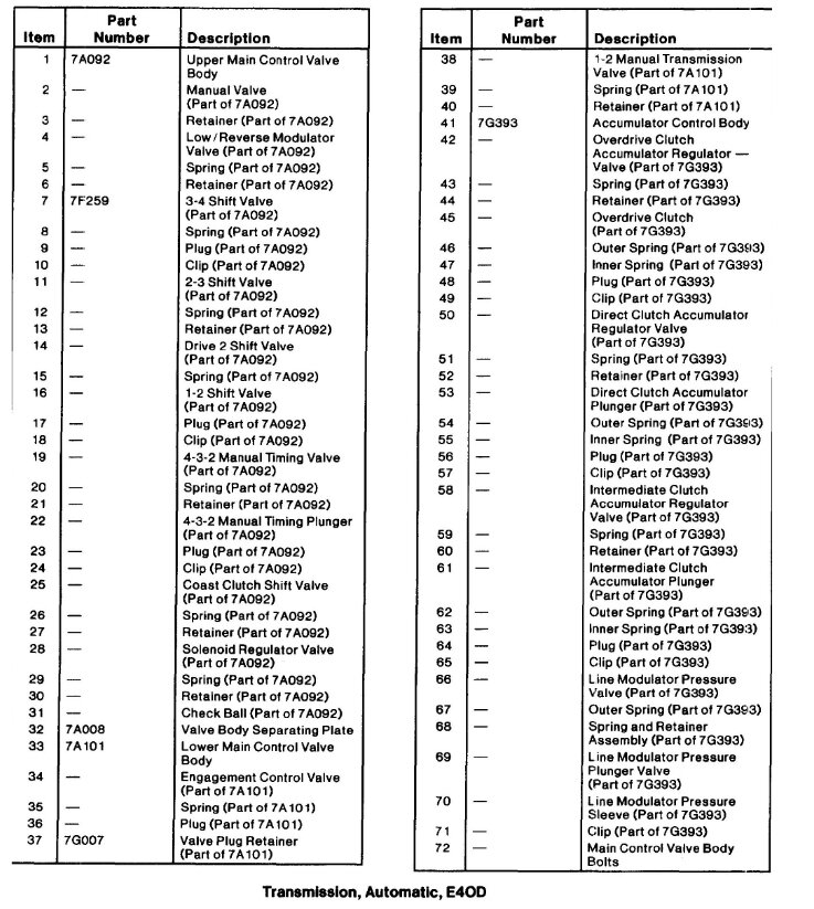

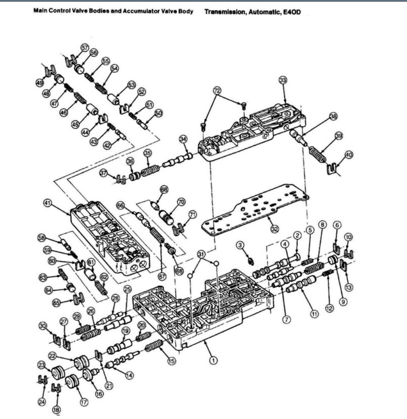

Overdrive flashes off. Transmission is slipping.
Monday, July 31st, 2023 AT 2:44 AM
KEN L
MASTER CERTIFIED MECHANIC
55,291 POSTS
It sounds like it needs to be rebuilt. I would check the fluid level first and maybe service the transmission to see if that helps.
Here are a few guides to help us fix the problem:
https://www.2carpros.com/articles/how-to-check-and-add-transmission-fluid
and
Also, we should run the codes because you might have a pressure regulating solenoid that is not working.
Check out the images (below). Please let us know how it goes
