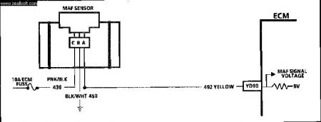

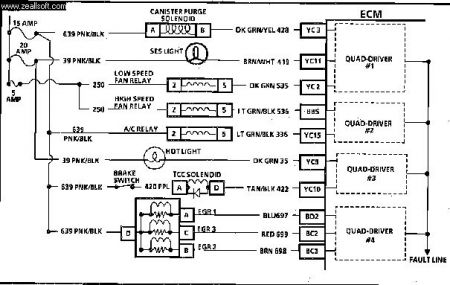

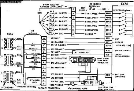

I have a 1988 Olds Regency with 100,000 miles on it engine size 3.6 liter fuel injected cusomer complained of drivabilty problem after 5 miles engine would stall and buck problem has gotten worse now only needs to run for about 2 minutes engine dies and surges codes in the computer are 26, 34, 42 have changed computer, fuel pump coil pac and module also crank sensor no change did not change the prom in computer seems to be loosing spark at the coils when problem accurs.

YES CHECK THE WIRING ITS WIRING PROBLEM
HERE IS WHAT I HAVE
https://www.2carpros.com/forum/automotive_pictures/99387_Image1_1.jpg
https://www.2carpros.com/forum/automotive_pictures/99387_Image_5.jpg
https://www.2carpros.com/forum/automotive_pictures/99387_Image11_1.jpg
