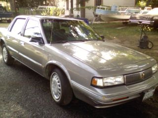

I hope I can find some help, I've replaced coils and given it a complete tune up. The car turns on fine and idles great, when in park, I hit the gas and the car revs up fine. When I try driving it, in any gear, it boggs out and doesnt respond well. The engine dosnt rev up like it would in park. Please help my next step is checking the fuel pressure, could that be the problem? Cause it revs up really good in park!

SMASHINC.
It was the cat, after much fustration and money I cut it off, problem solved thanks!
https://www.2carpros.com/forum/automotive_pictures/558308__1.jpg
