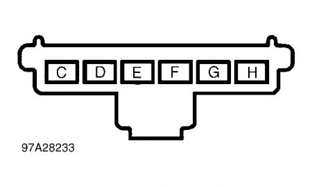

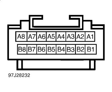

NOTE:
To identify Lamp Control Module (LCM) connector terminals, use illustrations.
https://www.2carpros.com/forum/automotive_pictures/99387_Graphic2_209.jpg
https://www.2carpros.com/forum/automotive_pictures/99387_Graphic3_100.jpg
LCM is located under left side of instrument panel.
