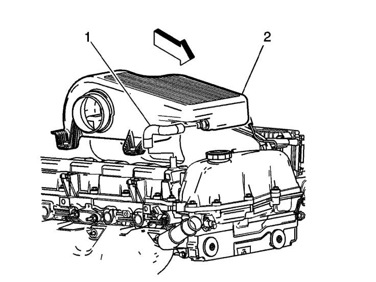

It has a PCV system which is a breather. Make sure the hoses and the inside of the air filter assembly are clean of all dirt and debris.
Positive Crankcase Ventilation Hose/Pipe/Tube Replacement
Removal Procedure
1. Disconnect the crankcase dirty air hose from the intake manifold.
2. Disconnect the crankcase dirty air hose from the positive crankcase ventilation (PCV) orifice tube.

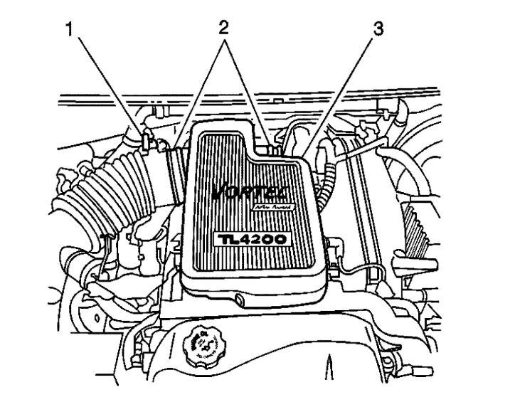

3. Loosen the throttle body clamps (2).
4. Disconnect the fuel pressure regulator vacuum supply hose from the air cleaner outlet resonator.
ImageOpen In New TabZoom/Print

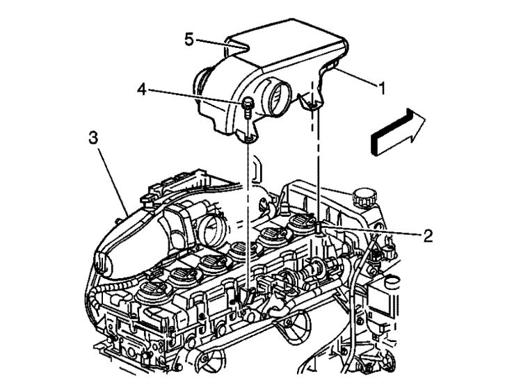

5. Remove the 2 resonator to engine bolts (4) from the air cleaner outlet resonator (5).
6. Lift up the front of the air cleaner outlet resonator (2).
7. Disconnect the crankcase clean air hose from the valve cover port.
8. Disconnect the crankcase clean air hose from the air cleaner outlet resonator (2).

I've taken this off and cleaned it and the throttle body before. There is always oil in the resonator. Never oil in the air filter though and the only PCV hose is the little elbow going into the valve cover.
