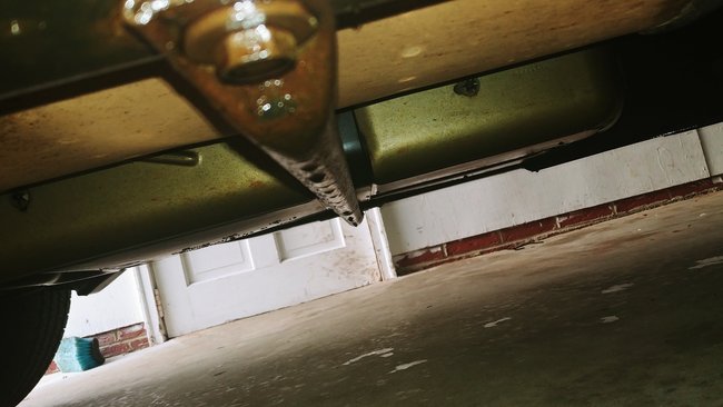

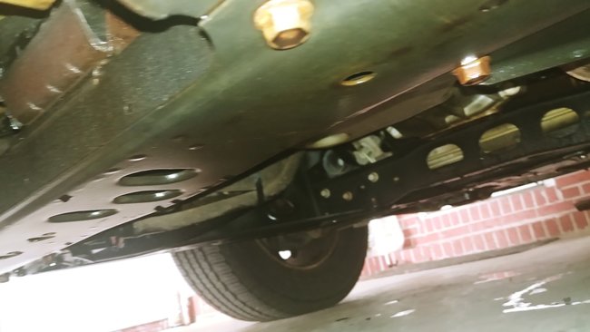

This car has a strange problem. When city driving, daily routines, and small trips, this car will not lose a drop of oil between oil changes. But, when driven on a 700 mile + trip, the entire bottom half of the car becomes soaked in about two quarts of oil (still a little bit on the stick after round trip). I can't see anything actively leaking, the pan gasket is dry and eventually all of this oil will cook off and it'll seem spotless again. I'm really racking my brain about it.

Can you post a picture of the bottom of the engine with the oil showing?

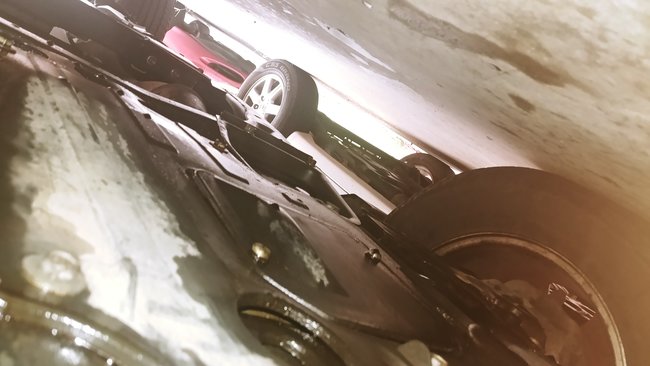

I tried. Basically droplets of oil everywhere. The AC compressor and alternator were soaked. Eventually all of this will cook off and it'll be like it never happened.

The leak looks like it could be from either the front oil seal on the crankshaft or the oil filter. Since it does it when you are on the highway, that is when the pressure is at the highest.
I would add an oil dye to the oil and then drive it a couple of days and use a LED light to spot the source of the leak.
Then we can discuss options.

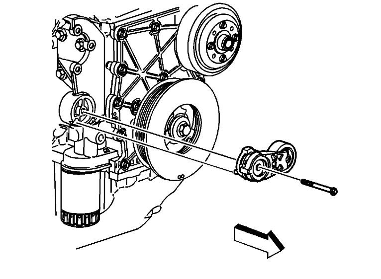

Just re-bumping this for discussion. Since the oil change 2,000 miles ago, it hasn't leaked any oil, to my knowledge. However, the new belt has begun to "glaze"? I guess from something leaking on it? Or maybe it's lack of tension. What I'm trying to say is that the belt no longer has the nice hard rubber outside and is now soft and stretchy, can almost pull it off the pulleys.
Thursday, November 7th, 2019 AT 2:07 PM
Change the belt and tensioner.

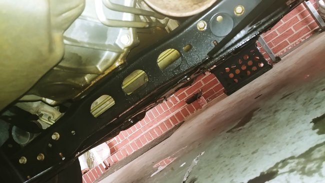

I've had dye in this car for 2 oil changes now. The front seal should be glowing under the UV light right? There is only oil on the front frame, the skid plate, and a drop on the bottom of the oil filter. No oil around the oil filter base plate. The pan gasket area is dry.

Okay, is the oil on the frame have oil dye in it or is it leftover from before?
Sunday, November 24th, 2019 AT 4:30 PM
CANNON1349
  • 908 POSTS
Oil on the frame does have the green tint to it with UV Light. Yes
Sunday, November 24th, 2019 AT 4:38 PM
Then it is coming out of the engine.

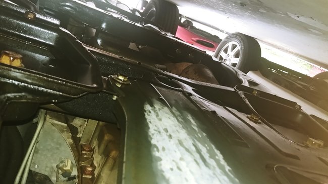

There's a slight valve cover leak up top, but no dye came out of it. Nothing down the exhaust, and certainly not out of the cap. There's a puddle caught in the skid plate, took that out. And a green bit on the head of the drain plug put not the seal around it.
Sunday, November 24th, 2019 AT 4:41 PM
It has to be leaking from somewhere on the motor.

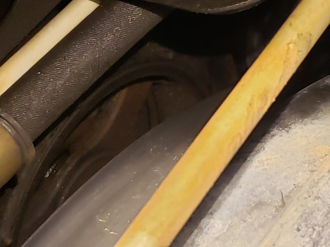

I attached here the best picture of the crank seal I can get. It looks wet to me. But not showing up florescent green from the dye.
Monday, November 25th, 2019 AT 4:09 PM
Yes, that looks like it is seeping but has not actually become a leak.
