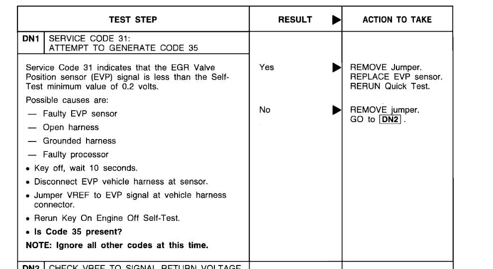

They can't do emissions test. Got trouble codes 11 and 31 the other day, trying to retest, using different jumper wire- can't find the one I made.
It says low voltage to that sensor and I replace the sensor about 14 months ago. AutoZone guys said that could be the problem and it could be malfunctioning.

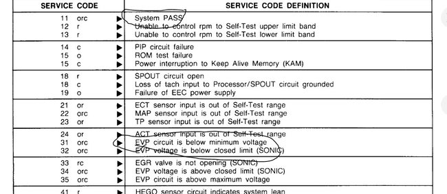

Good morning,
Code 11 means the system passed.
Which sensor did you replace?
Did the 31 return? Even if it did, that is not your issue. Low power can come from clogged catalytic converter or low fuel pressure. Have you checked either one of these? Check the EGR valve and see if it is stuck open. Otherwise, it is a voltage issue in the system.

I haven't read all the links that you sent yet. After I sent the message last night I drove, I had to leave and my trouble light is staying on constantly, that's probably why the jumper didn't work. It's been several days since the first check information being number 11 and 31 trouble codes. #31 is EGR valve sensor receiving low voltage and that was the code explanation and since I just replaced it over a year ago I wondered if there was a low voltage issue in my system leading up to that sensor. (That sensor is under lifetime warranty but they cannot find it in the computer under my name, so I've been looking for the receipt for 3 days). Now I have another problem and I need to send you what I can find out about that, the check engine light is constant, no blinking when I drive, no blinking with a jumper.

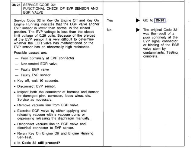

Okay, I would check the EGR valve and make sure the passages are clear. Look at the valve itself and make sure it moves freely and closes all the way.
Do that check and let me know what you find.

The OBD-1 test said 31 - low voltage change sensor - I did.
But the check engine light came on before I changed sensor and hasn't gone out.
It appears to be from an unrelated problem.
