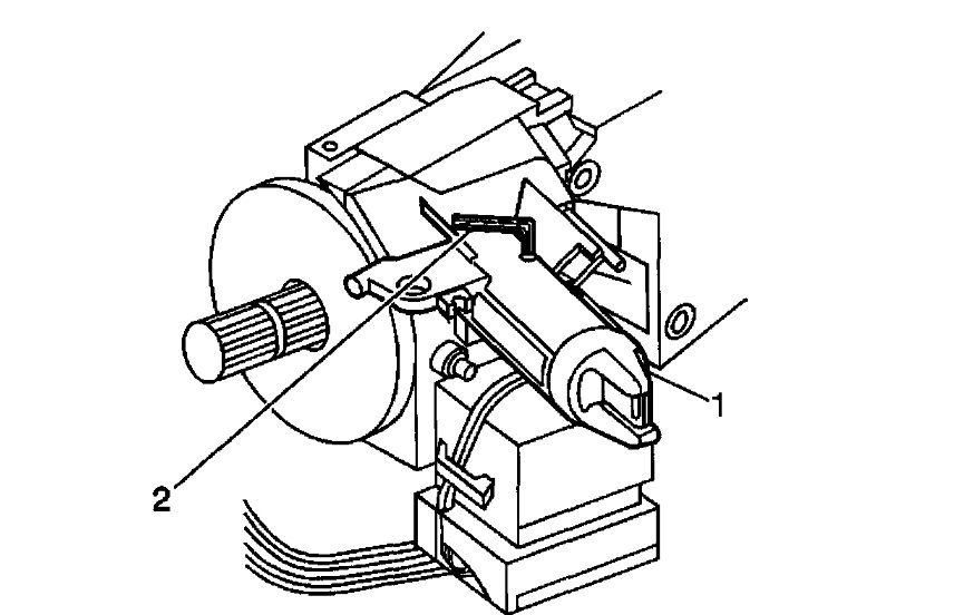

I have the car listed above (GT model) that I just bought and I noticed the key does not click back all the way. Now the battery is drained and it will not start. No wonder the previous owner had a new battery installed. Anyway, how do I fix this? I appreciate any input. Thank you!

Your anti theft or security system reads the key, the key contains a password to allow the PCM to turn on all the systems for the car to run.
1. Disconnect the negative battery cable from the battery.
2. Remove the upper and lower steering column trim covers.
3. Disconnect the ignition lock cylinder electrical connector from the wiring harness on the column.
4. Put the key in the steering column lock cylinder set (1).
5. Turn the key to the start position.
6. Install a 1/16 alien wrench (2) into the hole on top of the lock module assembly to release the steering column lock cylinder set retaining pin.
7. Turn the steering column lock cylinder set (1) into the run position.
8. Pull the steering column lock cylinder set (1) out from the lock module assembly.
9. Remove the key from the steering column lock cylinder set (1).
Installation Procedure
imageZoom/Print
1. Insert the key into the steering column lock cylinder set (1).
2. Line up the locking tab (2) and the positioning tab (3) of the steering column lock cylinder set with the locking tab slot (5) and the positioning tab slot (4) in the lock module assembly (6).
3. Push the steering column lock cylinder set (1) into the lock module assembly (6).
4. Rotate the steering column lock cylinder set (1) in the lock module assembly (6) into all positions.
5. Connect the ignition lock cylinder electrical connector to the wiring harness on the column.
6. Install the upper and lower steering column trim covers. Connect the negative battery cable to the battery.
Friday, April 20th, 2018 AT 7:13 PM

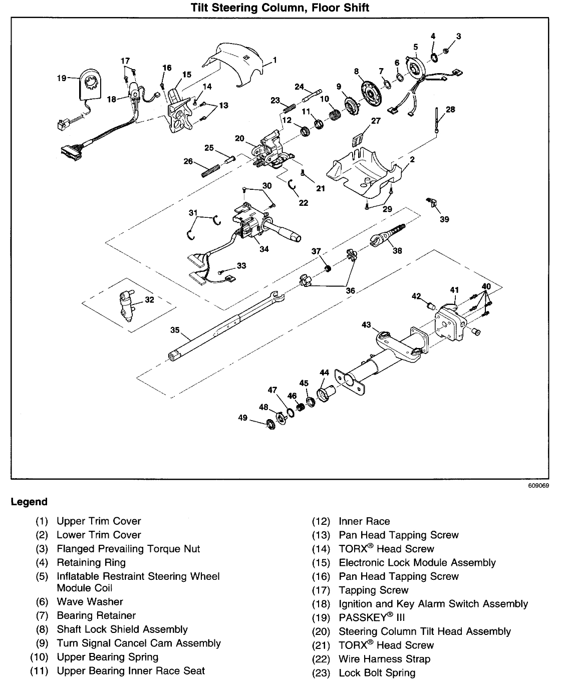

No it is the same as the old lock cylinder. It still does not go back to the off position. When I open the door it still dings. And if I pull the key hard enough it will come out.
Sunday, April 22nd, 2018 AT 7:58 PM
STEVE W.
  • 15,697 POSTS
Okay, it sounds like either the steering wheel lock bar (item 24) or it is gearing is not in proper position. That could be the result of wear or someone replacing the actual ignition switch without placing the key cylinder and pin in the proper place but the more likely option is that it has been damaged by someone trying to move the wheel with the lock in place. That can bend the pin or break it and cause it to jam inside the column. To get to that part you need to strip the top of the column down by removing the steering wheel and then the ignition and key cylinder, then you can get to the parts. 99% of the time it is faster and cheaper to just swap out the column if the internals are broken. Or get a column to tear down for parts.
