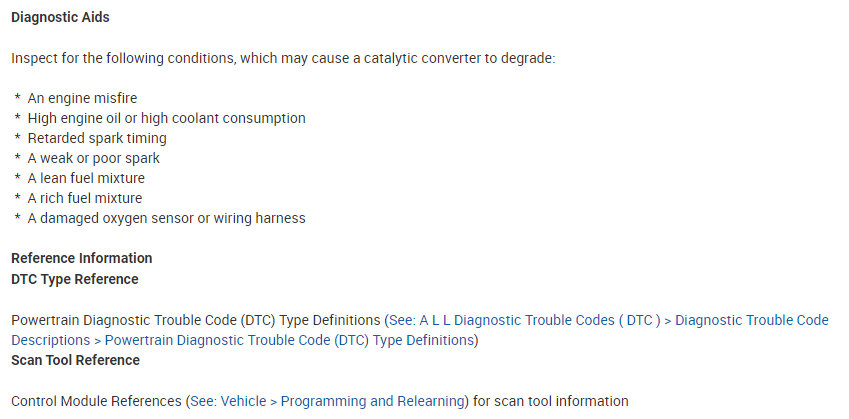

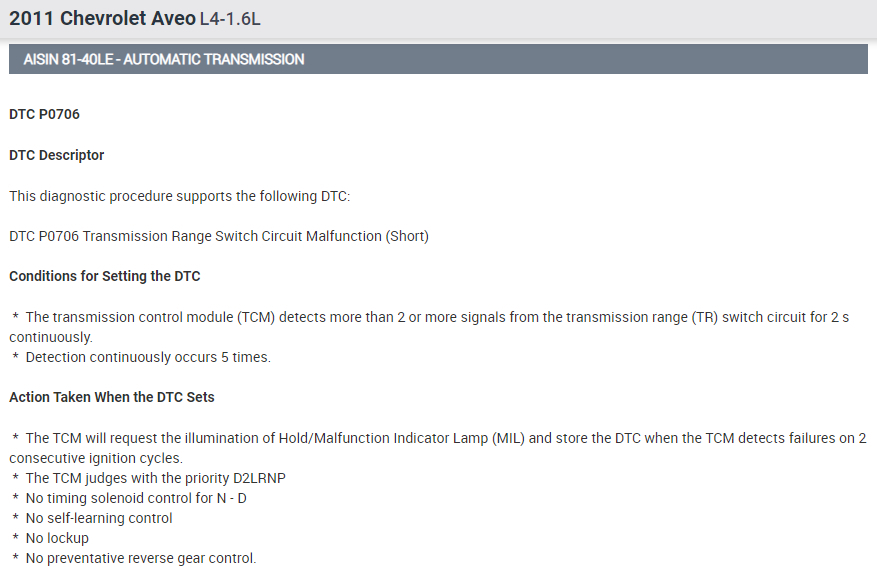

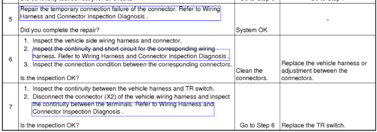

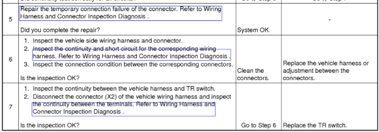

The scanner kicked out these two codes: P0420 and P0706. Any help will be much appreciated.
Thursday, March 4th, 2021 AT 12:01 PM
DANNY L
  • 5,648 POSTS
Hello again.

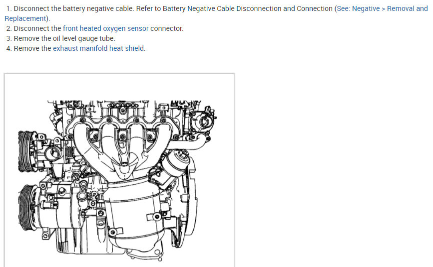

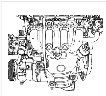

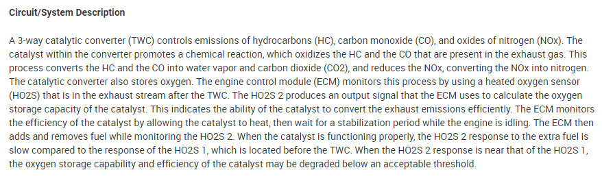

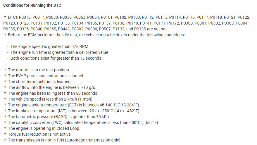

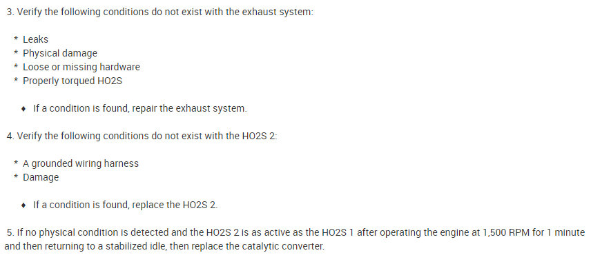

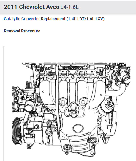

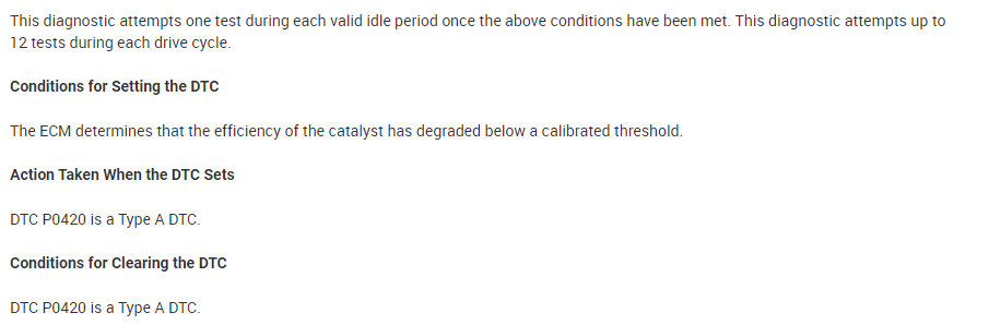

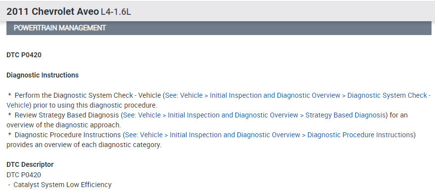

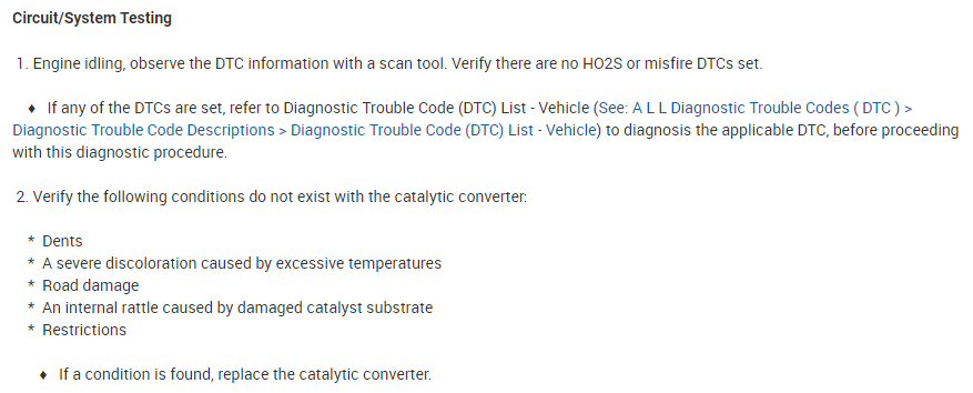

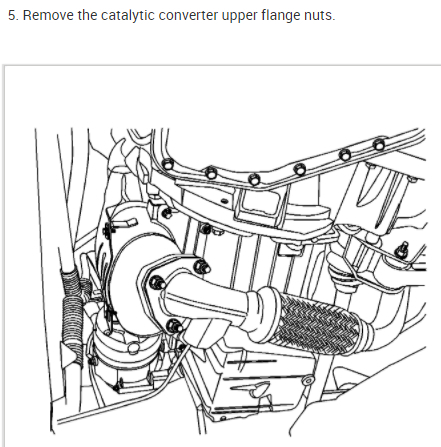

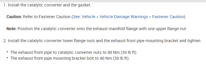

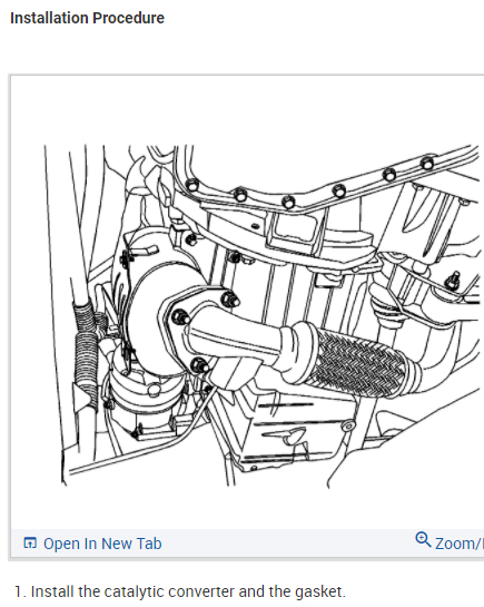

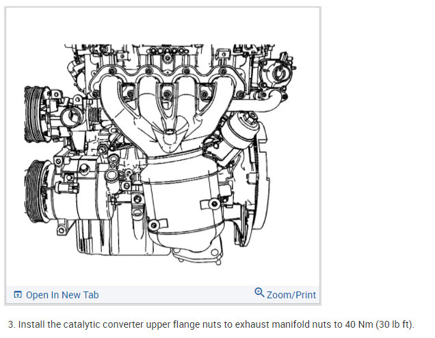

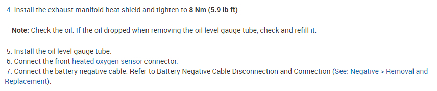

The code P0420 is for catalytic converter inefficiency. Here are a few tutorials for you to view showing testing and replacement:
https://www.2carpros.com/articles/catalytic-converter-replacement

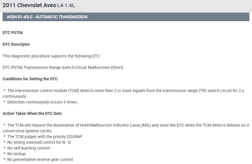

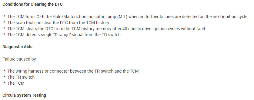

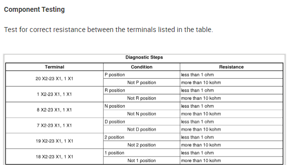

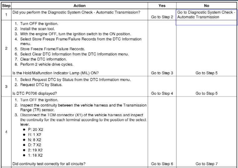

The code P0706 is transmission related. I've attached picture diagnostic code steps below for that transmission code as well as steps on how to remove and replace the catalytic converter. Hope this helps and let us know what you find. Keep us updated and thanks again for using 2CarPros.

Hello again.

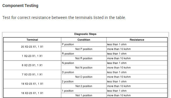

I would perform the diagnostic steps to rule out the range selector-(neutral safety switch) before just changing the TCM. Let us know what you find and keep us updated. Thanks again for using 2CarPros.

DANNY CLAY
  • 9 POSTS
The NSS is fine. Car runs and gears work fine. Problem is when driving it seems to stall but engine is still running. It just has no throttle response. You can shut it off and wait about 15 minutes and it will start and run about 5 mile or so and repeat same stall again. I have reset the ECM and it runs okay a few days then starts same thing again. It's starting to get on my time to get rid of it list.

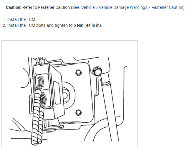

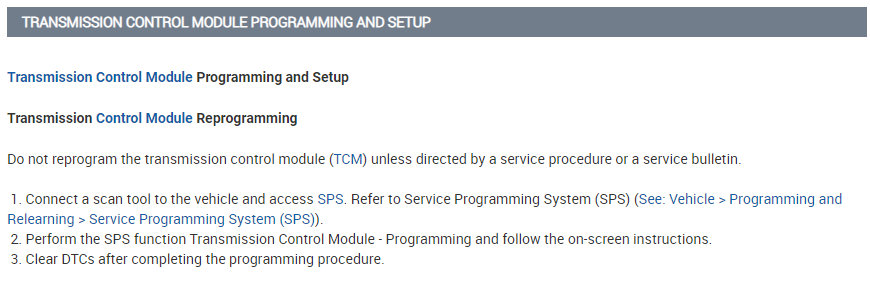

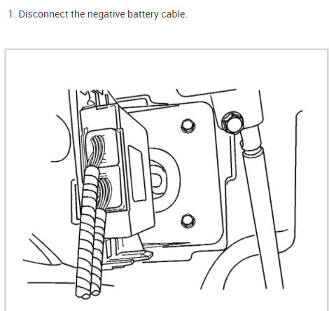

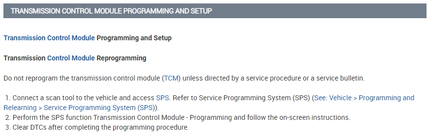

DANNY L
  • 5,648 POSTS

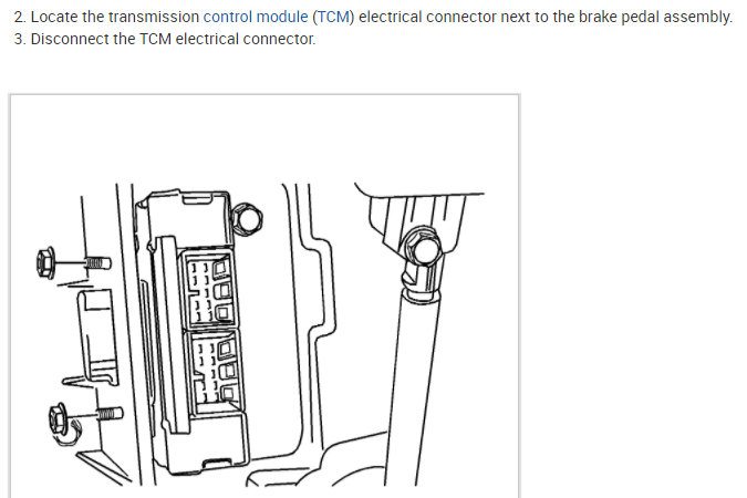

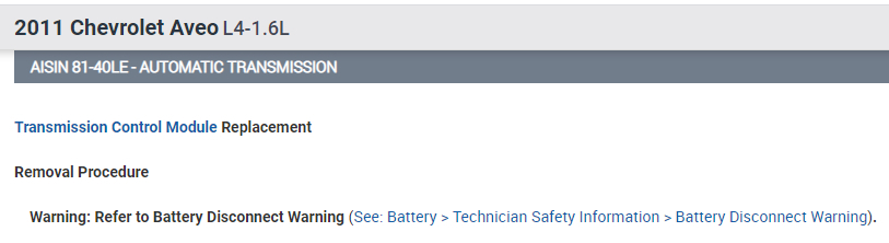

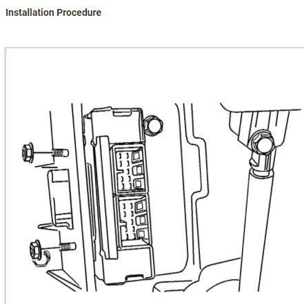

Hello again.
I've attached picture steps below on how to replace the TCM- transmission control module on your car. After replacement a professional scan tool will need to be used to relearn-calibrate the new module. Let us know if you have any further questions on this issue. Hope this helps and thanks again for using 2CarPros.
Danny-
Saturday, March 6th, 2021 AT 3:46 PM
DANNY CLAY
  • 9 POSTS
Replaced it but still have same problem. Guess it is something no one can solve.
