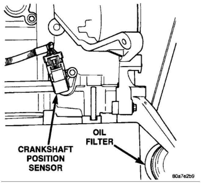

Car at time will not start. Everything is fine then it will just start after a while or it will just quit while driving down the road. I let it sit for five to ten minutes and it starts. Also, when it starts and runs I hear a noise or relay under glove box. When car does not start the sound under glove box is gone.

Hey LOU,
This sounds like a classic crank angle sensor problem, here is a guide that will show you what you are in for when changing the sensor out.
Diagram below.
Please let us know happens so it will help others.
Best, Ken

This is something that my son brought to my attention it's been raining here for the last 2 days car would not start can smell gas when trying to start it but will not start sun is out today go out to try the car turn the key fired right up he said it seems everytime it rains I have this problem

Hey Lou,
If you smell gas then the crank angle sensor is working, Im starting to lean toward the ignition coil pack. Have you changed the spark plugs lately?
