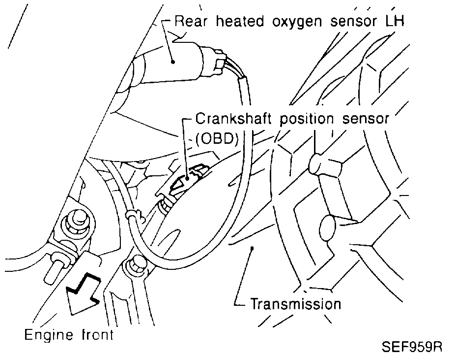

Engine will not start, cranks, have fuel pressure 52 psi, have good spark, replaced distributor. I believe it is a security problem. Horn and lights go off last few months for no reason (have tried all resets I can find from web) or think maybe crank sensor? Help please.

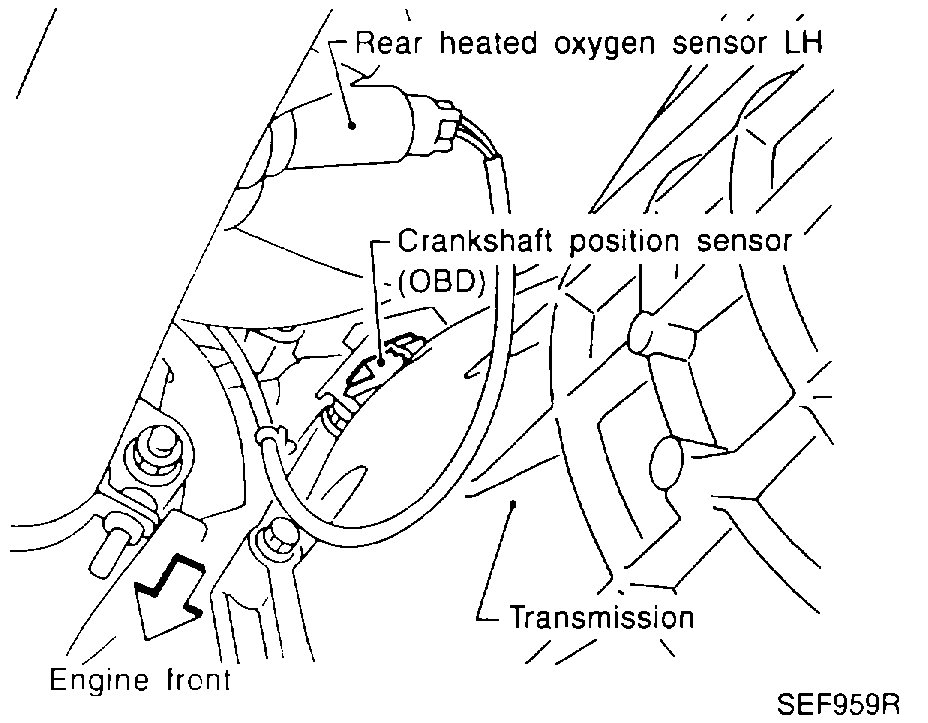

As far as the no spark, if it won't start with starting fluid, the crank sensor is my first guess. No need for a node light.
Here are directions for testing the sensor. Basically, you are just checking for resistance. Also, I bet if you pull a plug, it will be wet.
CRANKSHAFT POSITION SENSOR
COMPONENT INSPECTION
1. Disconnect crankshaft position sensor (OBD) harness connector.
2. Loosen the fixing bolt of the sensor.
3. Remove the sensor.
Picture 1
4. Visually check the sensor for chipping.
Picture 2
5. Check resistance as shown in the figure.
Resistance: Approximately 432 - 528 Ohms [at 25°C (77°F)]
If NG, replace crankshaft position sensor (OBD).

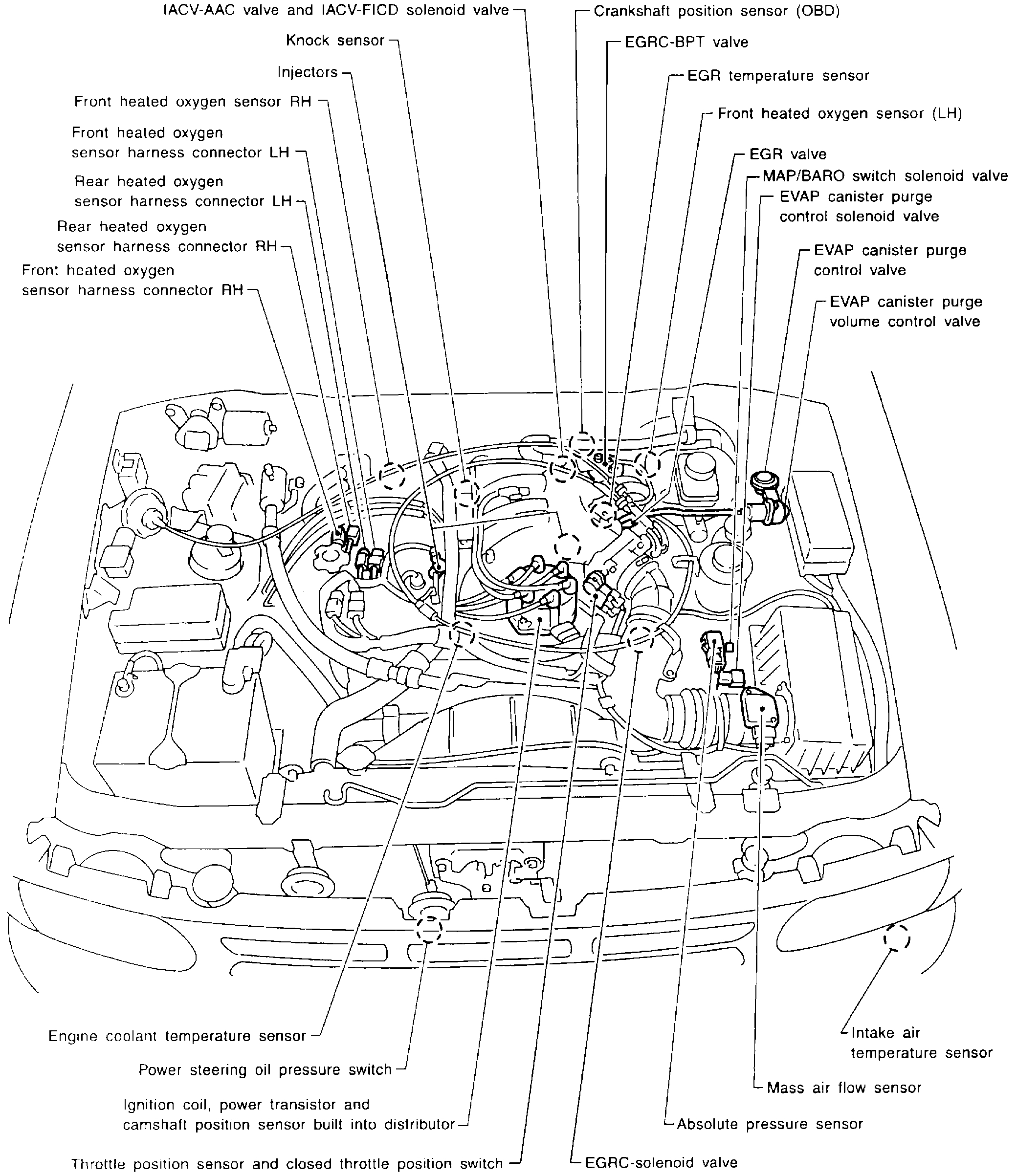

Also, pictures 3 and 4 are for location of the sensor.
Let me know what you find.
