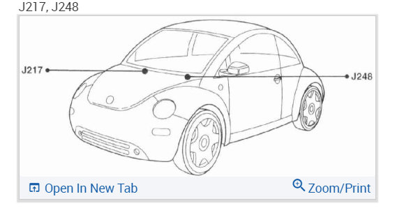

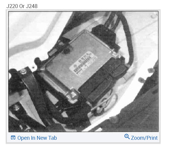

Is the pcm behind the gauges or on the passenger side?
Friday, July 19th, 2019 AT 5:50 PM
KEN L
  • MASTER CERTIFIED MECHANIC
  • 55,481 POSTS
Here is the location of the PCM. Check out the diagrams (below). Please let us know what happens.
