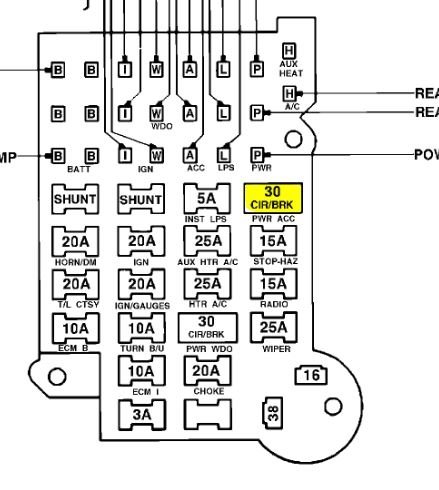

No start
JMOFFET
  • 1985 CHEVROLET TRUCK
  • 5.0L
  • V8
  • 2WD
  • 200,000 MILES
Starter does nothing. No dash lights or sounds whatsoever.
Check battery and starter while removed: both good. I have not tried to use my multi-meter yet.
What next please?

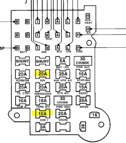

If nothing electrical works, confirm there is a good ground from the battery to the engine block and body, and confirm the positive cable is in good condition and tight on the starter.
Next, confirm that the fuses in pic 1 are good and there is power to the circuit. Check to confirm the 30 amp circuit breaker is good in picture 2 and there is power in that circuit.
