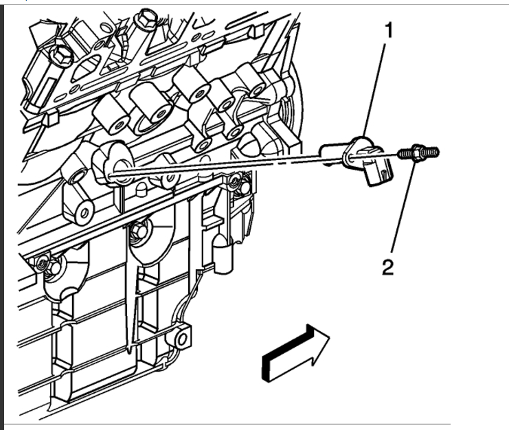

Does not start. Does not have spark. I connected the scanner and I got two codes p0727 speed sensor input no signal.

It sounds like you have a crankshaft angle sensor that has gone out. here is a guide to show you what you are in for when changing the sensor:
and
and you will need to jack the car up.
Here is a where the sensor is in your car (below).
Image (Click to make bigger)
