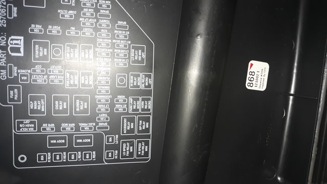

DTC? Scanner said refer to manufacturers guide which it then told me it was a communication error between ECM and TCM. Also when I turn the key all the way to the on position and check under the hood right to the left of the electronic throttle body there is a noise coming from I think it's called intake manifold Runner control it's like it's cycling every fifteen to thirty seconds I don't believe it was doing this before. It seems like it's opening and closing the flappers in the throttle body. Does this have anything to do with my problems. Thank you for taking time out to help me with this issue I'm trying to help a friend of mine with this car I have nothing but problems with it and I am not electronically strong-minded so to speak explaining this feel free to dumb it down for me LOL thanks again. Side note: I also checked fuses under the hood an interesting Lee enough I'm not getting any power to fuses pertaining to Headlights seems odd I will try or where I to get a picture and circle fuses that my test light does not light up on when the key is in the on position.
Sunday, April 14th, 2019 AT 8:34 PM
SIZENBACH
  • 5 POSTS

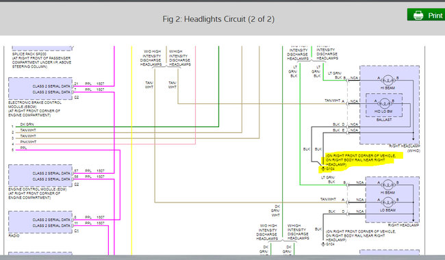

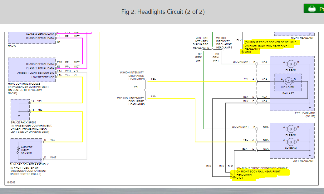

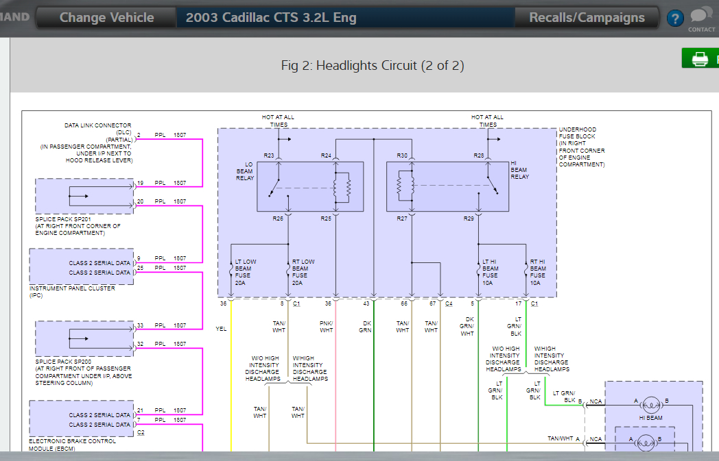

The fuses LT hi beam and the corresponding three underneath it all have no power. Fuses are good. Any idea?
Sunday, April 14th, 2019 AT 8:38 PM
SCGRANTURISMO
  • 4,897 POSTS
Hello again,

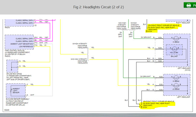

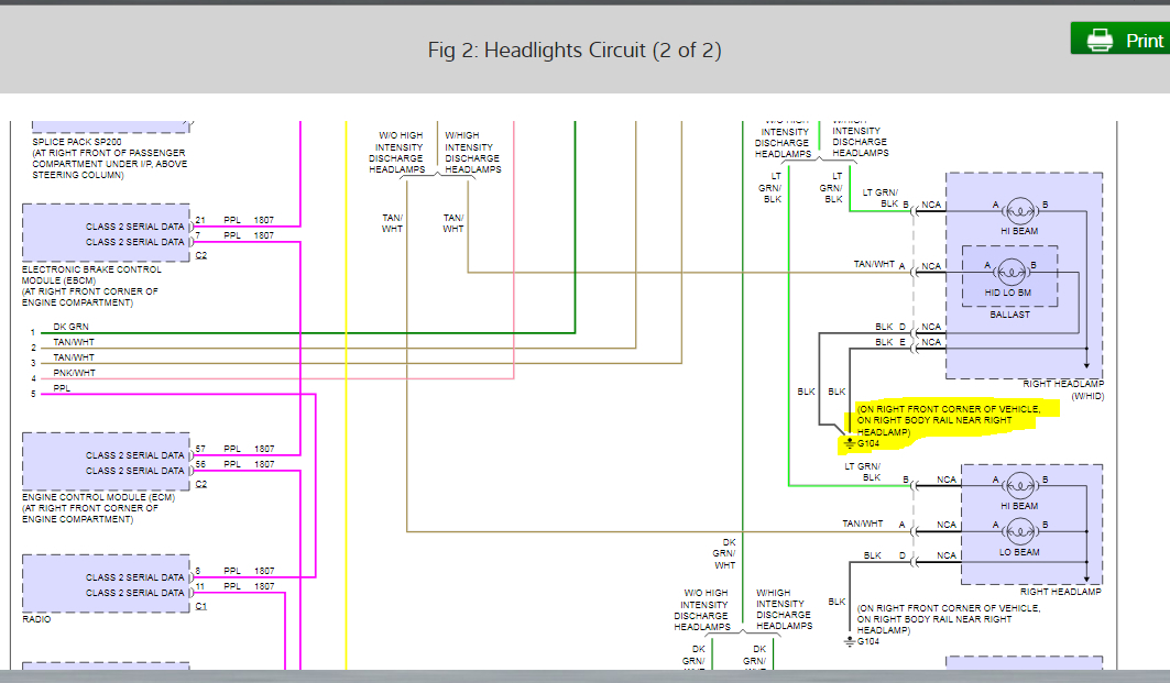

Check Ground #104 on the right front corner of the vehicle. I have included a wiring diagram for the Headlamp Circuit in the diagrams down below. Check the ground and the ground wire for unwanted corrosion. Make sure that the ground is clean, corrosion free, tight, and making a good metal to metal contact. Get back to us with what you find out please.
Thanks,
Alex
2CarPros
