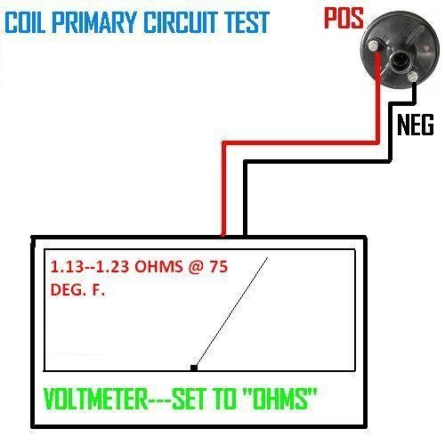

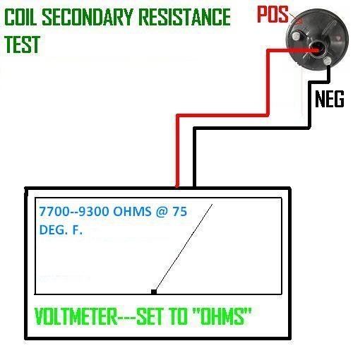

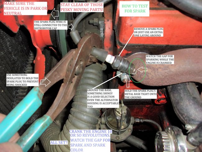

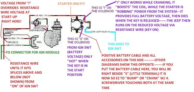

I have 12 volts on the wire going to the positive side of the coil. But no spark getting to the plugs. Coil type accel 8140.
Monday, March 25th, 2019 AT 5:22 PM
26 Replies
CJ MEDEVAC
  • 11,004 POSTS
Your 1979 Jeep CJ, in my opinion, is the best year that AMC made, pretty much everything was perfected and the computer stuff had not been incorporated in yet.
Your coil could be dead, but that is the last thing I would guess.

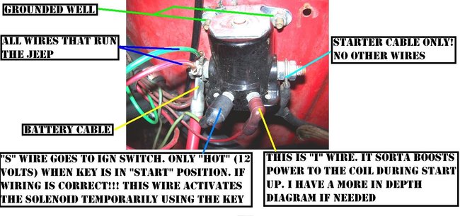

Pictures 1 and 2 are the way to test (these are the values for the original 1979 Jeep CJ Motorcraft system)
The Accel values are "1.2 ohms" and "89 k ohms"

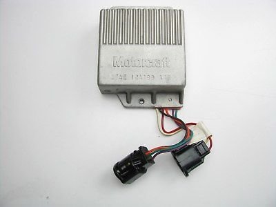

I have a few more possibilities.
This is the one I lean towards the most.
The ignition module.
Is it's body grounded well?
Not that easy?
Let's take it off,
The service manual prescribes grabbing the wires on either side of the connectors and giving them a firm pull. Digging at the connector locks will do no more than break them off, then you'll have to use wire ties to keep them together.
Take it to an auto parts store (my pics are in Advance Auto Parts)
Have it tested five or so times in a row, if it fails at all, replace it.
Yep,
I've seen several new ones be failures too.
If you get another one, test it while you are there, otherwise you will go insane wondering why the whole Jeep could be at fault, after tearing everything down.
Wow, it was a bad "New" module the whole time.
Your module will have blue plastic around the wires as they exit the modules. Other colors are for other vehicles.

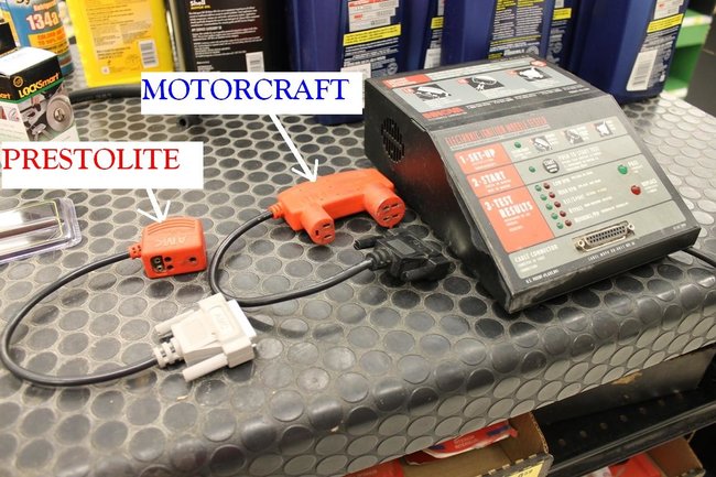

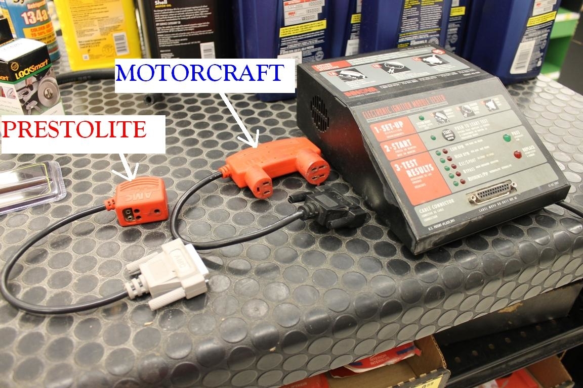

Went to get the ECM tested. All the "experts" say there is no way to test them. You just have to go through process of elimination.
Tuesday, March 26th, 2019 AT 11:30 AM
CJ MEDEVAC
  • 11,004 POSTS

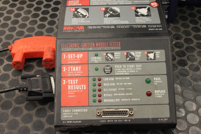

Process of elimination:
Eliminate the problem at hand.
Eliminate the employees at your auto store. Go elsewhere.
This picture is the tester at Advance Auto Parts.
You can see the pigtail beside it where the two Motorcraft connections plug in.
The other pigtail is for testing the Prestolite (1978 and earlier).
Other stores have similar testers.

I called advanced auto orients and some mechanic shops. Same answer all around.
Tuesday, March 26th, 2019 AT 2:30 PM

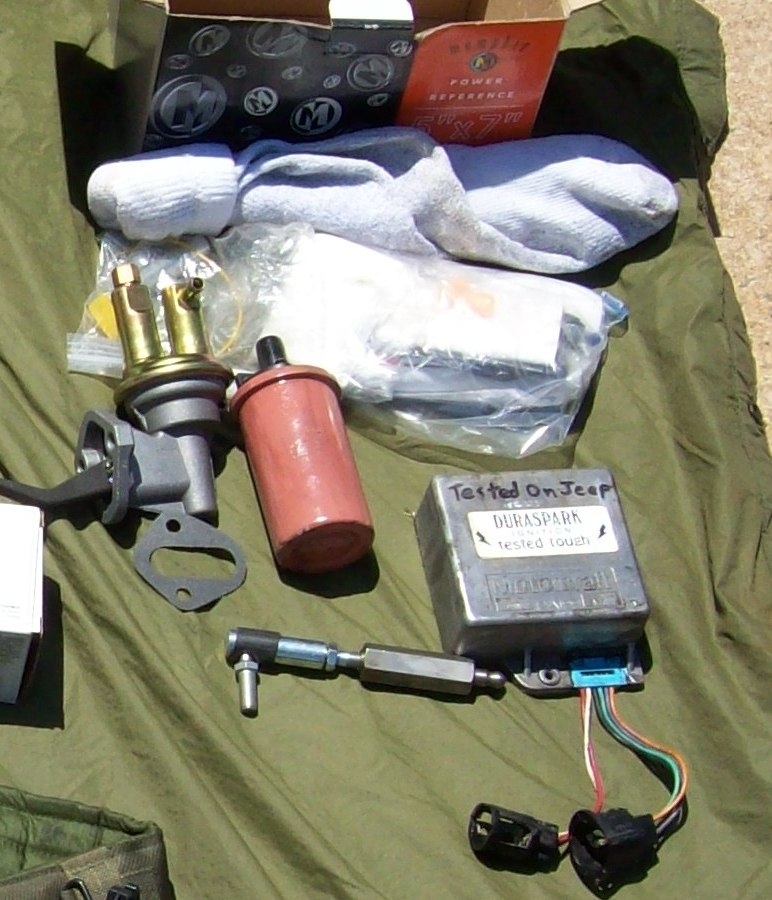

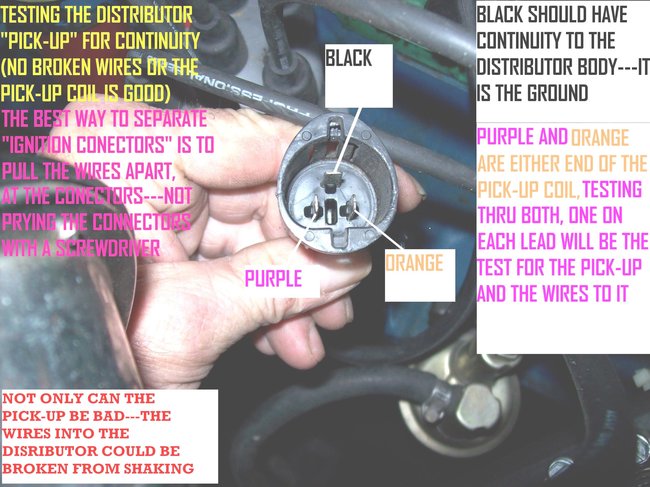

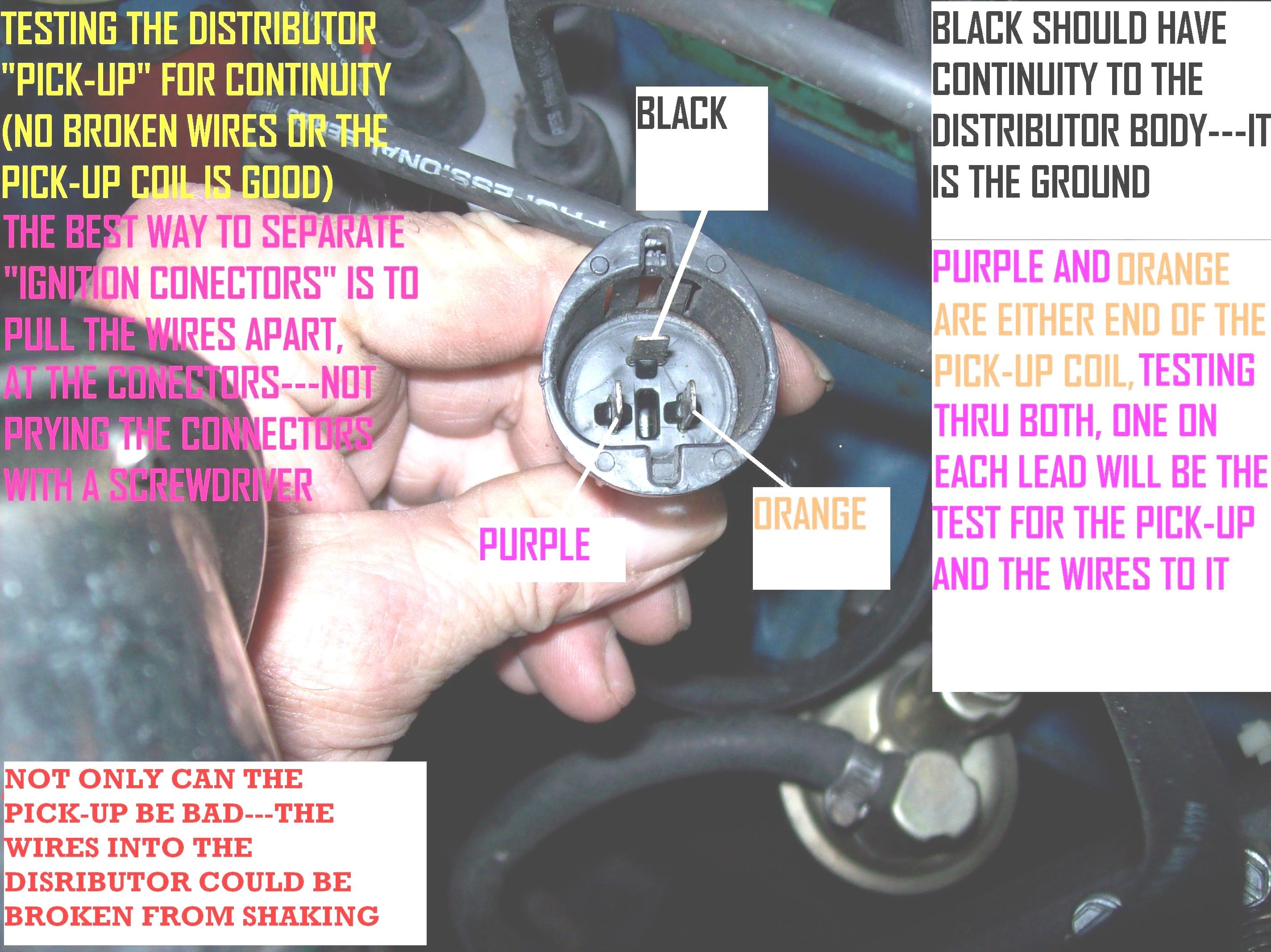

Maybe this?
This is the connector half to the distributor.
Checking for continuity from the "crossways" terminal to the distributor body. One lead on the pin, the other on the distributor body.

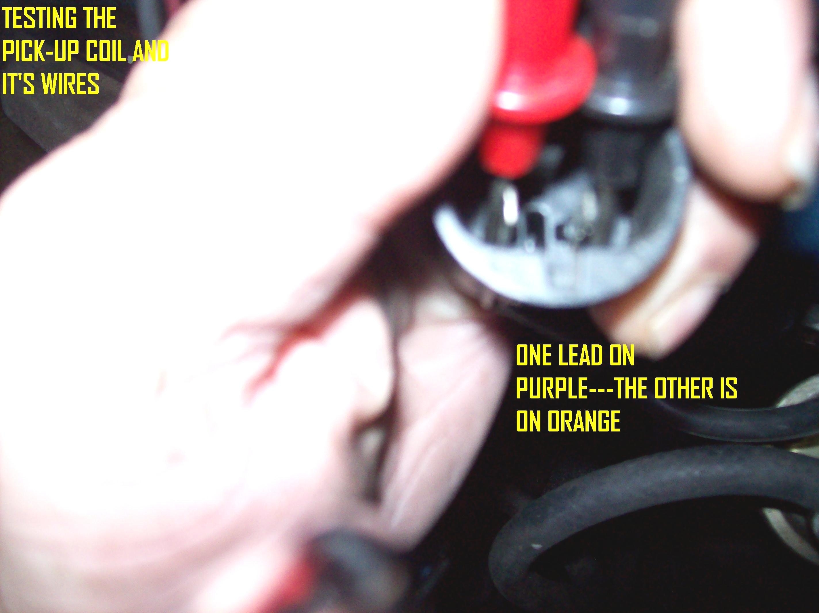

Now check the "side by side" pins (one lead on each pin) for continuity. These go through the pickup coil.

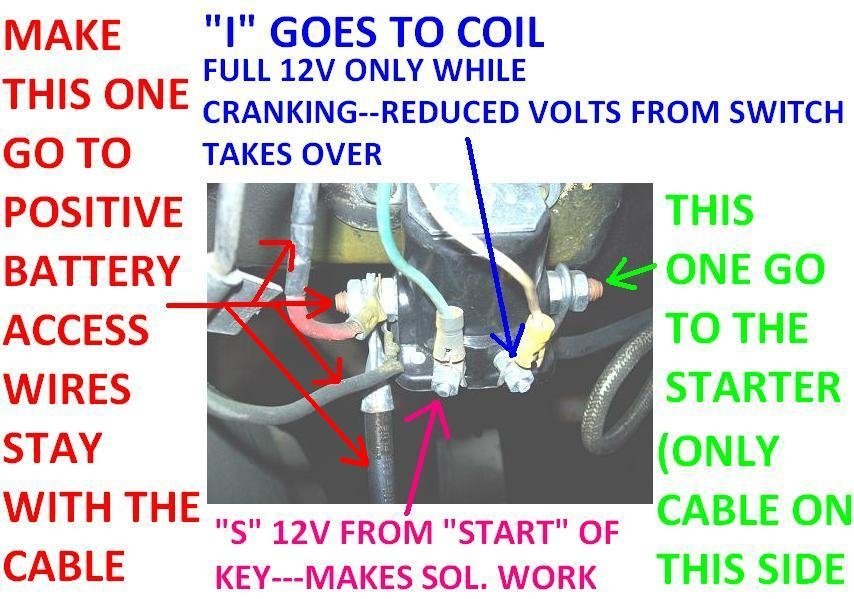

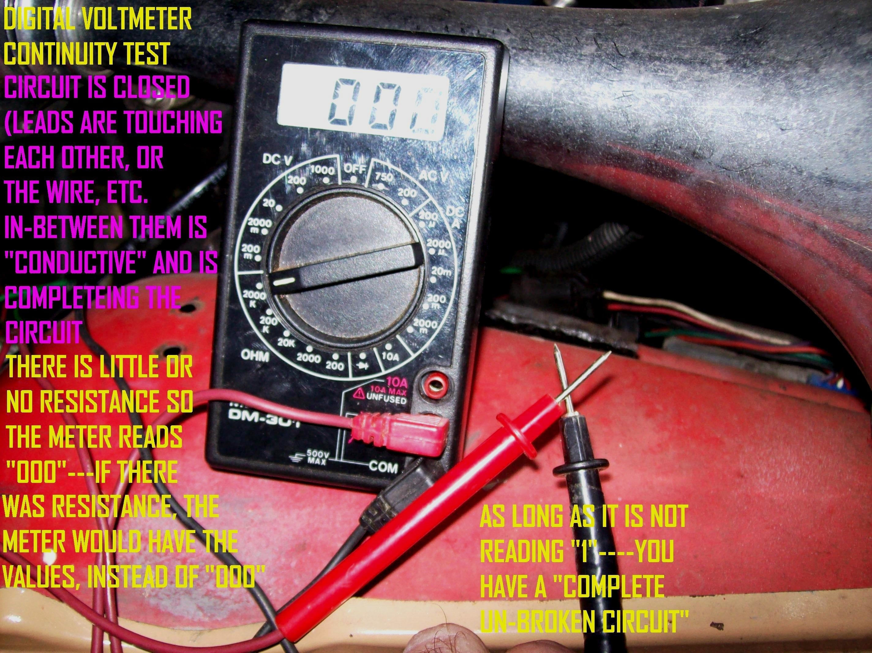

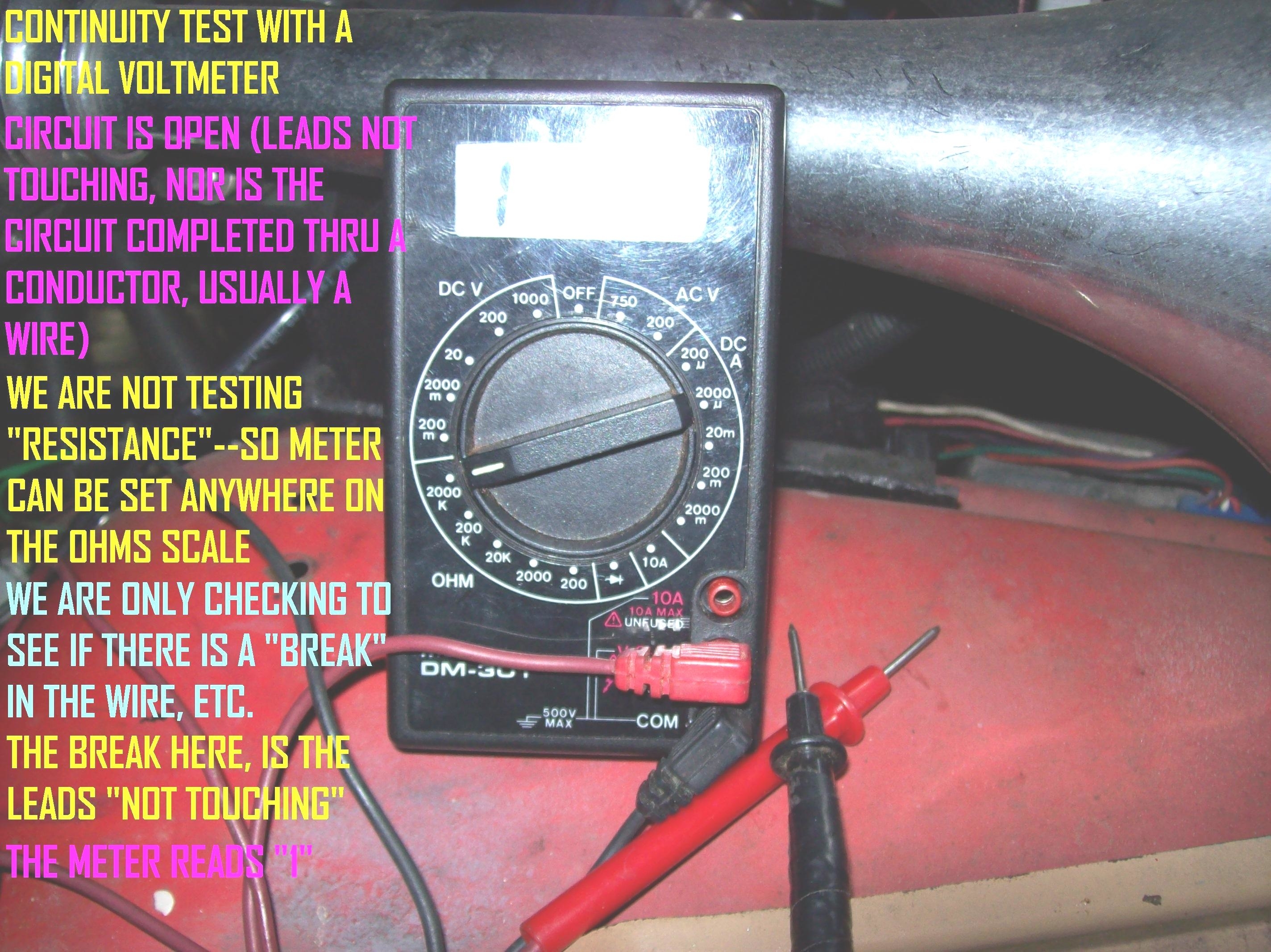

Picture 3) see the leads are touching (this is a complete circuit). If you put a wire length (etc.) Between the leads, this should be a complete circuit also.
Picture 4) Now we have a "broken/ cut" wire between the leads. The circuit is not complete. There is "no continuity". Hence, the wire between the leads is an "open circuit". In our case, we would have a bad part.
I made these pics long ago, I was just getting a little computer competent. Ask me if you are lost!

Black pin to body. Ranges from 0.2 to 000.
Cross convectors.60 to.58.
Tuesday, March 26th, 2019 AT 6:23 PM
CJ MEDEVAC
  • 11,004 POSTS
Distributor seems fine.
