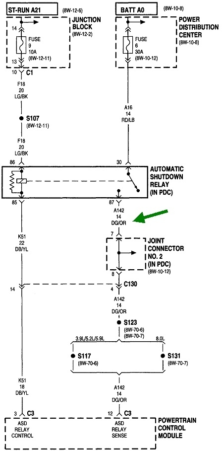

Happy New Year and thank you for the reply! Okay, so we dug back in today and found a semi loose connection on pin 23 on the PCM. However, we also found only one of the 3 PCM's after we remade this connection secure would fire up the ASD and fuel system relay, so now we have fuel. However, we verified nothing is going to the coil. And nothing is going to the injectors. We have not verified crank or cam shaft position sensors yet. The ASD relay does not turn on for only a second it stays on now when the key is in the run position. Same with the fuel pump. I'm not sure if this is normal. So far I am thinking there is a short with something to the PCM or something communicating to the distributor and the injectors. Also we jumped 12vdc to the coil while cranking to see if we would get spark from the plug wires and still nothing but the coil was under load.

An led testlite should be safe for your computer. They don't recommend a 12 volt test lite on computer circuits. Touch one end of testlite to voltage the other end to the computer ground at the asd relay, engine cranking, the lite should be on. If the lite goes out, your losing voltage or ground.
You could use a jumper wire on the load side of asd relay, just for testing, that should run voltage to everything the relay controls. See if it will start?
In the diagram I posted, is the asd relay, the load side of relay has the line with the arrowhead on it. When the relay is energized, that line with the arrowhead moves to the other terminal for voltage. I'm not sure I explained that very well? If you don't understand what I've posted, don't try it.

Next, I'd like you to go back to the tests you did in regard to the ASD relay. You listed multiple observations that can't agree. Monitor the voltage on the dark green / orange wire at the ignition coil or any injector. That must have 0 volts when the engine is not rotating. If you find something, unplug the crankshaft position sensors. I read once where one was generating noisy signals that tricked the computer into turning the ASD relay on at the wrong time.
Assuming you do find 0 volts, now see if it switches to 12 volts when you crank the engine. If it does, the circuit is working. If you do not find 12 volts, stop, turn the ignition switch off, then back on and verify there's 12 volts there for one second. If there is not, fuse 6, a 30-amp in the under-hood fuse box is blown. That's shown at the top of the first diagram. Or the relay is not being turned on. Pull the ASD relay out of its socket, then check for 12 volts on two of the terminals in that socket. Terminal 30 should have it all the time. Terminal 86 should have it when the ignition switch is in the "run" position.
