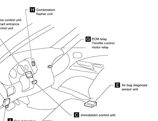

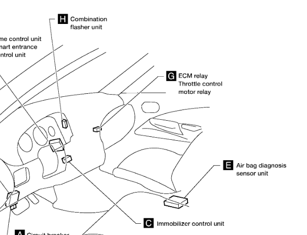

No problem, first I would see if the engine will run on starting fluid. If not let's test the ignition coils for 12 volts with the system on (grn/wht wire). If not, I would swap out the ECM relay which is located behind the dash on the right side. Here is a guide to help run down the problem as well. Also, I wanted to ask how does the engine sound when cranking over, normal?

I forgot to mention I tried starter fluid. I tested the green and white wire, and it does have 12 volts and yes, the engine sounds fine. Excuse the picture I misread your message.

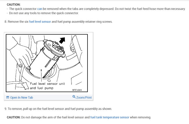

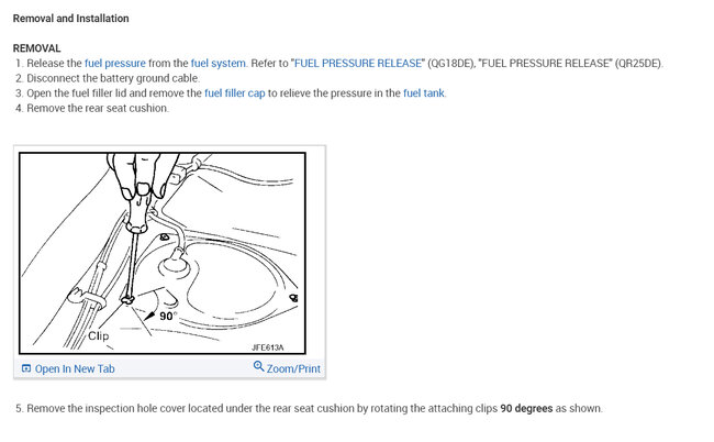

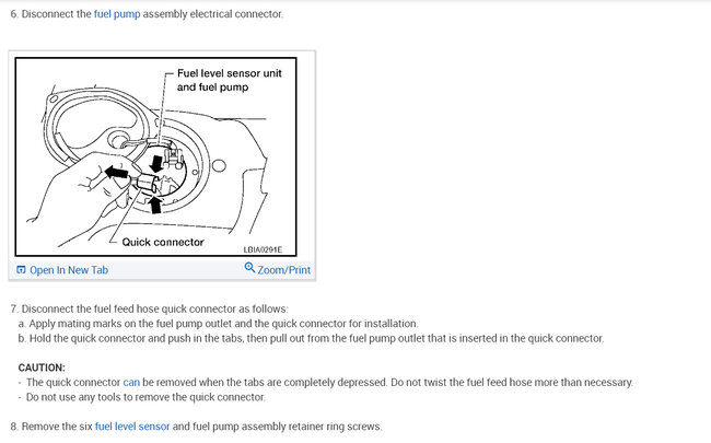

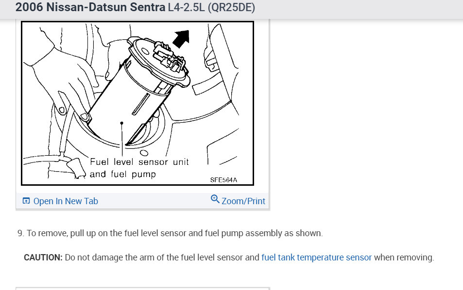

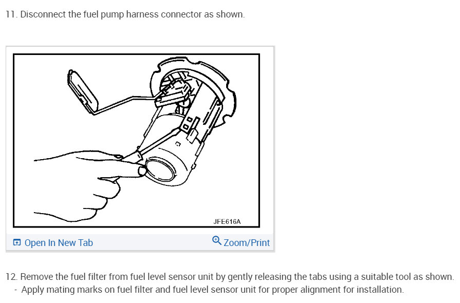

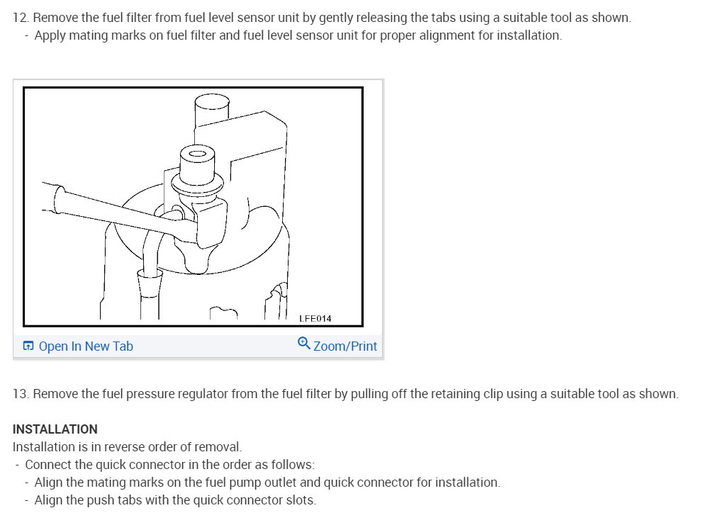

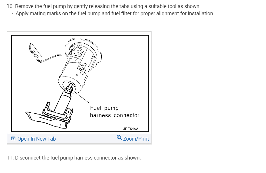

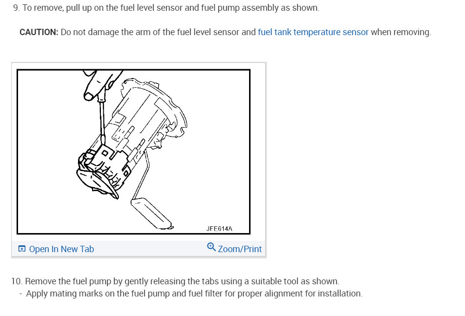

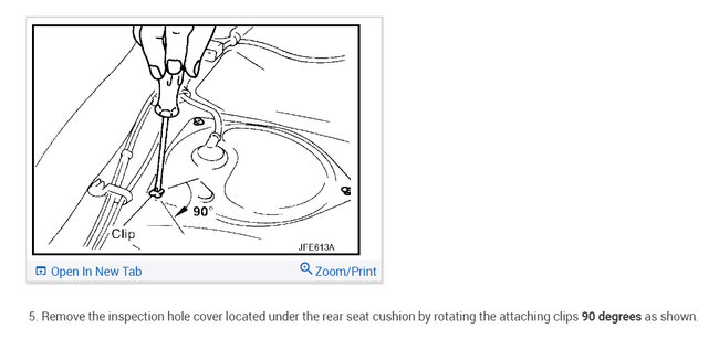

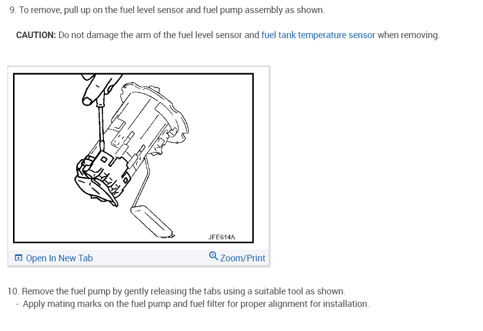

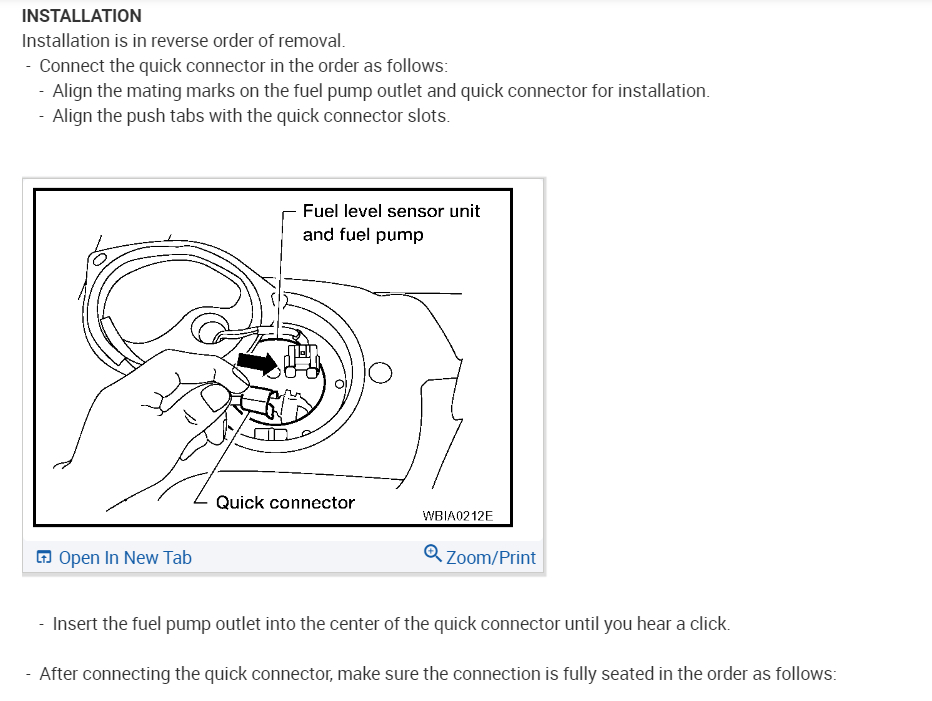

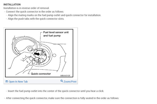

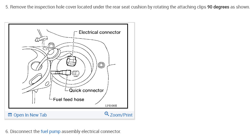

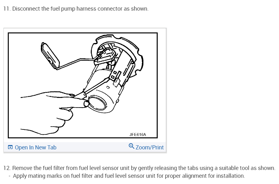

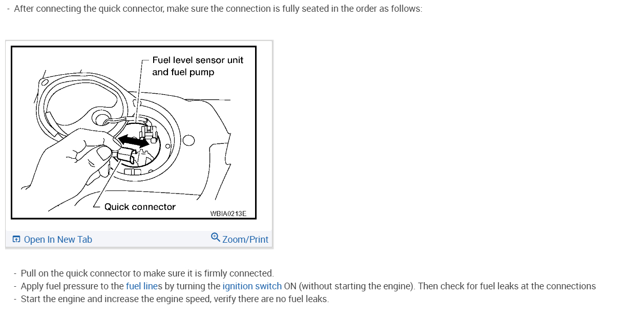

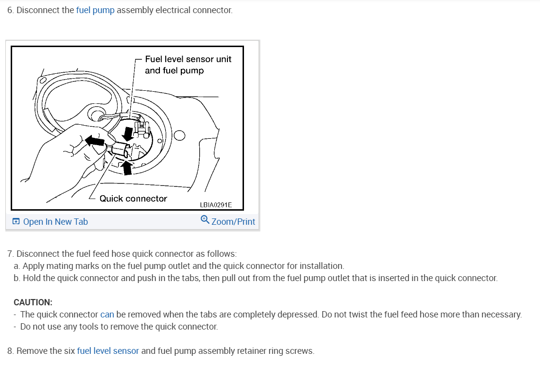

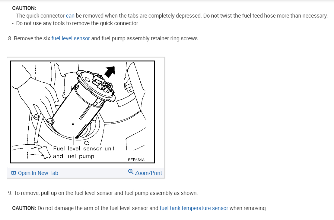

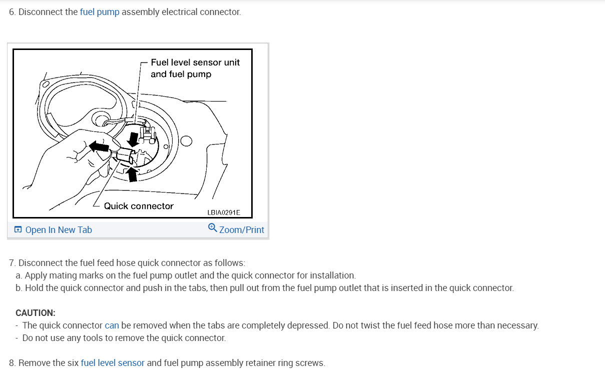

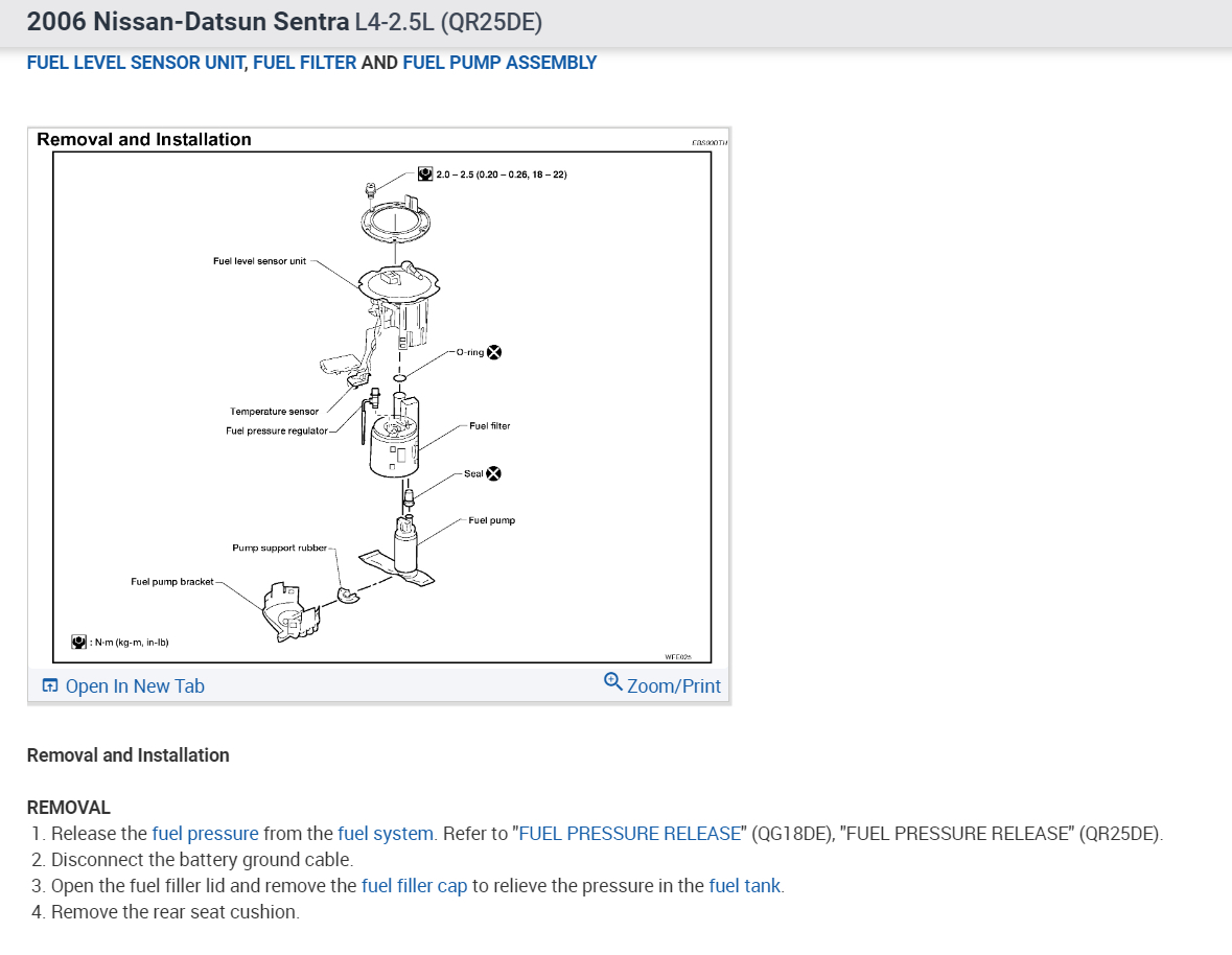

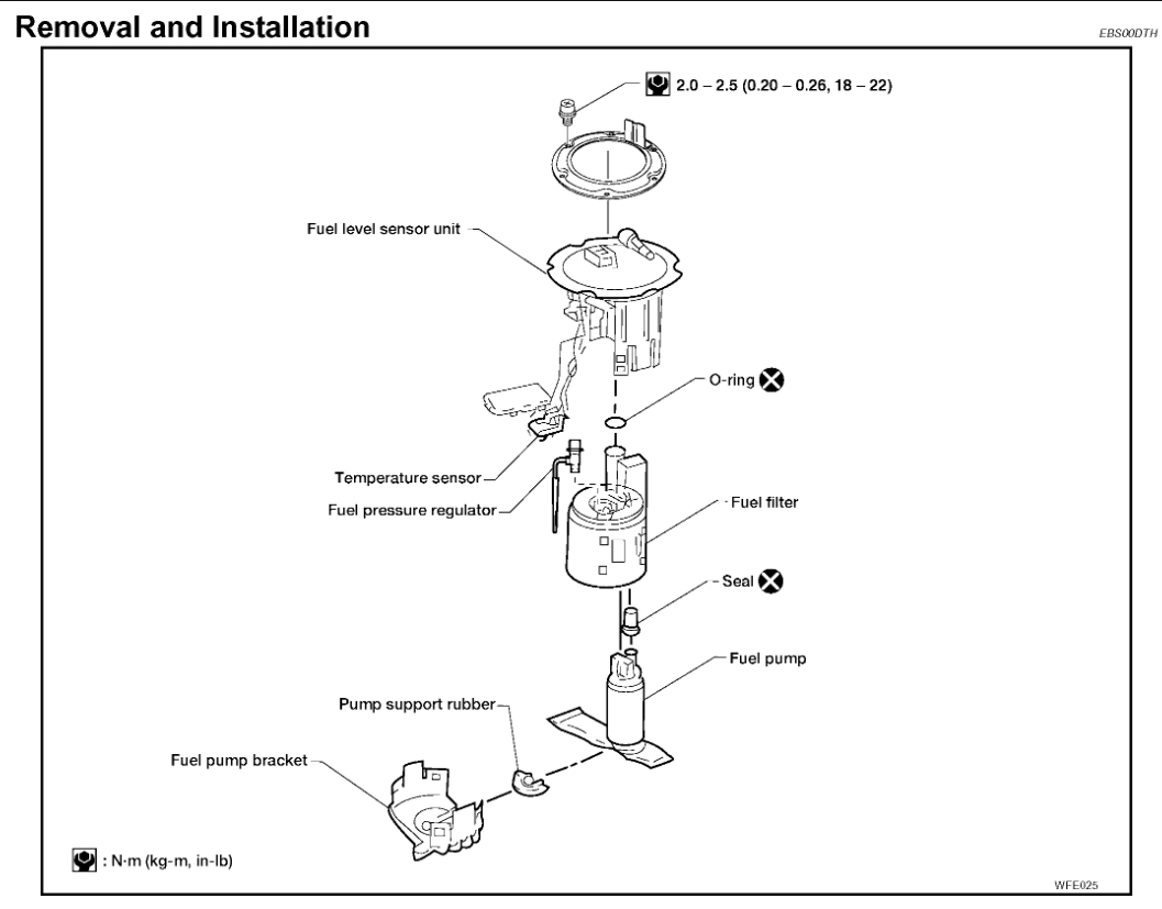

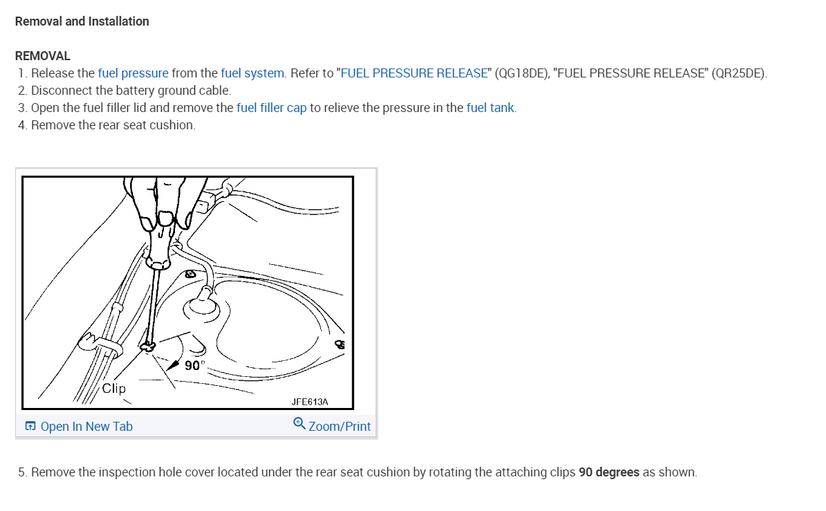

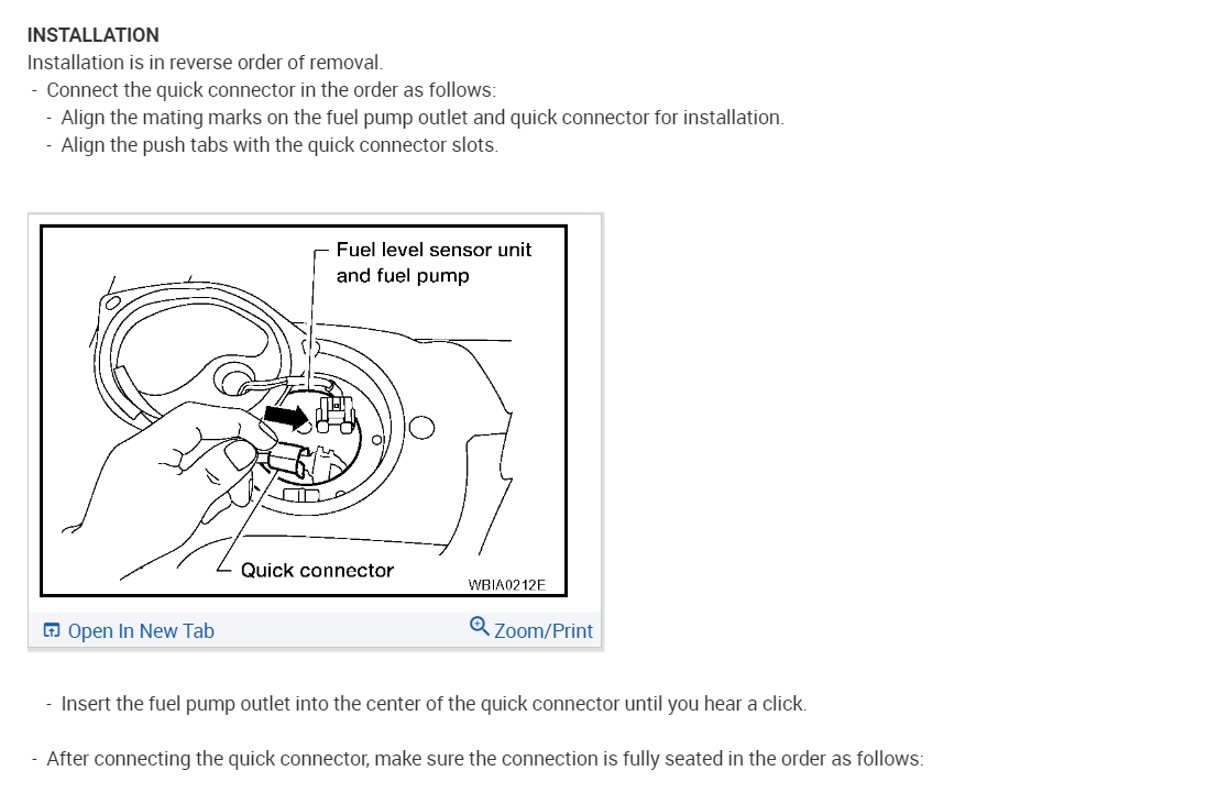

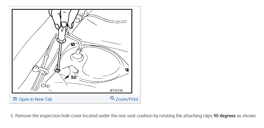

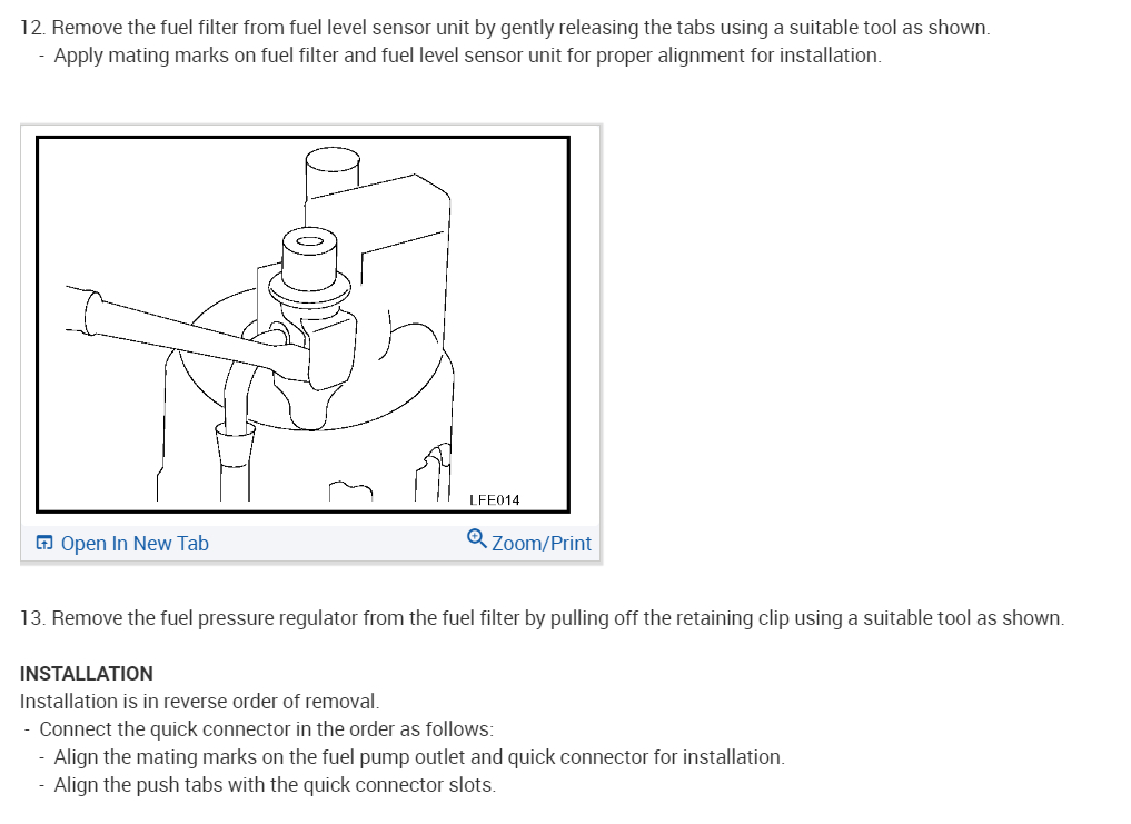

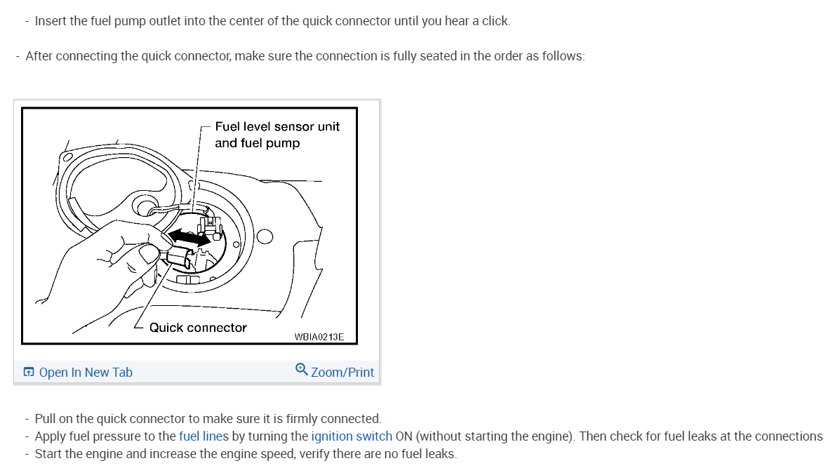

Yep, it looks like you found the problem, a weak fuel pump, here is how to change it out. Check out the images (below). Please let us know what happens.
Tuesday, July 25th, 2023 AT 6:49 PM

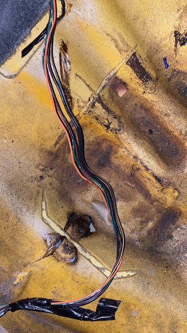

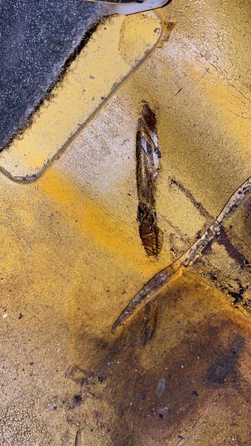

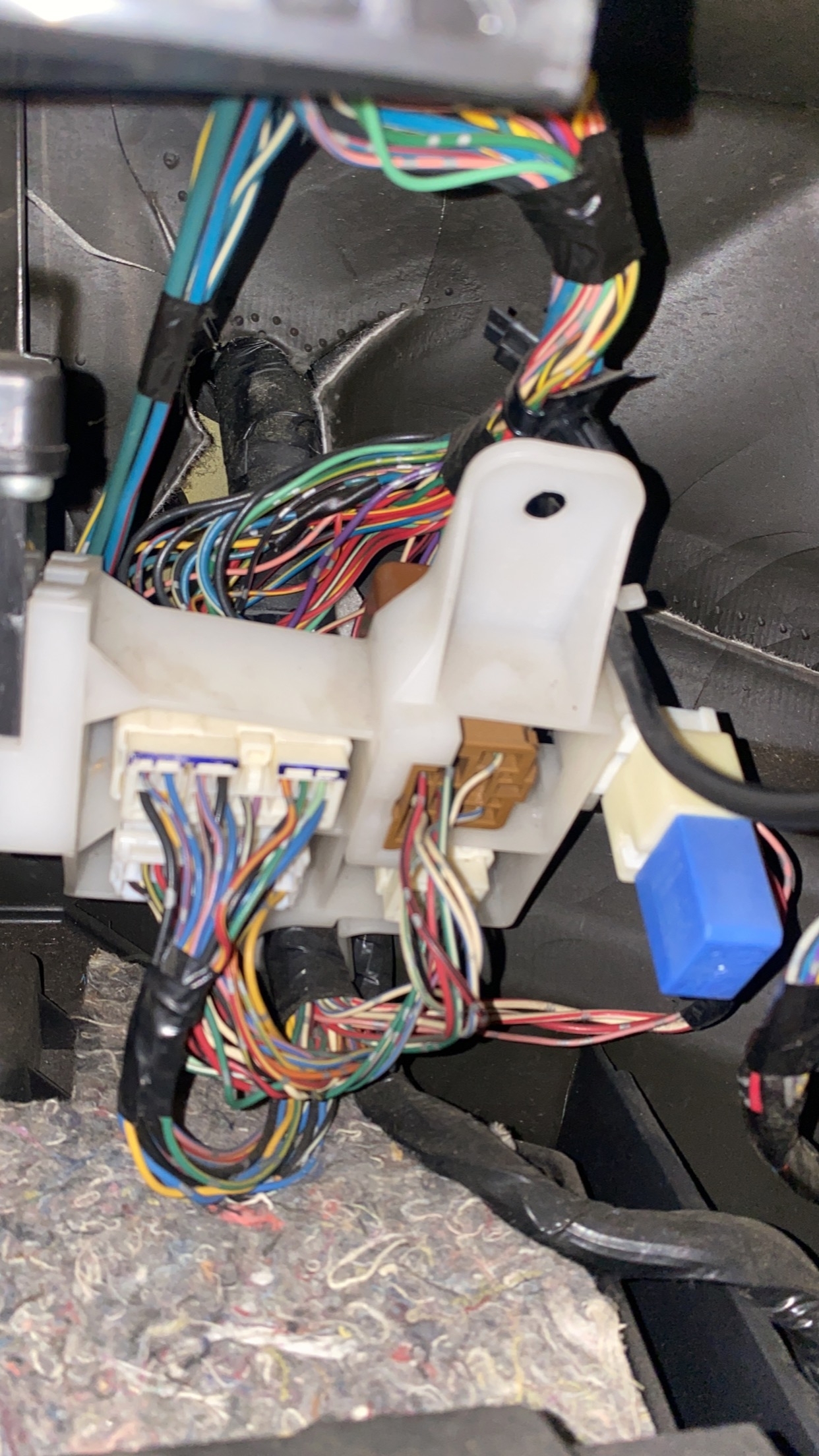

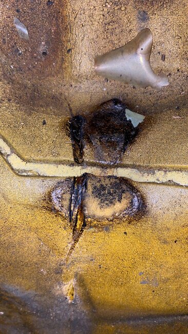

When removing the old fuel pump, I noticed that there looked like burns on the seat where the harness was, I checked the harness and couldn’t find any visible damage, so I continued on putting the new pump in. When I finished, I could hear the pump prime, but it still took 4-5 seconds to finally start. After it started, I let it run for about 5-10 minutes and it turned off on its own, I tried to turn the key and no start again, so I checked my fuse with a test light and it was still good. After that I turned, the key, and it primed again this time it started back up. I drove it around for about 15 minutes perfectly fine and parked it for the night. The next day I went out to start it and attempted to drive but when I was leaving it started to stall like I was running out of gas and shut off. I turned the key, and it turned right back on no problem and took it back home. But I’m still experiencing long cold starts, the pump has shut off twice at random and sometimes the pump will prime sometimes it won’t.

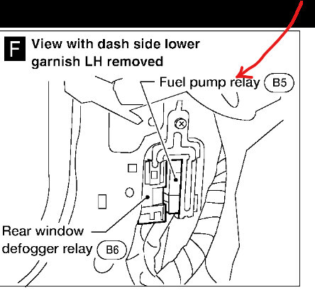

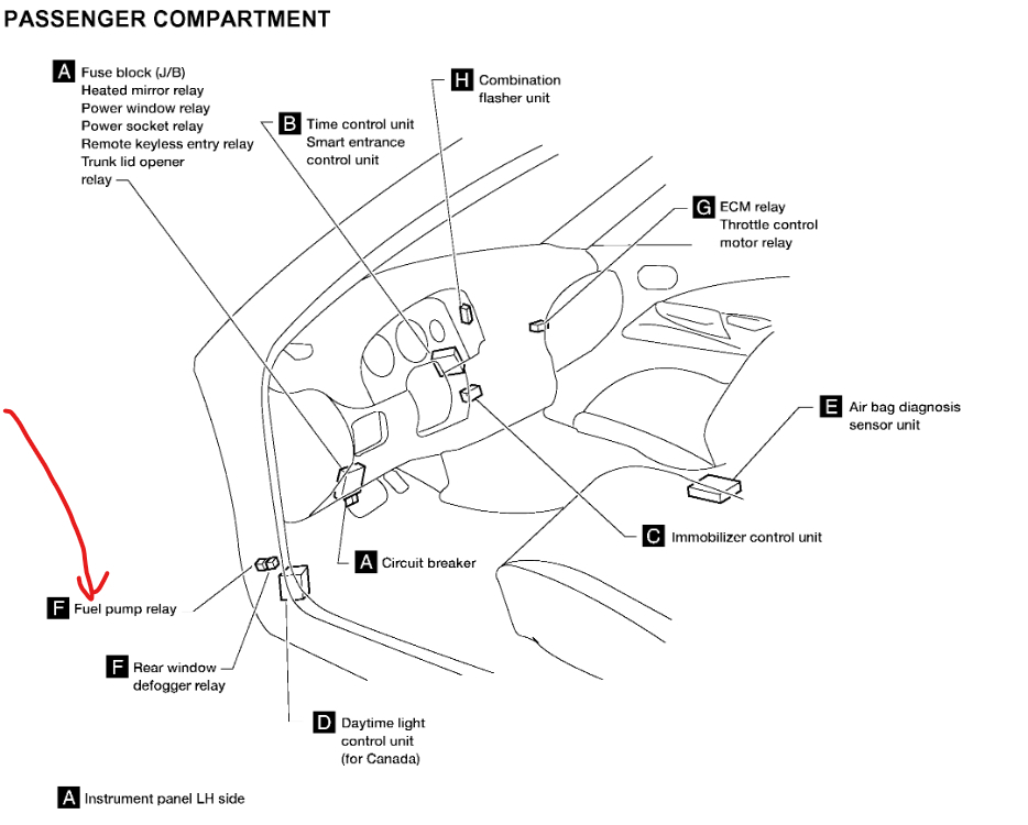

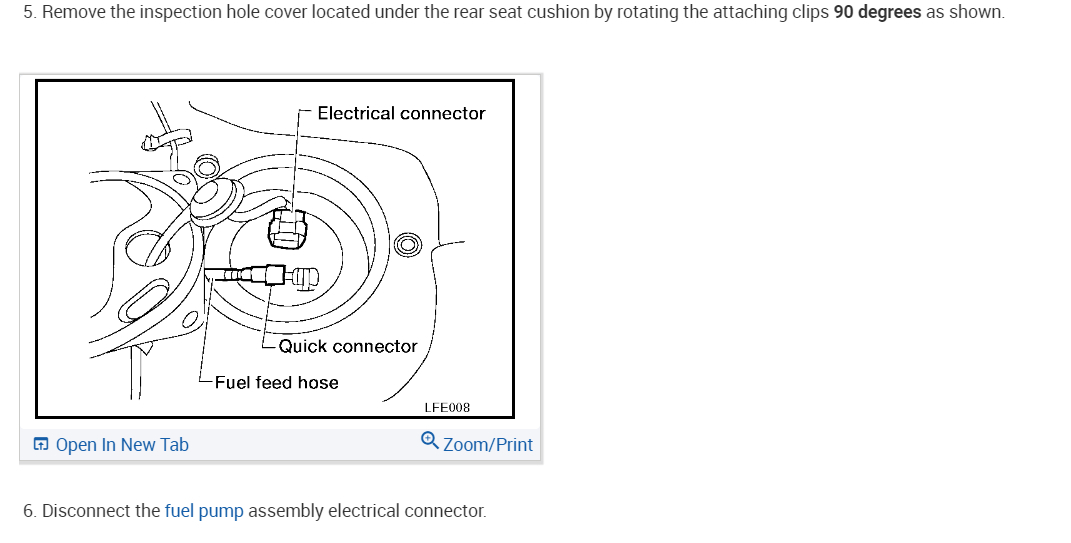

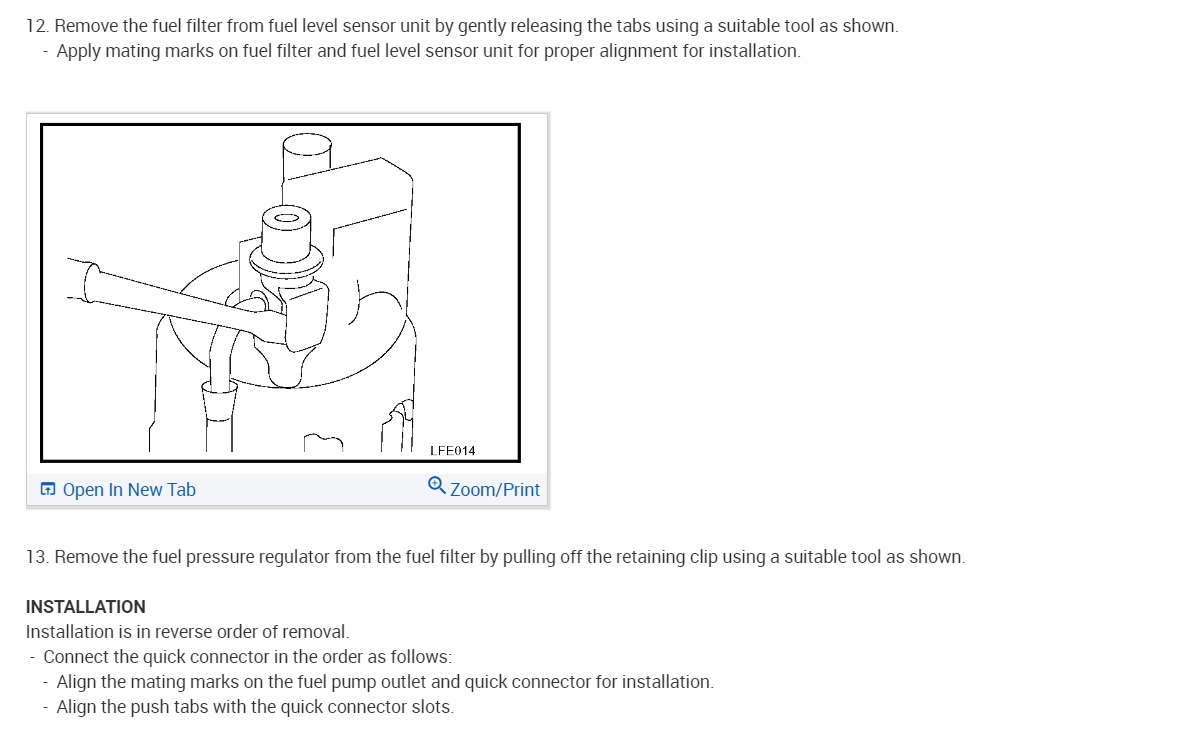

Good find, I would make sure to repair and protect the wiring and then replace the fuel pump relay which is behind the left kick panel. Check out the images (below). Please let us know how it goes.
Monday, July 31st, 2023 AT 10:56 AM
JJ GARZA
  • 20 POSTS
I replaced the relay, and it still is acting like it doesn’t have fuel pressure. The fuel pump primes more now but it is taking a little longer to start, sometimes it still won’t start at all.

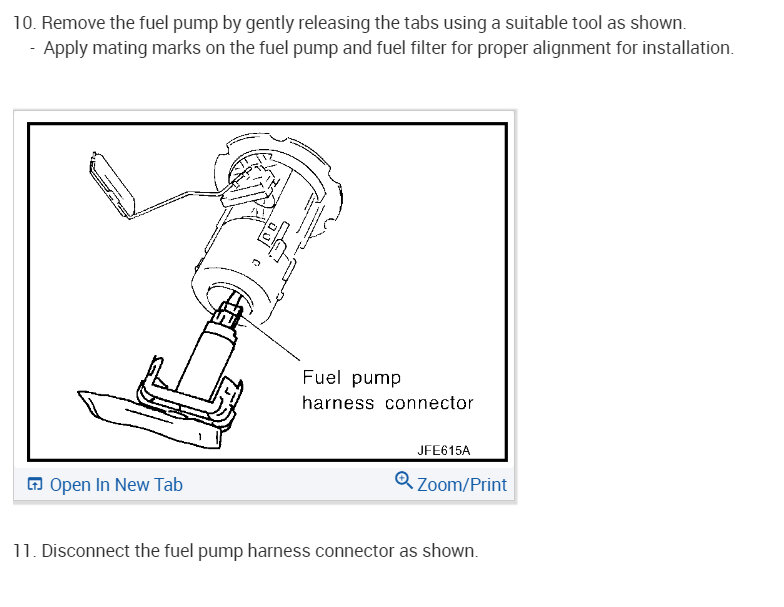

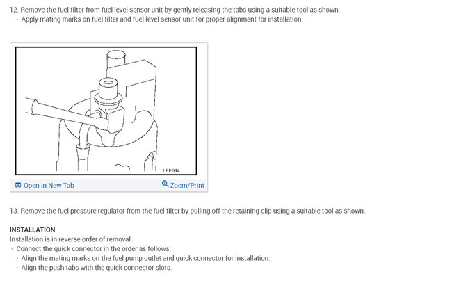

It sounds like the fuel pump is going out, but to be sure we can do a fuel pressure test. This guide will show you how, and you can rent a fuel pressure gauge from the auto parts store.
Fuel Pressure
Fuel pressure at idle .................... Approximately 350 kPa (3.57kg/sq.cm, 51 psi)

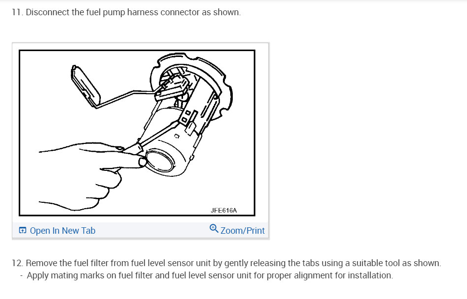

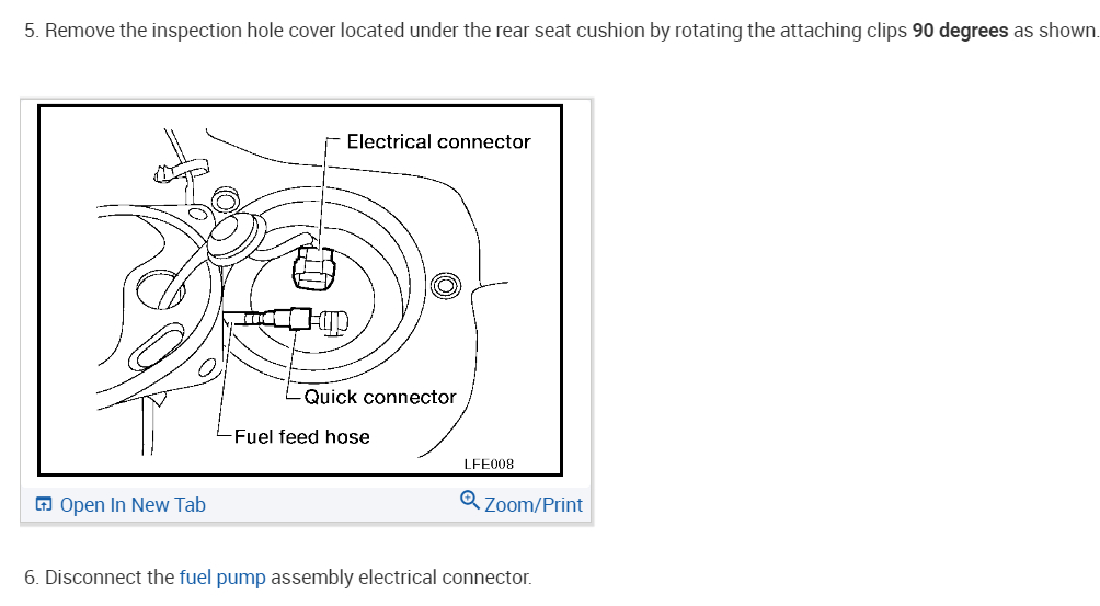

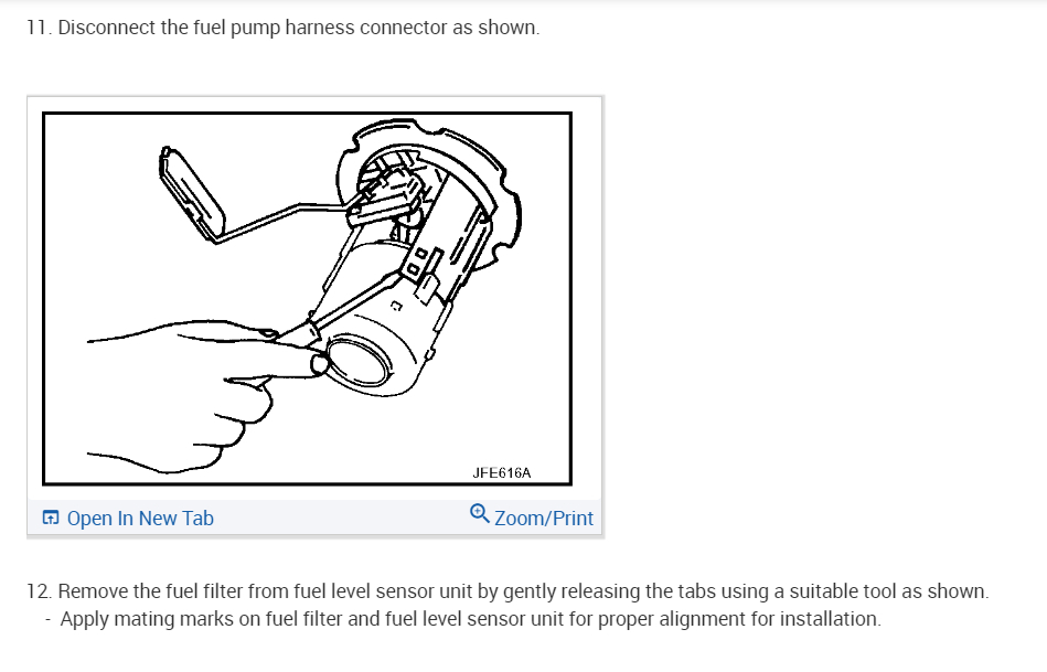

Here is now to change the fuel pump in case you need it. Check out the images (below). Please let us know what happens.
