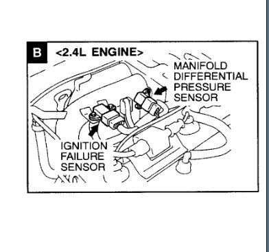

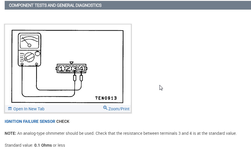

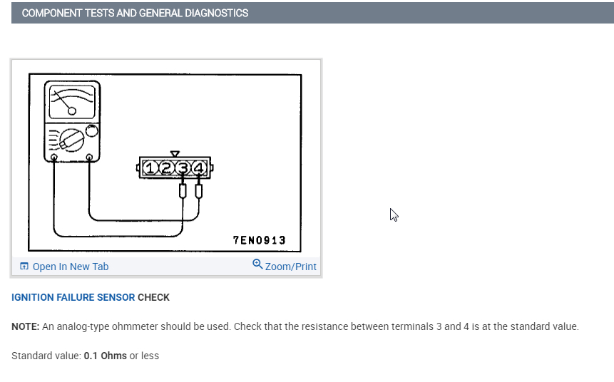

Okay. We need to check the ignition failure sensor. This can prevent the injectors from firing.
As for the other issues with the gauges, that doesn't seem to correlate with this issue. The ECT is a direct feed to the combination meter (cluster) and so is the speed sensor. This would indicate the cluster is the issue but let's try to figure out the no start first and if it fixes the others, great. If not, we can readdress those.

The ignition failure sensor checks out good.

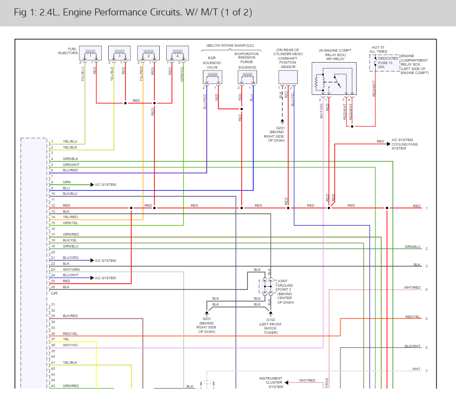

Okay, I bought the car listed above 5 speed with this no spark issue I didn't get really any details for the kid I bought it from because it had been through several owners since it stopped running. But I was banking on it being crankshaft position sensor. So I tow the car home and when I'm taking it apart I get to where the crank sensor wire goes down between the metal bracket and the engine block I find that the 3 wires have been pinched and split open and where all 3 shorting to each other. So I thought for sure that's where the problem was. But since then I've changed the crank sensor, cam sensor, coil packs plugs, and wires. Still no spark and checked all fuses repeatedly, but I still have no spark. Engine just cranks. I hooked up a obd2 and it give a code for bad EGR valve that's it. Any ideas of what to try next would be greatly appreciated.

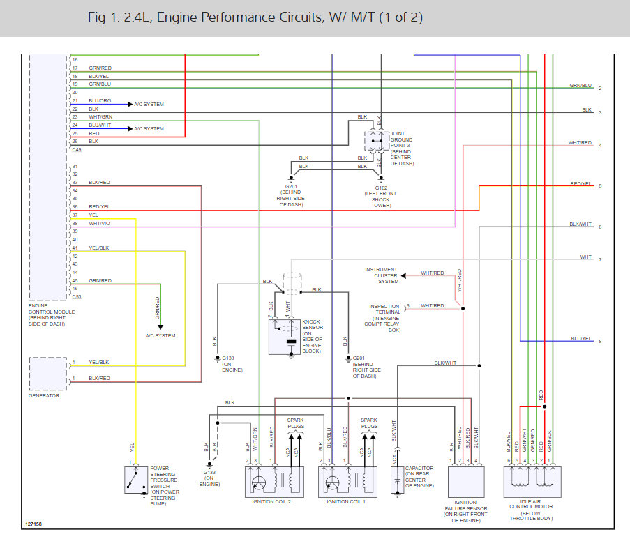

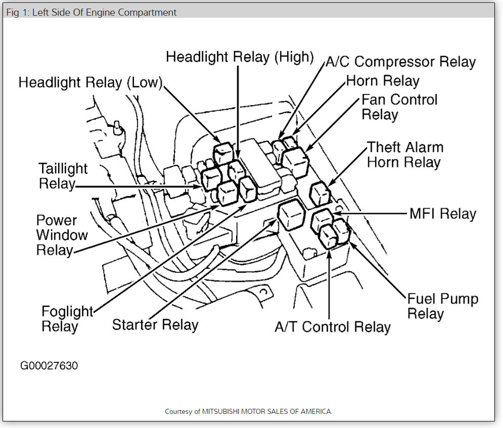

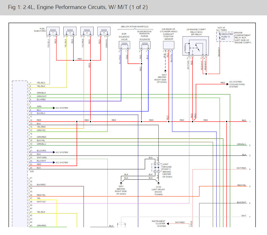

It either sounds like the wiring still might be messed up or you have a MFI relay that is not working. here is the engine wiring diagrams and a guide to help you check the connection and to help test the relay with the relay location below:

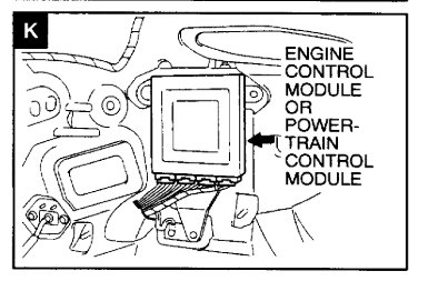

The no spark will follow the car so a new engine probably won't work. If you have repaired the wiring and the sensor is good with the MFI relay in working order the PCM could have gone bad due to the shorted wiring. Here is how you replace the PCM in the diagrams below. Check out the diagrams (below). Please run this test and get back to us.
