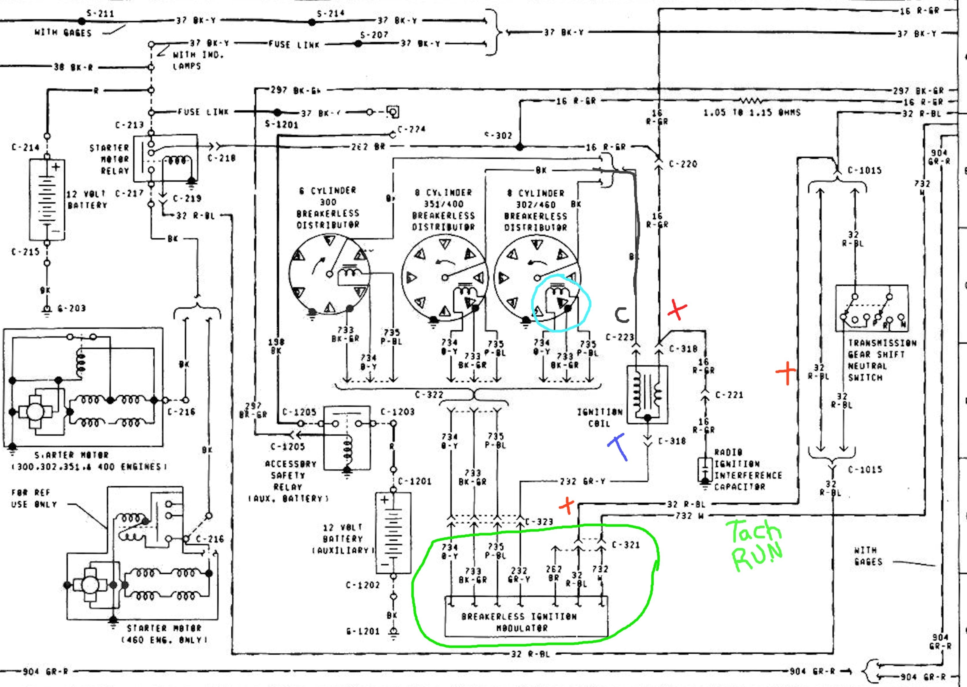

Battery power goes to the + side of the coil. The - side is the trigger. The ignition box has a three wire plug that goes to the inductive pick-up in the distributor. That is the trigger that tells the box when to fire. Then there is the second plug that carries power and a timing signal. It is a 3 part system. The box, distributer and coil work together. Test for power at the positive post on the coil, Then at the 2 wire plug to the ignitor box. (Should be a Red wire with black stripe, but there were a few colors used, just like the ignition boxes. If you have power to those with the key on, then the key switch is working. However with the vehicle doing nothing when you turn the key, ignition isn't the problem, the power isn't getting through so we need to figure that out first, If you just want to see if the engine will run and jumping the solenoid gets it to turn over you could try an old trick. Take a length of wire, connect it to the power feed on the ignition box, then another to the positive terminal on the coil. Now jump the solenoid and see if it starts up. You cannot drive it this way because the constant 12 volts could burn out the coil and nothing else is going to work, but it should let you test the engine. To shut it off disconnect the wire to the battery.

12 volts at the positive and negative post on coil and the red wire with black stripe st the 2 wire plug to the Ignitor box with the on. So I run a wire from the red wire on the Ignitor box to the positive terminal on the coil and jump the solenoid but the engine didn't start. Do I suppose to connect two wires from the power feed on on the Ignition box and positive terminal on the coil? I'm a little confused here. What color is the wire I suppose to connect to at the Ignition box?

What the volts should be on the negative side of the coil when turn key on? The negative side of the coil is it the trigger side from the Ignition control module? Can I check for a signal at the coil or the ignition control module? The ground strap is not hooked up. Do it connect from the engine to the fire wall. Sometime when cranking I can see spark of fire at the starter solenoid.
Thursday, December 18th, 2025 AT 7:15 AM
STEVE W.
  • 15,694 POSTS
The negative side is the trigger on the coil. The ignition works by grounding that side and then opening it, when it opens the magnetic field collapses and you get a spark. No way to check for the signal without an oscilloscope. The missing ground strap is part of the problem. You should have one negative cable from the negative side of the battery going to the engine block, then a second cable from the engine block to the firewall. Then another that goes from the negative to the body. And usually underneath there will be a cable connecting the cab to the box and another from the frame to the body. The ignition module for example has to be mounted and secured to have a ground, if you just plug it it without a good ground it will burn it out because of the lack of grounding.

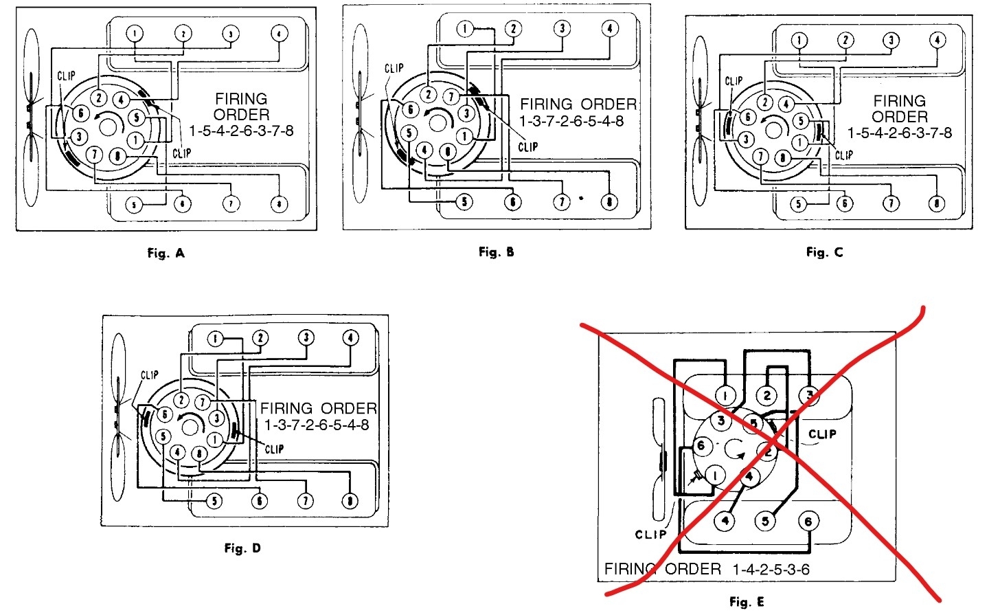

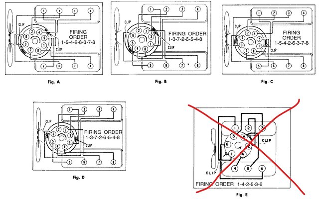

(In the cap I wire up counter clockwise 1 5 4 2 6 3 7 8 is that correct? I'm not sure is it a 302 engine how would I know? Do I need to remove the valve cover to see is the intake and exhaust valve close on number one cylinder? Do you have and image showing how to do this? What number do I set at on the harmonic balancer? I see (TC, 10, 20, 30).
Monday, December 29th, 2025 AT 7:59 AM
STEVE W.
  • 15,694 POSTS

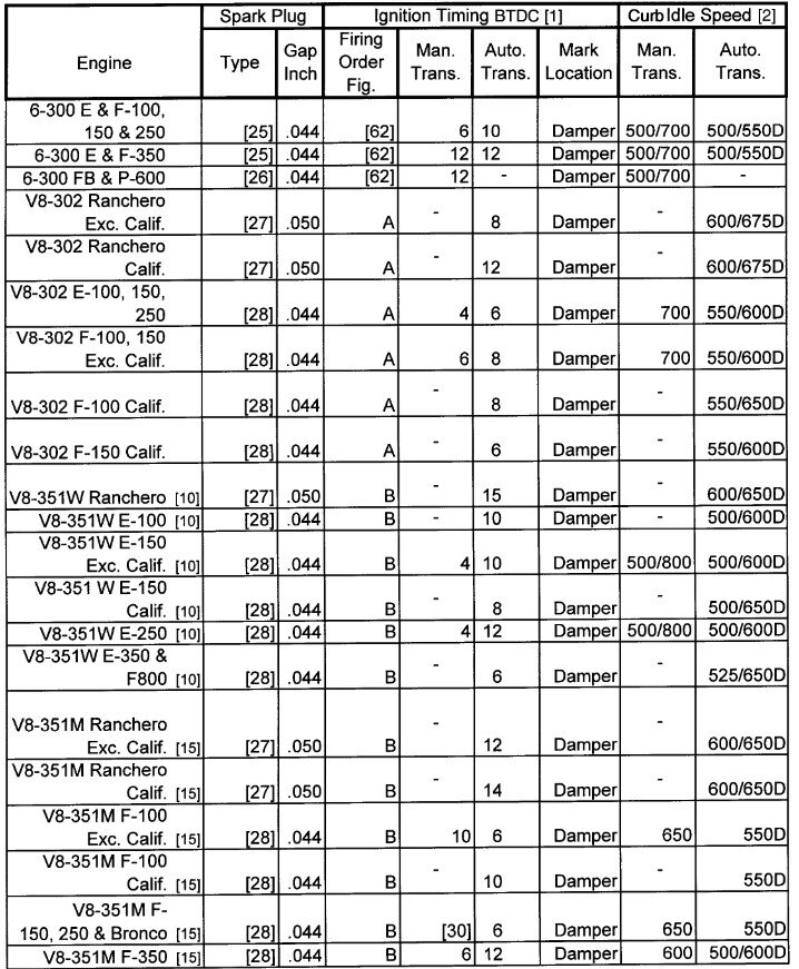

If you look up the VIN number online it might tell you what the engine is. Without that info the rest of your question cannot be answered correctly. Except for the question of finding TDC. You can do it the way I posted above, remove the plugs then rotate it while feeling for the compression to push out of the plug hole. Then you can set the distributor. No reason to open the engine.
Once that is done you can set the firing order as it is different for the engine types.
So look at the 4th digit in the VIN to find the engine series (IF it is the original engine) VIN G = 302, VIN H = 351, VIN S = 400 and VIN J is the 460. The firing order you have is correct for the 302, the 400 and the 460 engines however the 351 uses 1-3-7-2-6-5-4-8. Then look at the chart I attached and find the engine and the proper timing.

I did use my timing light and adjust the timing to 8° at the harmonic balancer. The engine has been rebuilt so the rear main seal been replace unless it got damae replacing it.
