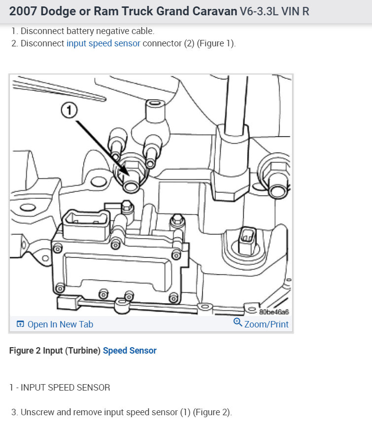

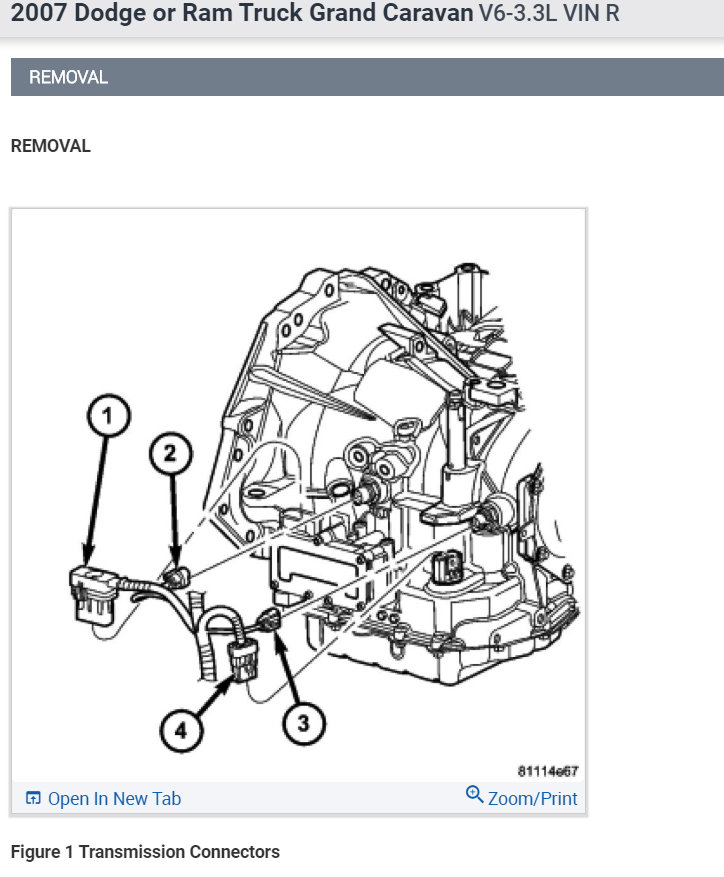

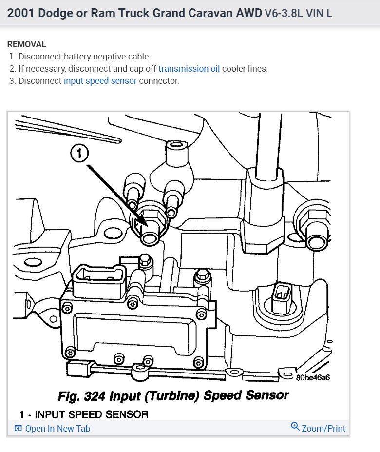

input shaft speed sensor location? I need to replace it
2007 DODGE CARAVAN
182,000 MILES • 3.3L • 6 CYL • 2WD • AUTOMATIC
WILLIEDYNAMITE11
I purchased the van used and I've been driving it now for about a year was curious to know why or what would possibly be causing not to get engaged in reverse? And recently is starting to feel as if it's surging or shuttering as I'm driving. More so kind of high mileage or higher miles per hour. Can you please give me some feedback? I would appreciate that. Thank you.

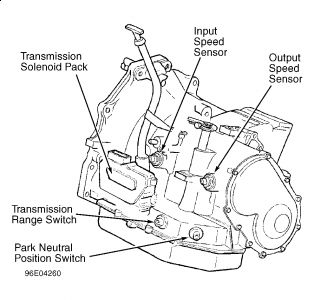

I have seen the input shaft speed sensor cause this issue and sometimes cause a code. here is a guide to help you retrieve the codes and the sensor location so you can check it out:

https://images.2carpros.com/forum/automotive_pictures/99387_Graphic9_51.jpg
have to check for TCM codes most common speed sensors and or tranny solenoid packs

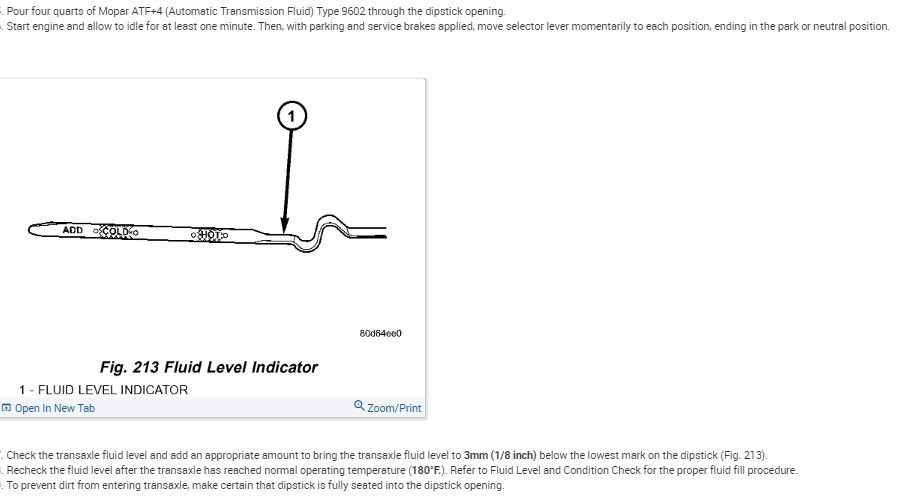

LEO MERCIER
I serviced my transmission, now on decel I get a hard downshift.. Used Valvoline ATF4

hi billymac here. well there is really not anything that servicing the trans can cause.however here is a thought a lot of times when a trans is going bad the dirty fluid and worn fiber parts work as a replacement for clutch disc.and when you change the fluid then the disc will start to slip this is called washing,,was there metal in the pan when you changed the oil? another possibility is output sensor and input sensors or even trans computer.the computer has the capability of adjusting harsh shift patterns if this is the case driving it for a few days will solve the prob.
Has the check engine light come on?
It calls for Mopar ATF 4 so I would imagine the Valvoline you used would be an acceptable fluid, is the level correct?
Read the guide below, it might help you figure out whats going on
hope this helps billymac

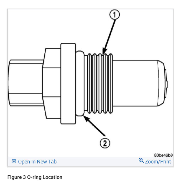

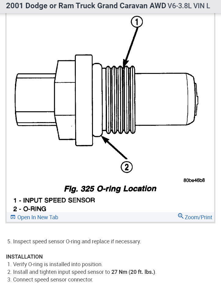

  • 54,520 POSTS
I have seen the input shaft speed sensor cause this issue here is the location so you can check it out. Check out the diagrams (Below). Please let us know what you find.

BMRFIXIT
  • 19,053 POSTS
1st step I would take would be replacing speed sensors you have two input and output
https://images.2carpros.com/forum/automotive_pictures/99387_Graphic9_56.jpg

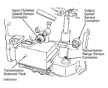

BMRFIXIT
  • 19,053 POSTS
here are the sensor locations
https://images.2carpros.com/forum/automotive_pictures/99387_Graphic1_150.jpg

BMRFIXIT
  • 19,053 POSTS
https://images.2carpros.com/forum/automotive_pictures/99387_Graphic_92.jpg
You have two speed sensors input and output unscrew old one and screw new one in
