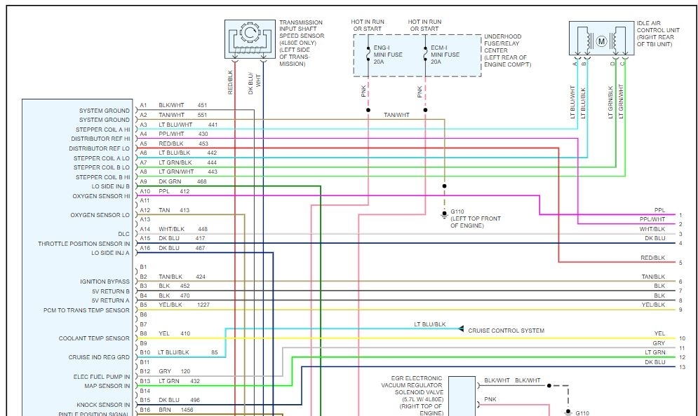

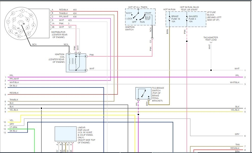

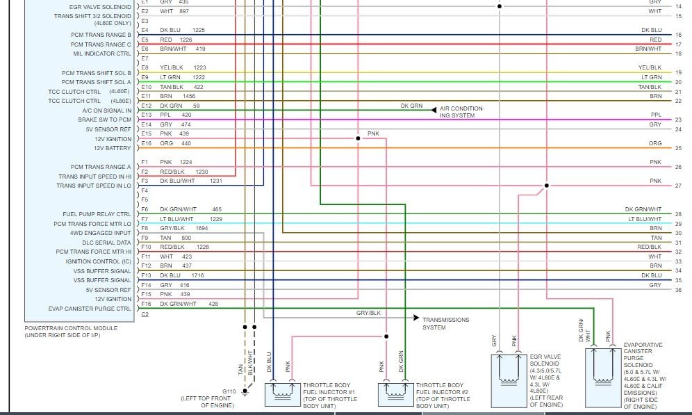

No power to fuel injectors
I blew up the diagrams for you so you can see better.
Tuesday, October 29th, 2019 AT 4:39 PM
DIRTY_95
  • 12 POSTS

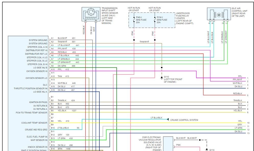

Yes, I have 12 volts to fuel pump and no voltage at a4 where EGR comes from computer.
Saturday, November 2nd, 2019 AT 12:07 PM

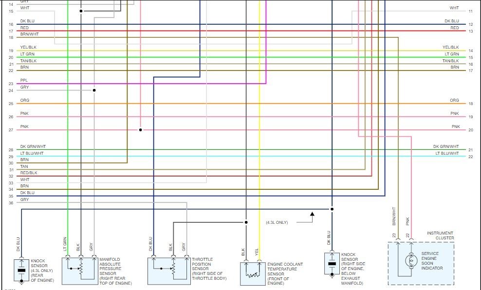

That should be 5 volts and comes from the ECM.
Can you check the map sensor gray wire and see if that has power?
Saturday, November 2nd, 2019 AT 12:23 PM
DIRTY_95
  • 12 POSTS
Yes 5 volts on grey wire on map sensor.
Saturday, November 2nd, 2019 AT 12:31 PM
AL514
  • 5,590 POSTS

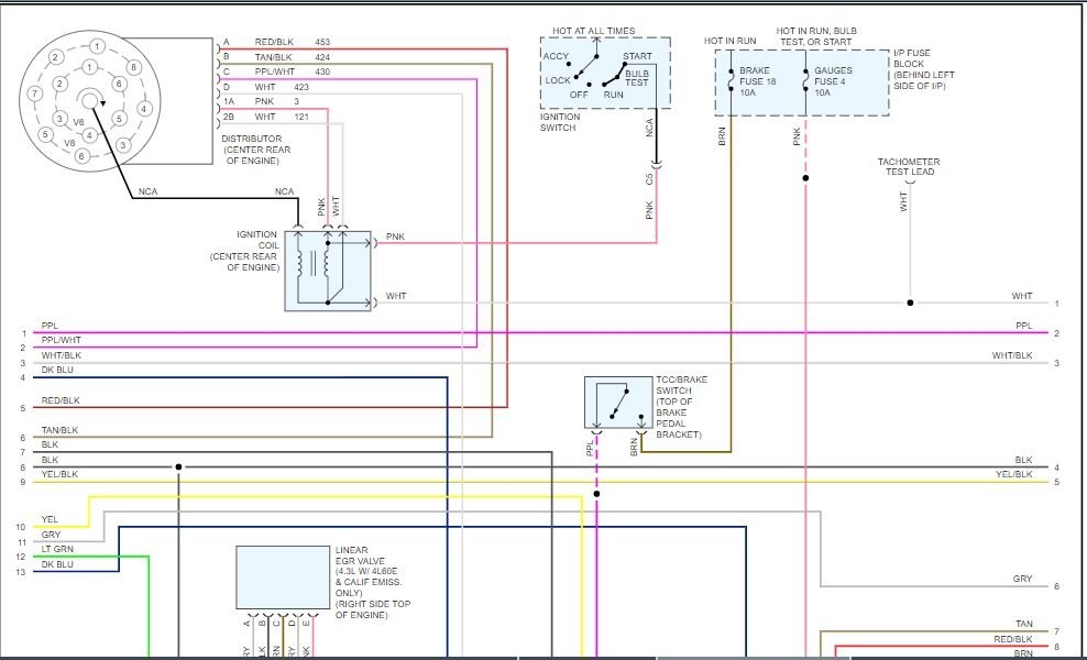

Are you getting a pulse with your test light on the purple/white wire at the distributor while cranking? It's the reference high signal to the ECM. Needed for injector pulse.
You have a wiring issue. The gray wire at the map sensor is the same wire. There is an issue in the harness where they come together. I would check the harness carefully for any damage. You may have a break inside the harness.
