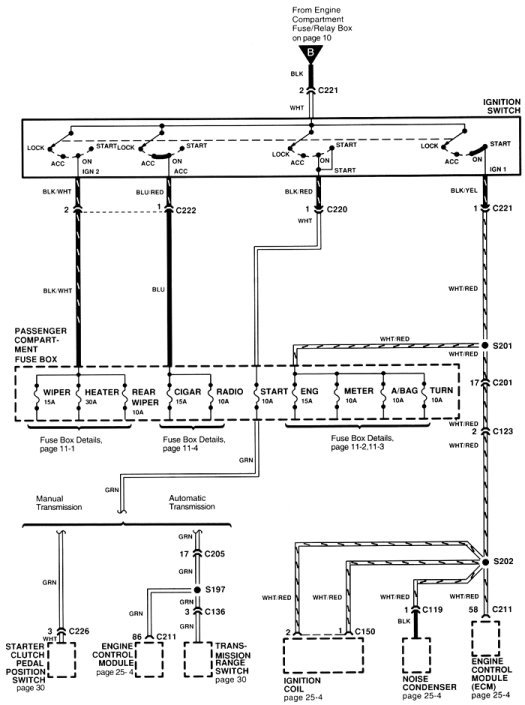

I have no turn signals, no windshield washer, no wipers and the car will not start. It will not even try and turn over. I think the horn might still work have not tested that, but I have no ignition. It is like my ignition switch is broke or something like that. I have been told that it could possibly be the clock-spring assembly, not sure. Need to have the question answered. Thank you.

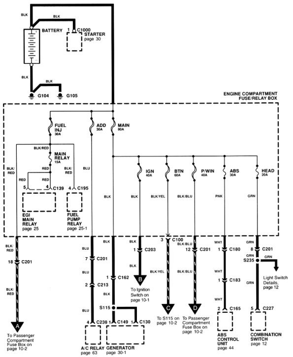

So you have tried to hook other power to it and nothing works then as well. In that case I would look at the fuse links to be sure they are good, then the ignition switch. What country is this vehicle in? I am looking at schematics but only show a 2.0 not a 2.3?

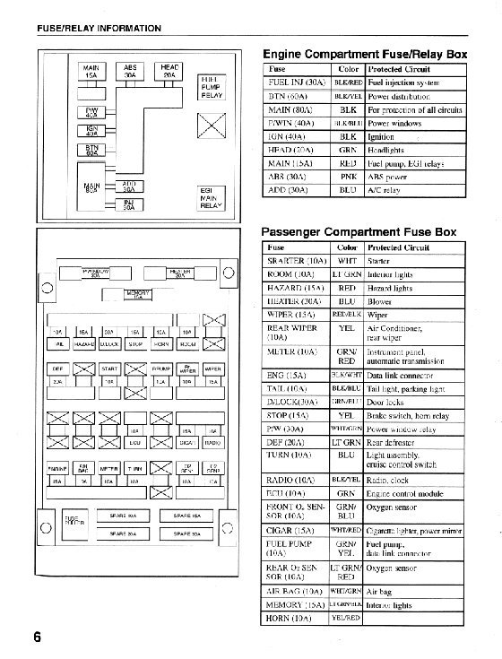

Had already ordered the spring switch the clock spring assembly replaced that I still have nothing replaced every fuse under the hood except for my 80 amp main fuse I'll have to change that in the morning if that doesn't do the trick could it be either ignition switch or CPU ECU

In most vehicles you start at the battery, power gets split with one large cable to the starter, Another to the generator and one that feeds into the fuses. The ignition switch turns on the systems using the relays and computer modules. If it doesn't send the wake up voltage you end up with a "dead" vehicle. However what you need is the correct wiring diagram to see what powers and grounds will let you test to see where the actual problem is. That is why I asked about which country this is from/in. They built them for multiple countries and used different wiring depending on country/engine/options.

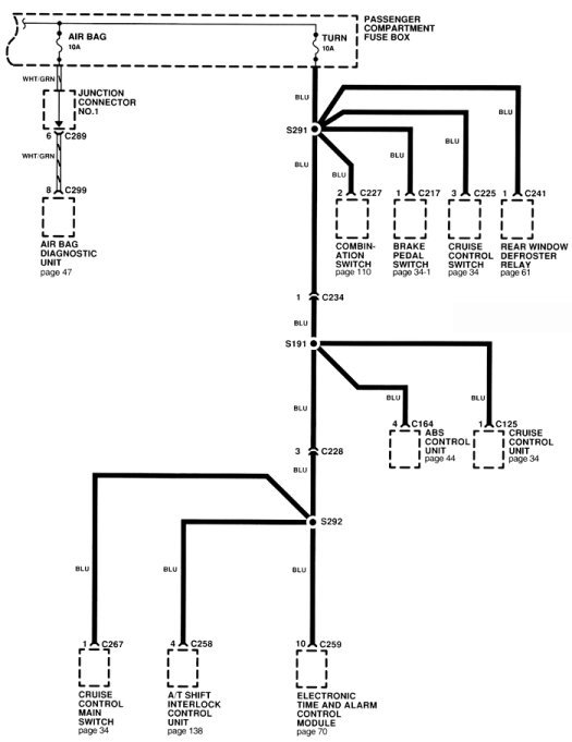

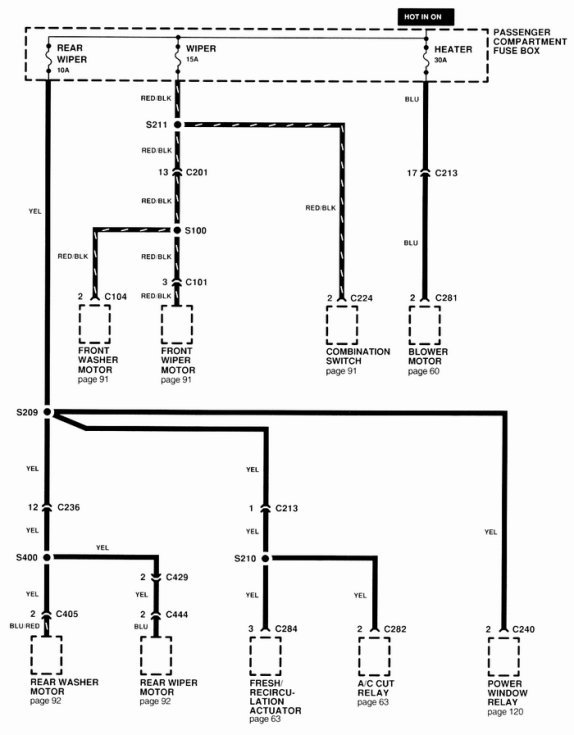

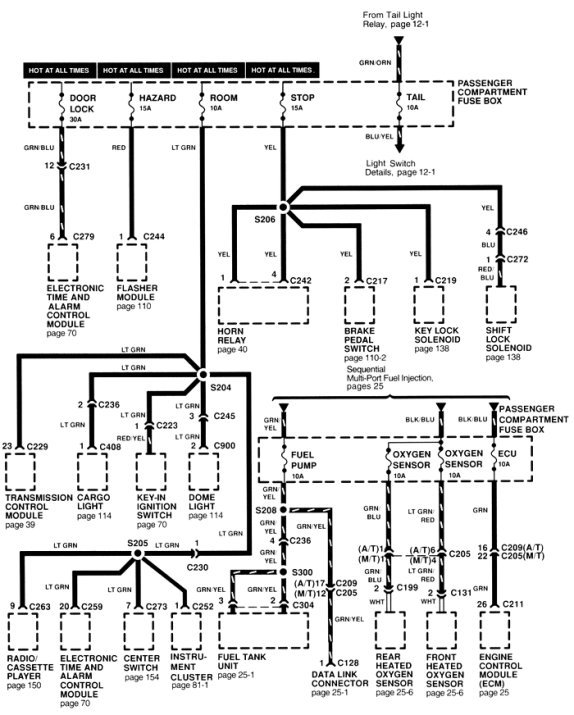

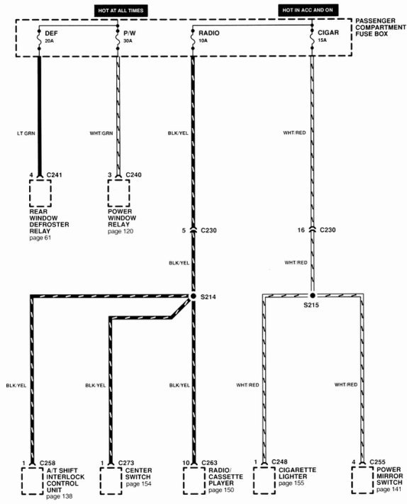

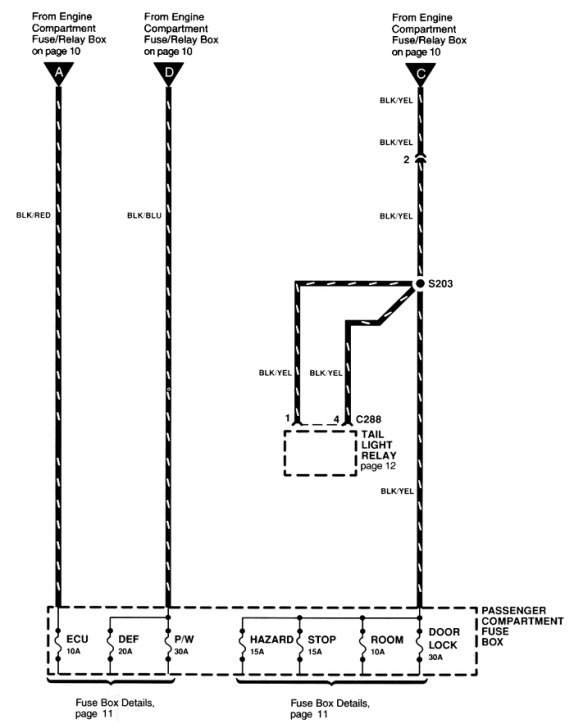

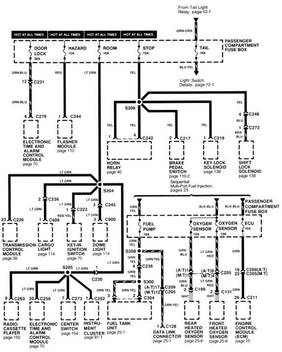

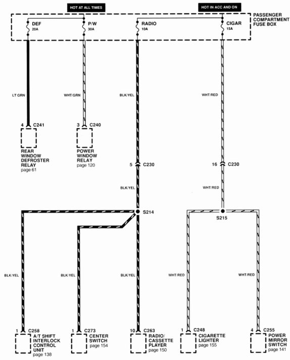

OK the first three are the power feeds into the vehicle. I would test that 80 amp AND be sure it is actually feeding power. If you look at the diagram the key switch does feed and control multiple items.
The next ones show the various fuses and what they feed. Going over them it shows that the items you don't have working are not all fed through the switch. Anything tagged as "hot at all times" should have power from the battery.
Another thing you could look at would be to connect a jumper cable from the ground on the battery to a good ground on the body. It's possible that the issue is on the ground side. Those normally connect battery negative to the engine chassis and body. If one failed it would act just like there was no power because the circuit is open.
