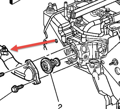

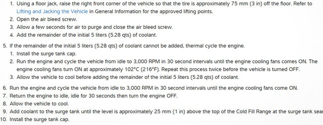

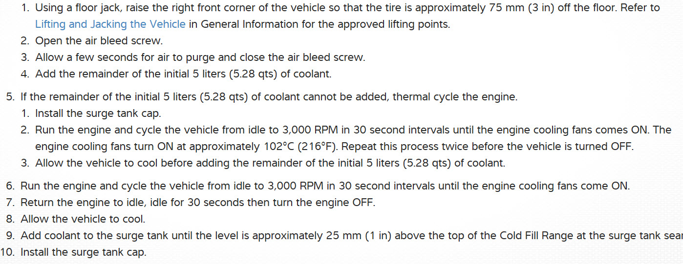

HMAC300
  • 48,601 POSTS
Check coolant level. It is probably low and for both heater hoses being hot. See pictures for way to bleed air. Air bleed will either be on thermostat or near top of radiator.
