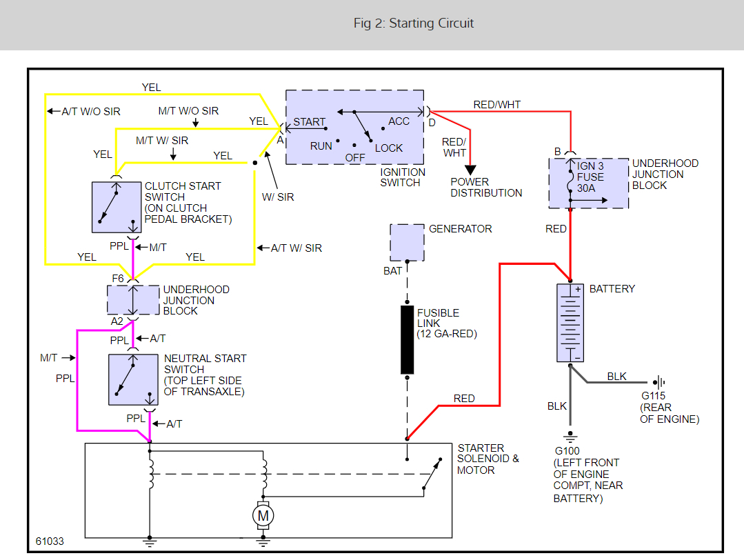

It makes a clicking sound coming from the center console
CONRADISH006
  • 1991 SATURN SL1
  • 1.9L
  • 4 CYL
  • 2WD
  • 184,000 MILES
I am fixing this car for a friend. And the battery had died so I tried to jump it and it would not receive a jump. So I tested the battery and it failed. So I replaced it. And that battery was dead. So I tried to jump it and the battery charged. But cranked twice and that was it. And whenever I climb in it makes a clicking sound coming from the center console. And the battery strangely dies. Even when it has not ran?

This sounds like a parasitic draw issue. Here is a helpful link that should help you run down the problem. Let us know what you find out.
https://www.2carpros.com/articles/car-battery-dead-overnight

I am going to test the ignition switch and the neutral safety switch. Could those be the problem?

Would the clicking be the neutral safety switch?

Have you had the second battery load tested? The clicking you hear could be the starter not receiving enough amps to turn the engine.

My friend took it to a mechanic. And he said that the valve cover gasket had blown and sent oil onto the spark plugs and wires. Causing a battey drain.
Tuesday, April 20th, 2021 AT 11:20 AM
KEN L
  • MASTER CERTIFIED MECHANIC
  • 55,266 POSTS
That does not make sense, can you ask him how spark plugs and oil can drain the battery?

I have no contact with this mechanic. He said that a rodent had chewed through the gasket. I am thinking this guy is lying.

It happens. here is a guide to help you check the wiring to the starter and the wiring diagrams so you can see how the system works:
Check out the diagrams (below). Please run this test and get back to us.

It has a generator instead of an alternator.
