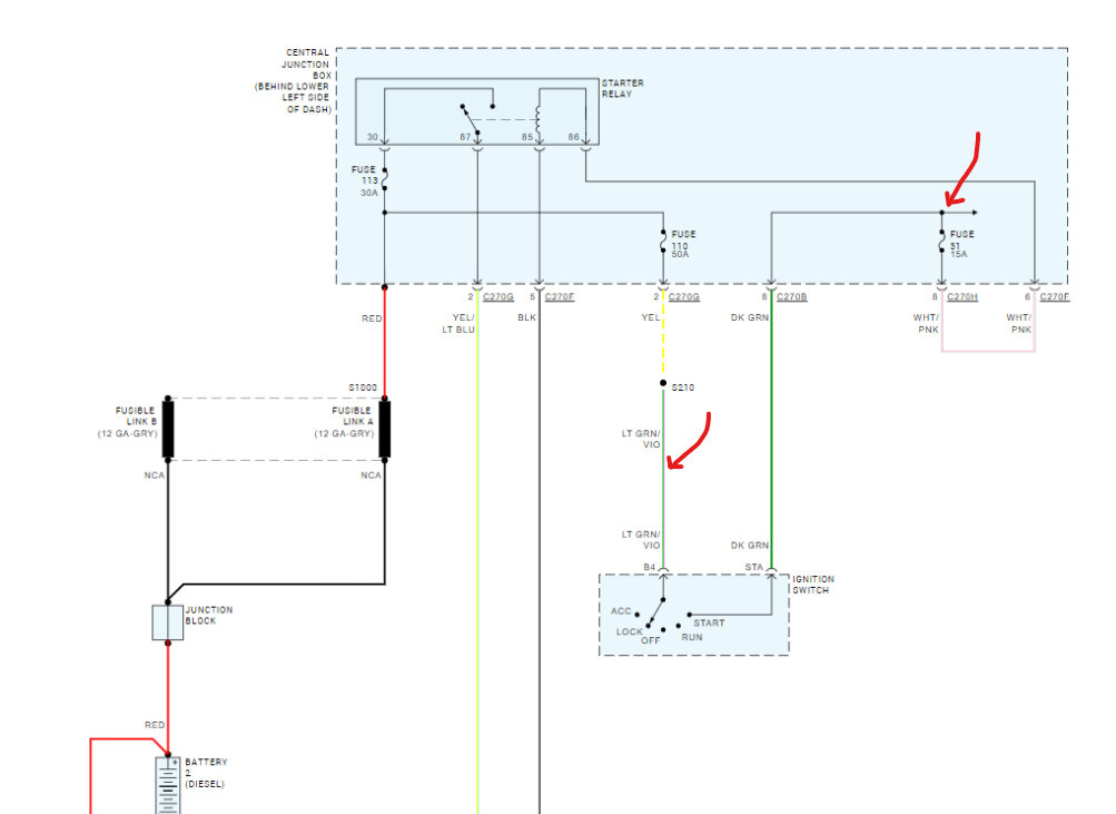

You should have power at both prongs, is the fuse blown? And you should have power at terminal 30 if not this is your problem. Please reference the starter relay wiring diagrams above.

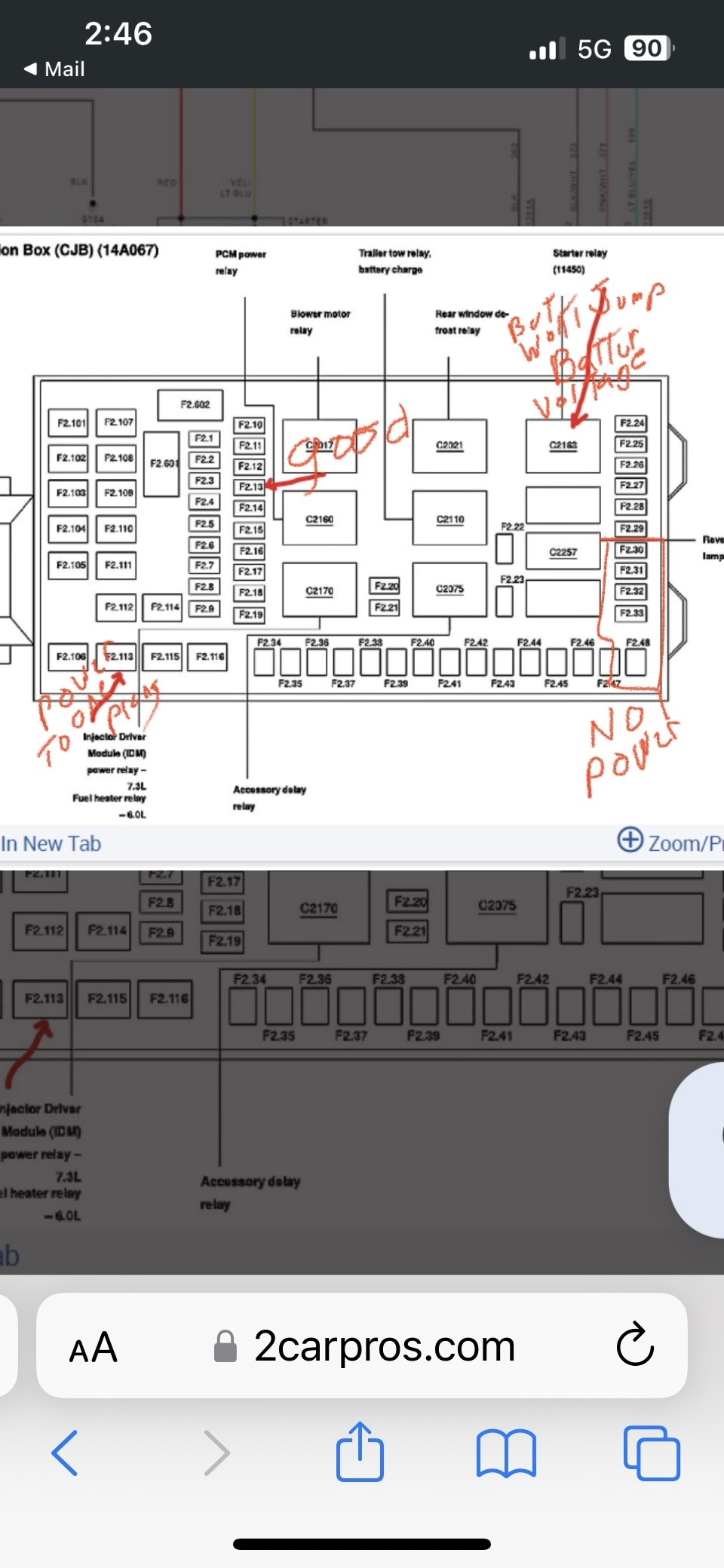

No, the fuses are not blown. I have triple and quadruple check them and replaced everything. The only thing left is the wiring harness and I have stripped the wiring harness and looked at every wire. I do not know what else to do. I’m at the end I don’t know, I’ve unplugged the fuse box and looked at all the wires. The Ford dealership doesn’t want to deal with it, so they won’t take it.

Sorry for the confusion when you said terminal 30, I thought you meant fuse 30. I measured battery voltage on the two inlets in the junction box where the starter relay plugs in. I tested only the two terminals that you use to jump. They both have battery voltage. But now when I try to jump nothing happens. The one fuse terminal in question is noted in my drawing I believe is 113. The upper prong lights up but the lower prong or terminal is dead. Also, in drawing the small fuses have no power. I think somehow 113 is connected to the other fuses through the motherboard. This is exactly what my first fuse box did and why I replaced it. So, I need to know which wires feed those terminals. Either that or I burned up a second fuse junction box. I haven’t taken it apart to check.

Okay, let's check for power at fuse # 31 with the key on, also if you have power there please check the ltgrn/vio coming out of the ignition switch in the crank position which you can get to by the steering column.

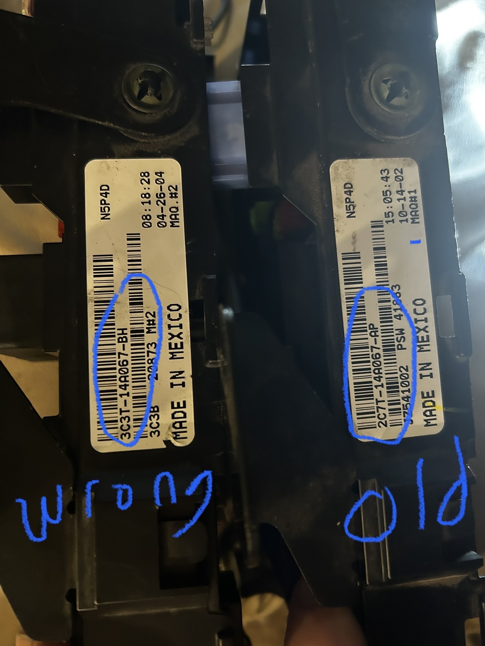

So, it turns out that eBay vendor sent me the wrong cjb. I’m sending it back today. It does seem odd though that it has the exact same issue with the wrong junction box. Either way I will be back as soon as I receive the correct one.
I also stumble on a very long forum page with some people having trouble finding the correct cjb for example mine 2c7t-14a067ap vs 3c3t-14a067bh and many variants could be problematic locating the one my truck will accept as well as I may have to have it reprogrammed. They also talked about replacing the ECM and other components. I know I’m getting ahead of myself here I’m just hoping it isn’t worst case scenario. Regardless I appreciate all of your guidance and will be back as soon as I get the new part.
