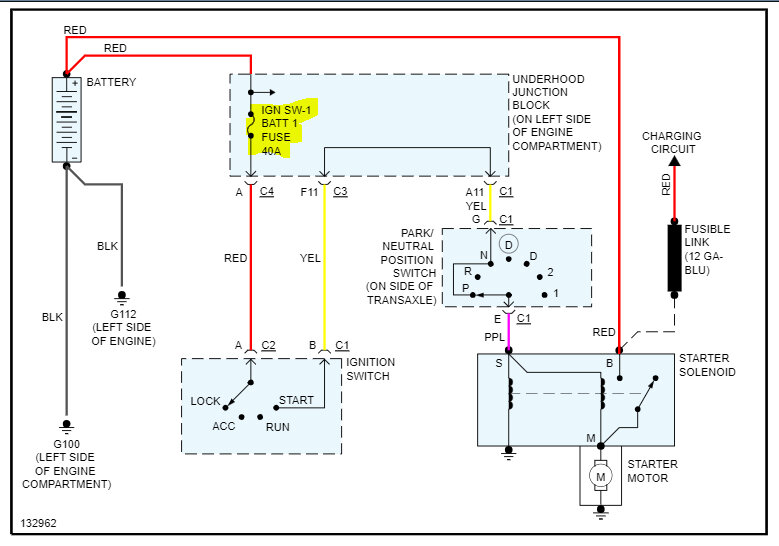

When tried to start nothing happened but dash lights go out until key turned back to on. Was running fine one day then not. No CEL codes on anti-theft security light.

When you say nothing happens, do you mean the starter doesn't engage or it does, and the engine doesn't start?
If the starter is not engaging, check and confirm the battery terminals are both clean and tight. If they are in good condition, see if it will start in neutral.

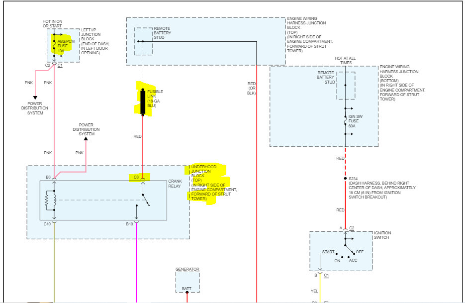

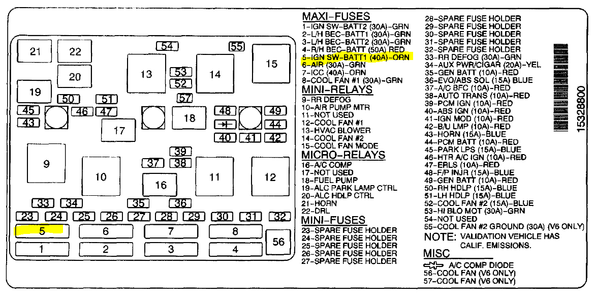

If it doesn't, check the ignition switch 1, battery 1 fuse in the under-hood fuse box. When you check it, confirm there is power to and from it.
I attached the starter circuit wiring schematic so that you would have a reference.
Let me know what you find.
See pics below. Note: Pic 2 shows the fuse location in the box.

Btw I have a 3.8l version of my underwood fuse box that looks different than the diagram you sent.

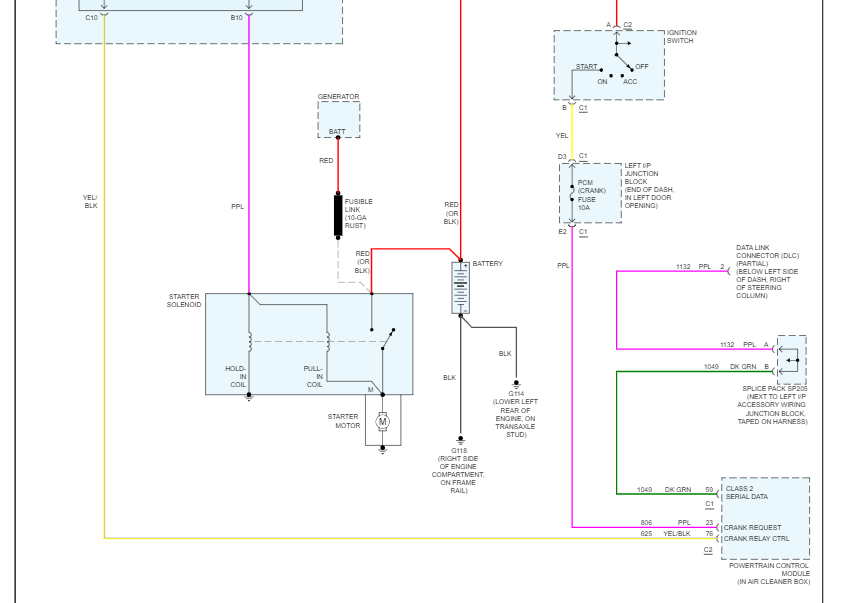

I forgot to mention my fuel pump doesn't prime either no crank at all when I try to start unless I jump it at the relay.

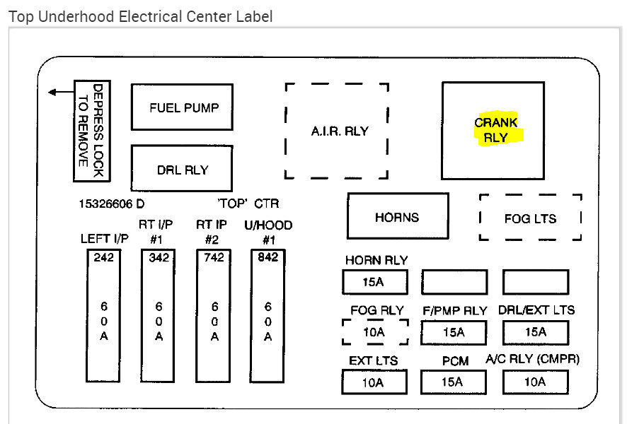

The crank relay is under the hood in the top electrical center. I need you to remove the crank relay first. Take a test light and connect the alligator clip to the battery-negative terminal. With the relay removed, there will be 4 connectors the relay plugs into. One of the pins should have power at all times. I need you to confirm that for me.
When you do this, have the key in the off position.
See pics below. Pics 1 and 2 are the starter circuit wiring schematic. I added it so you have a correct reference Pic 3 shows the crank relay positioning.
Thursday, August 31st, 2023 AT 8:01 PM

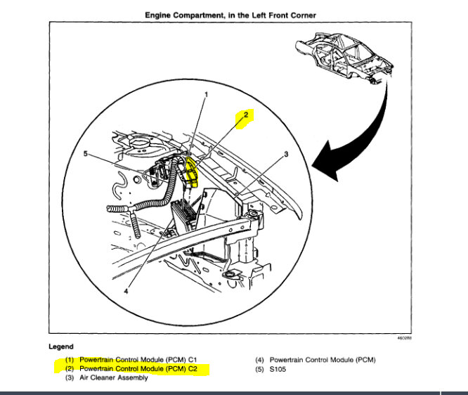

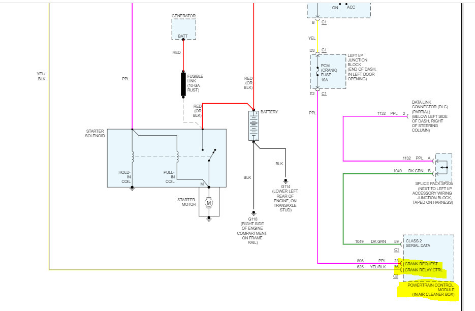

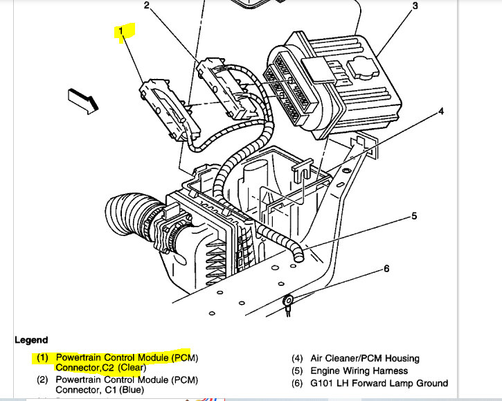

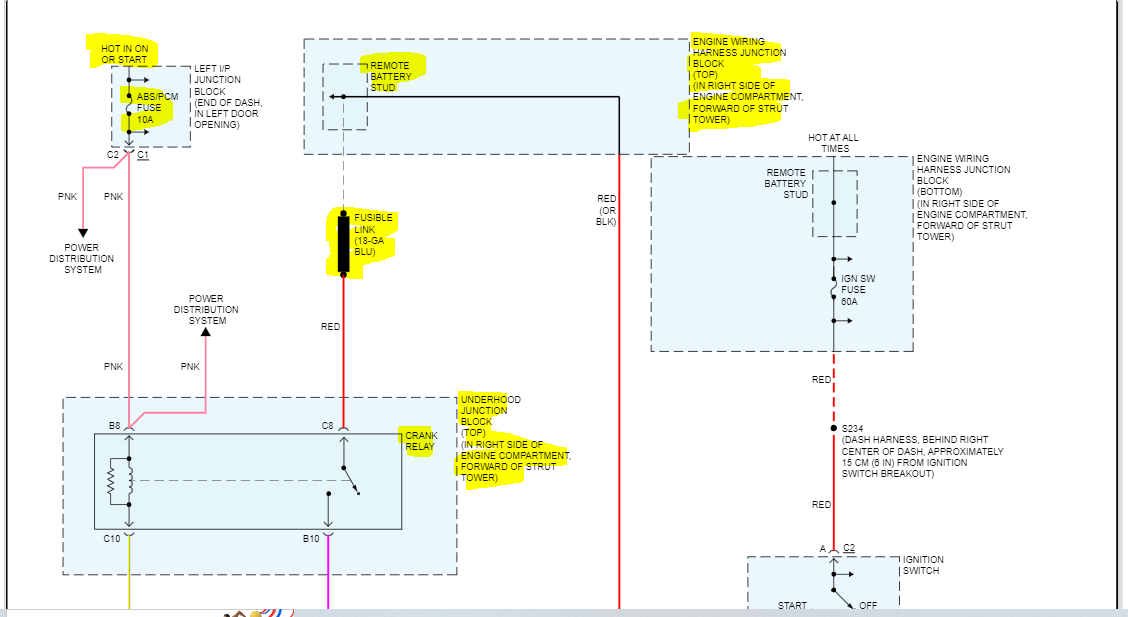

Okay, originally you indicated there is power to two of the pins. So that is good. If you are not getting a ground signal, we need to check the connection at the powertrain control module (PCM) in the air filter box.
I attached the schematic below, so you have a reference of the entire system. (Pics 1 and 2)
In pics 3 and 4, you will see the location of the PCM. Also, pics show there are two connectors, C1 and C2. We are interested in the C2 connector I highlighted.

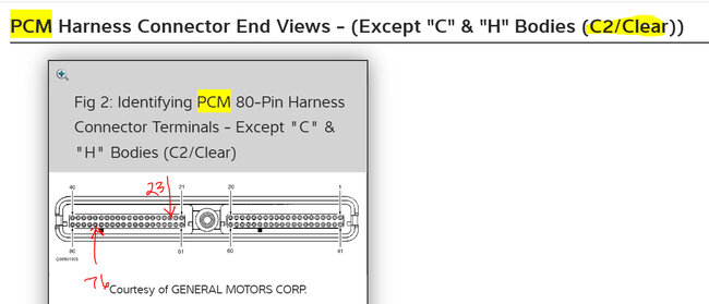

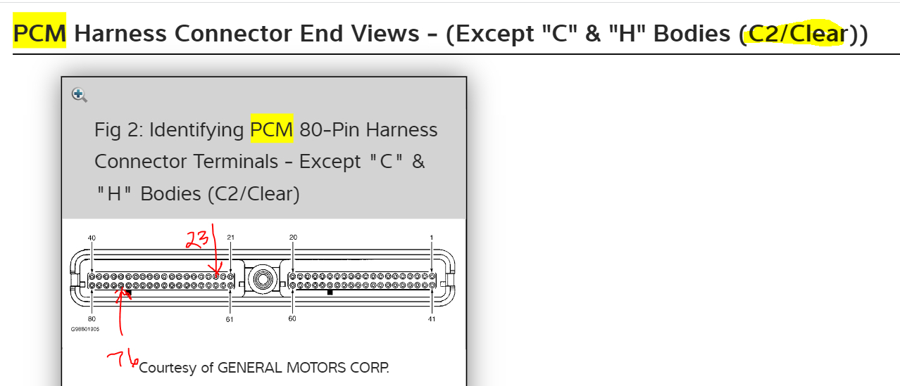

You will need to back-probe the purple wire and the black wire with a yellow tracer. When the key is in the start position, voltage should then be present at pin 23 (purple wire). Once that happens, the PCM should provide a ground path via pin 76 (black wire with a yellow tracer). See the last pic for the connector pinout.
If you have power to pin 23 and no ground from pin 76, the PCM is likely faulty.
Try this and let me know the results. Again, sorry there are so many steps. There are multiple things that can fail, and we are working backward to find the fault. Also, not that if pin 23 doesn't get power, then we need to recheck the crank fuse. Note that the crank fuse only should have power when the key is in the start position. Make sure it is present if you find now power to the PCM.
