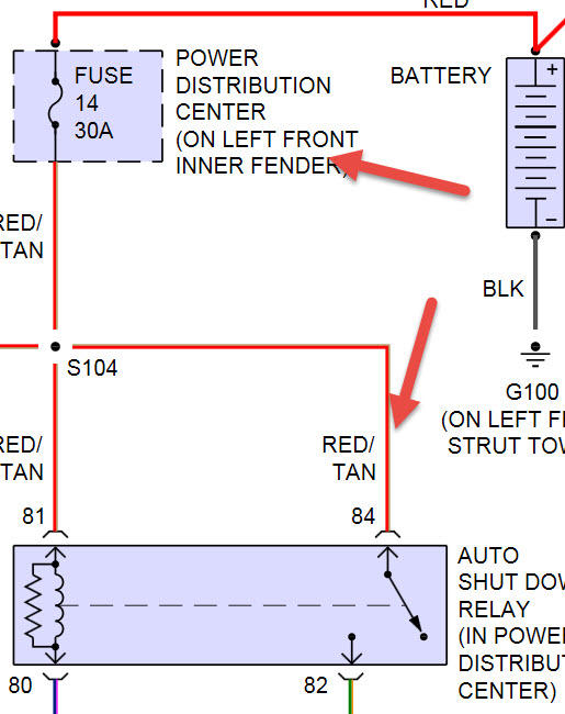

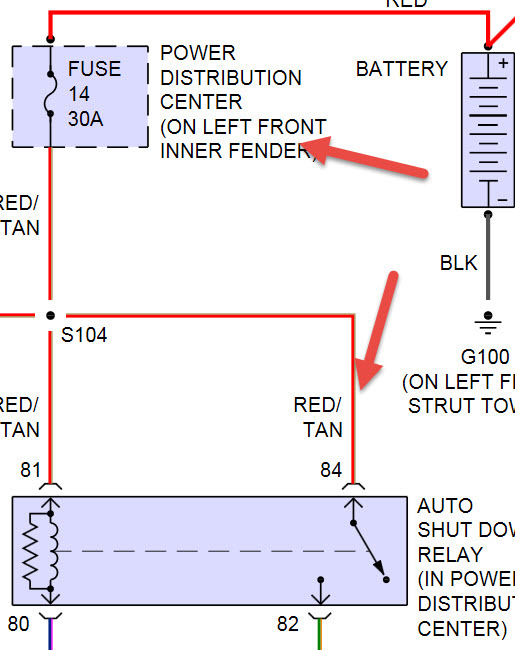

JUNIOR29
  • 2004 DODGE STRATUS
  • 6 CYL
  • 152,000 MILES
Hi I have a 2004 Dodge Stratus se and it won't crank or start only Battery is good the only light that comes on is the oil light does anyone know what could be the issue?
Thursday, August 20th, 2020 AT 8:22 AM (Merged)
HMAC300
  • 48,601 POSTS
Check items in picture. Then try resetting security system.
+1
