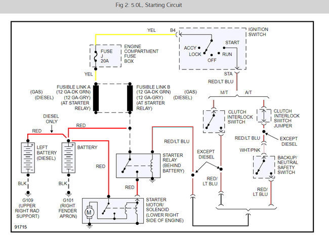

My engine is not cranking over like the starter is bad?
KEN L
  • MASTER CERTIFIED MECHANIC
  • 55,371 POSTS

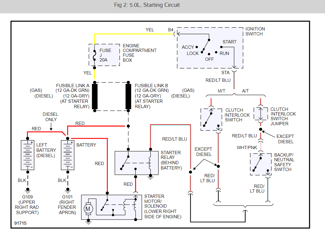

Yes, the solenoid needs to be grounded. Here is a guide to help us check for power and the starter wiring diagrams so you can see how it works and what to check for power. I would check the fusible links.
Monday, May 31st, 2021 AT 11:16 AM (Merged)

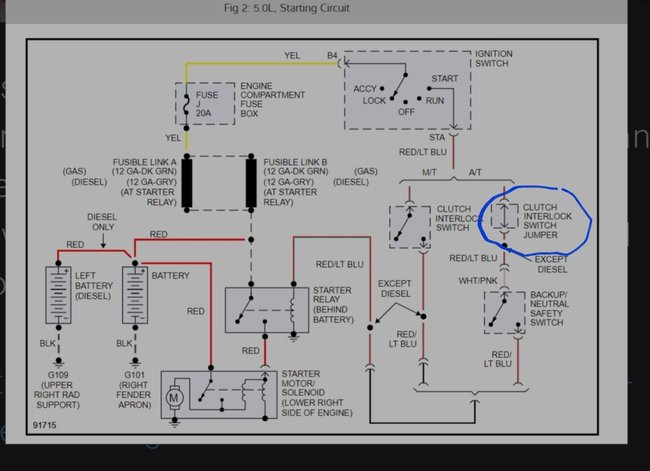

IVAN AZCUE
  • 25 POSTS
Is the interlock switch considered my my starter relay mounted on fender wall?
Or is that only for manual transmission?
IVAN AZCUE
  • 25 POSTS
Sorry just saw the starter relay is hooked up to the fusible links. Still curious about Interlock switch.
KEN L
  • 55,371 POSTS
That is a connector does nothing expect connect the circuit. Test for power to see where you lose it.

Truck would not start, I replaced solenoid, no change. Replaced battery and starter as well. The truck still will not start, but the positive battery terminal is getting hot. I tried checking the solenoid by bridging but either the battery is to far gone or I hooked something back up wrong on the solenoid. This an EFI truck. Any suggestions?

Check battery cables for internal corrosion. High heat usually means high resistance. These guides can help us fix it

Thanks Johnny G, I had found that to be the issue. Positive battery cable. Should have checked that earlier.

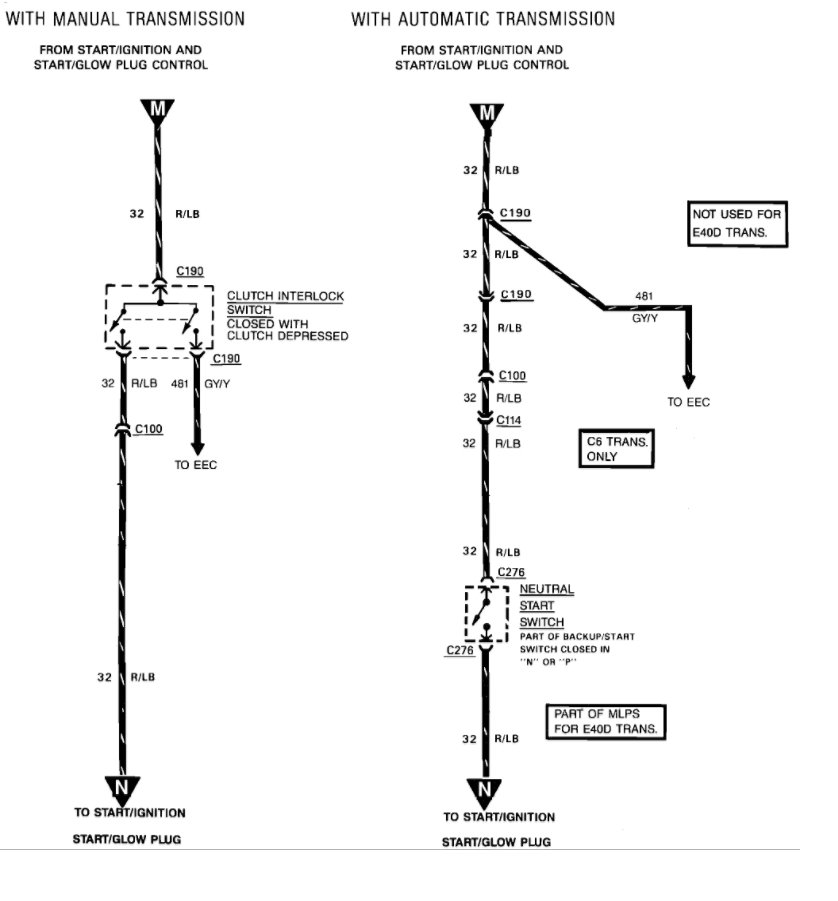

Truck turns over but will not start unless I push it and pop the clutch. Then it runs fine. I have changed all ignition parts, starter and ignition relay. I am completely out of ideas as to what could cause this condition. It has spark and fuel.
KEN L
  • 55,371 POSTS
It sounds like you have a clutch safety switch that is out. It is located at the top of the pedal see if you can locate it and then jump it and see if the engine cranks over.
-1

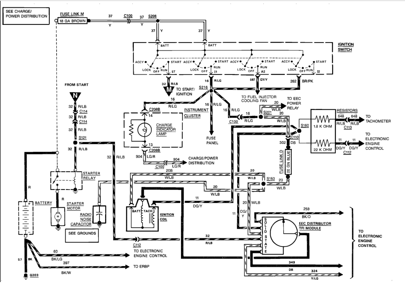

KEN L
  • 55,371 POSTS
Yes, the ECM is part of the ignition system. I would replace those relays because bad connections inside the relay create heat. Here is the starter wiring diagram you wanted. (Below)
+1
LUGNUT8
It was the clutch switch thank you.

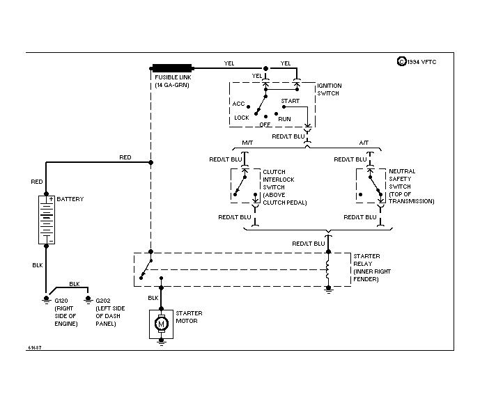

Hi if I turn the key on my truck noghing happens. I hae around 3.6 volts going to the s terminal of the solenoid when the key is on. If I jump across the solenoid I hear the starter click but thats it. Im really not sure what is going on. Any ideas? Turning the ignition key by itself does not seem to do anyghing. I did replace the solenoid thinking ghis was it, wrong. Ag least I have a new shiney one now lol. Thanks in advance for your help.
CJ MEDEVAC
  • 11,005 POSTS
Here is the starter wiring so you can see how the system works. Check out the diagrams (Below). Please let us know what happens.
HOMER1967
  • 875 POSTS
You say you have 3.6 volts at the s terminal on the solenoid, koeo?How many volts do you have when measured from post to post on the battery?
LEET522
Hi, around 12.4v
HOMER1967
  • 875 POSTS
Ok, that's good.I would suggest that you follow what medevac has provided for you and that should lead you to the root cause.
