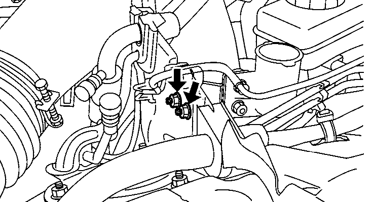

We went and replaced the clutch on son's car and seemed to work fine with exception of gears slightly tought to engage especially reverse and pedal engagement seem to be about 1/8" from the floor (car off ground). I figured it just needed to be broken in but son wanted to bleed clutch so he opened bleeder before I started pumping and clutch wen to the floor with no pressure after numerous attempts to build pressure. He went ahead and replaced with new slave and still same problem. I feel the standard pumping for pressure, holding down pedal and opening bleeder isn't helping (fluid barely comes out of bleeder) are we doing this procedure wrong?

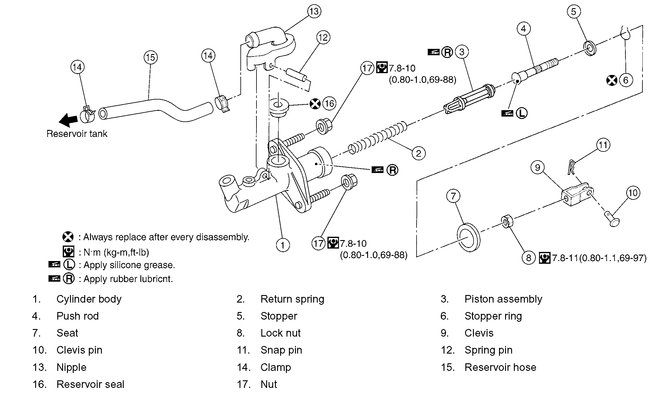

It sounds like the clutch master cylinder is bad. If the slave is new, there are no leaks, then the master cylinder is next. The idea that only a small amount of fluid comes out leads me to believe that is the issue.
Here are the directions for replacement. The attached pics correlate with the directions.
_____________________________
2004 Nissan-Datsun 350Z V6-3.5L (VQ35)
Removal and Installation
Vehicle Transmission and Drivetrain Clutch Clutch Hydraulic System Clutch Master Cylinder Service and Repair Procedures Removal and Installation
REMOVAL AND INSTALLATION
CLUTCH MASTER CYLINDER
pic 1
REMOVAL
1. Remove driver side kicking plate.
2. Remove footrest.
3. Remove dash side finisher (LH).
4. Remove instrument driver panel lower.
5. Remove VDC/TCS/ABS control unit.

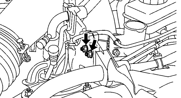

6. Remove snap pin and clevis pin from the clevis, and separate it from clutch pedal.

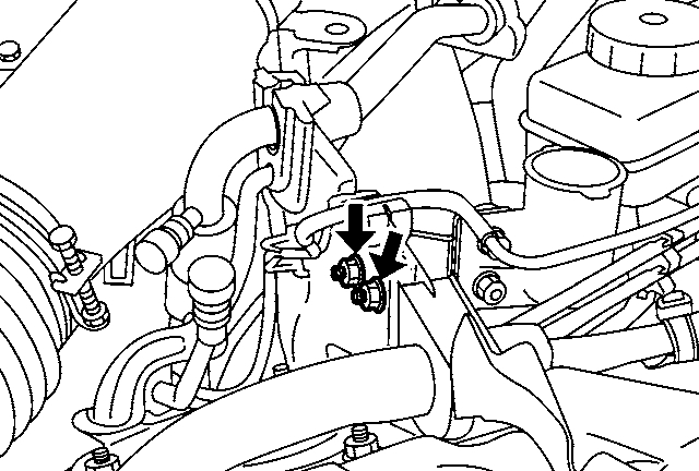

pic 2

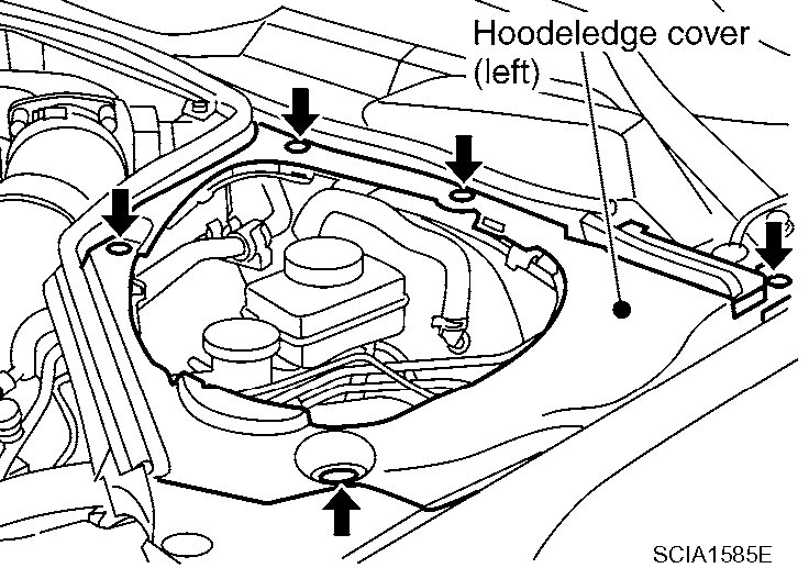

7. Remove clips (5), and remove hood ledge cover (left).
8. Drain clutch fluid in the reservoir tank and remove hose from nipple.
CAUTION: Do not spill clutch fluid onto painted surfaces. If it spills, wipe up immediately and wash the affected area with water.

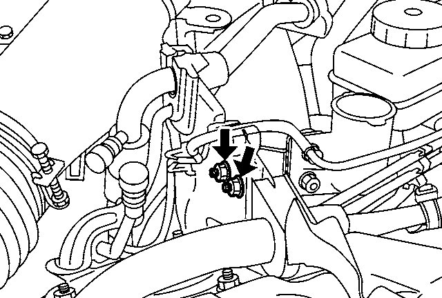

pic 3
9. Remove the reservoir tank mounting nut and then remove the reservoir tank.
10. Using a flare nut wrench, remove clutch tube.
11. First remove nuts on master cylinder assembly, and then master cylinder assembly from the vehicle.

pic 4
6. After mounting the hose over the nipple, install the reservoir tank in the vehicle.
7. After completing this procedure, inspect and adjust pedal height and then bleed the clutch tube.

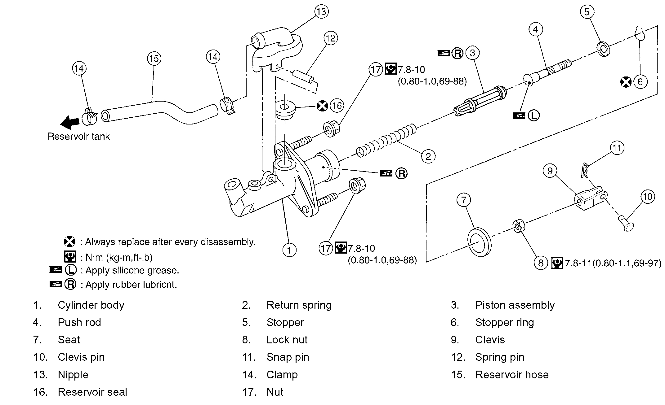

Here are the directions for bleeding.
Procedures
Vehicle Maintenance Fluids Clutch Fluid Service and Repair Procedures
PROCEDURES
CLUTCH FLUID
Bleeding
CAUTION:
^ Monitor fluid level in the reservoir tank to make sure it does not empty.
^ Do not spill clutch fluid onto painted surfaces. If it spills, wipe up immediately and wash the affected area with water.

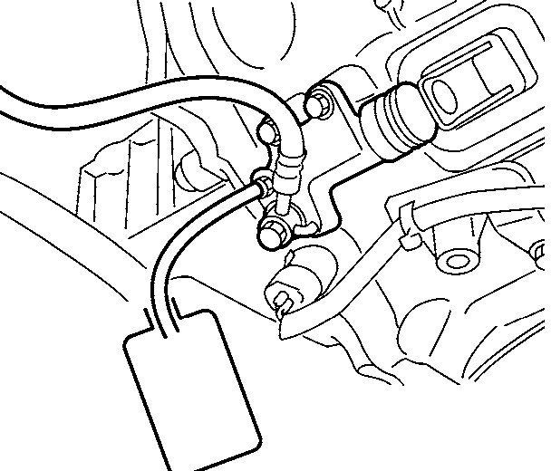

^ Bleed the operating cylinder.
pic 5
1. Fill the master cylinder reservoir tank with new clutch fluid.
2. Connect a transparent vinyl hose to the air bleeder.
3. Depress the clutch pedal quickly and fully a few times and hold
4. With clutch pedal depressed, open air bleeder.
5. Close air bleeder.
6. Release clutch pedal and wait for 5 seconds.
7. Repeat steps 3 to 6 until no bubbles can be observed in the brake fluid.
Air bleeder: 5.9 - 9.8 Nm (0.61 - 0.99 kg-m, 53 - 86 inch lbs.)

Because I was getting anxious and curious about the master cylinder, I decided to pull the master cylinder and reservoir assembly out to test. I was able to build pressure while out of the car, so we bench bled (without the bench) to fill the master cylinder and remove any air while out, reinstalled and before install hard line we bled the slave to remove any air from it then re-installed the hardline and it finally decided to build pressure and after a few minutes, a functioning clutch. The clutch is sensitive as is brand new so I know this will have to be broken in for at least 500 to 1,000 miles. Thanks for the guidance.
