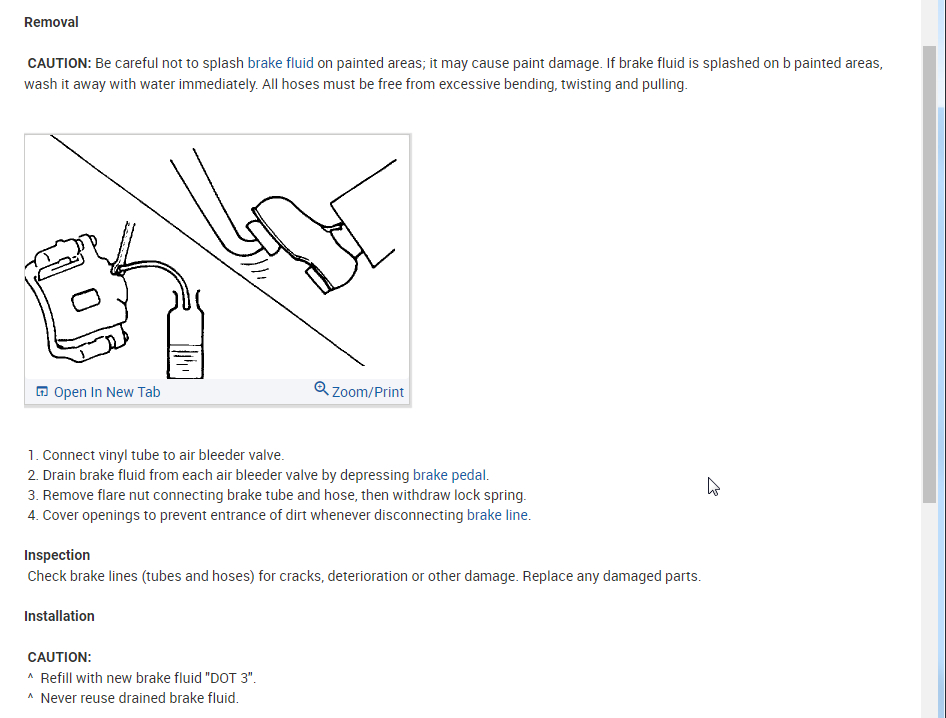

No brakes after changing rear brakes I found the rear brake hose is leaking.

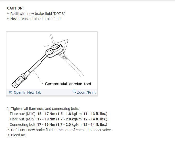

I am attaching the info from the manual on how to do this. However, you will need to bleed the brakes so here is a guide that will help with this:
https://www.2carpros.com/articles/how-to-bleed-or-flush-a-car-brake-system
Below is the process from the manual. Let us know if you have other questions. Thanks
