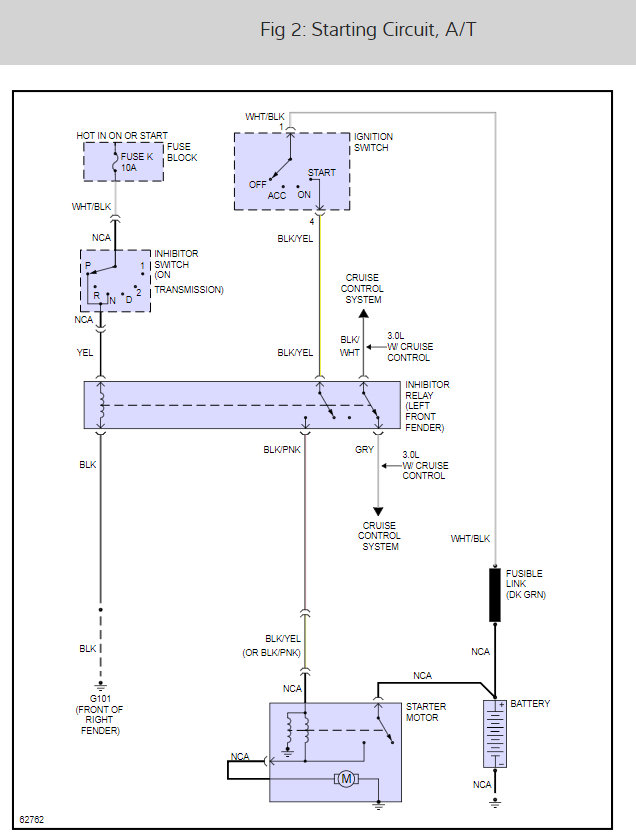

Drove my vehicle home night before last. Turned off after no issue commute. The starter is a month old, (I can hear the solenoid kicking)and no start or even turn. I went to Nissan and picked up another starter relay and installed today, no help. Same results. The battery is new and I am now at a loss as the obvious has been addressed. Can someone offer advice or direction?

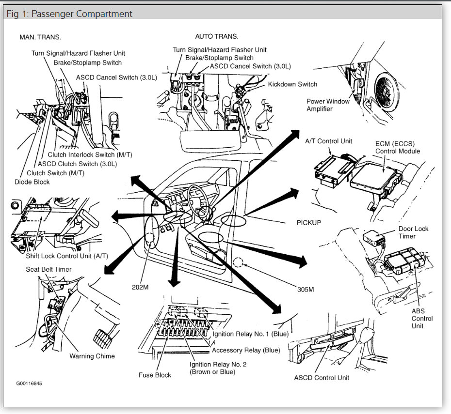

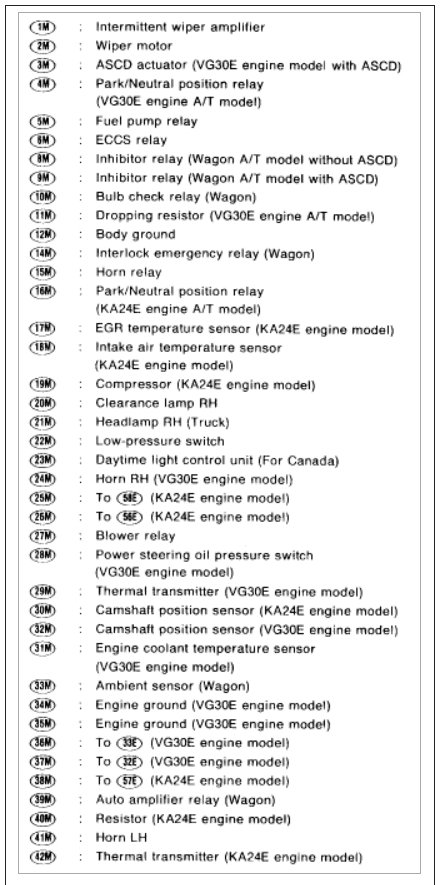

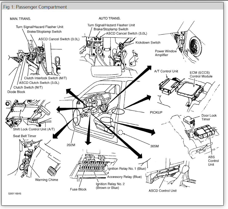

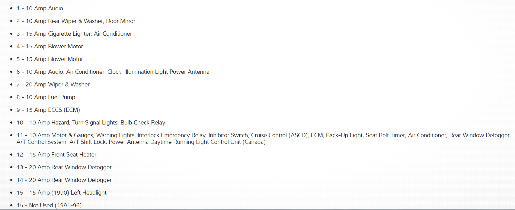

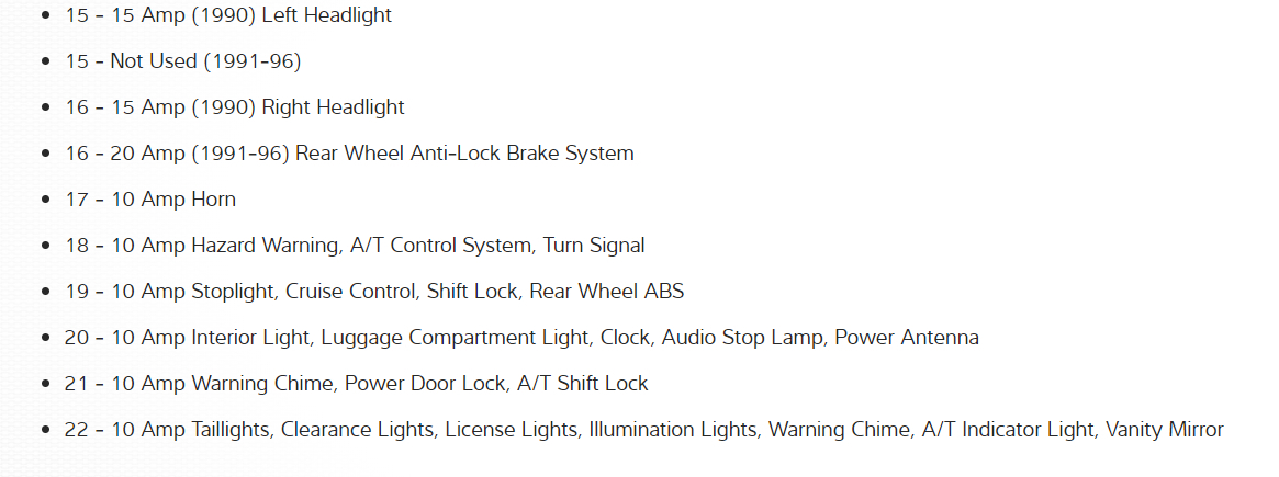

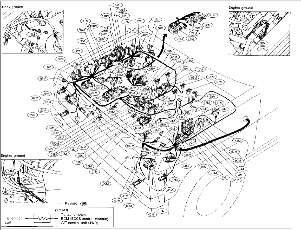

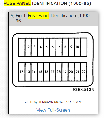

It sounds like you have an inhibitor relay that is not working. Here is a guide and the starter wiring diagrams and the location of the relay:
See where are are losing power. Check out the diagrams (below). Let us know what happens and please upload pictures or videos of the problem.

Well I swapped out the only two relays at that location and got the same click. I can hear fuel pump engaged, starter trying to throw out but still nothing more. Everything else turns on just fine.
