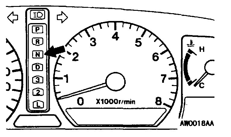

CHECK "N" RANGE LIGHT
pic 1
The "N" range light flashes at a frequency of approximately 1 Hz (once per second) if there is an abnormality in any of the items in the table which are related to the A/T system. Check for diagnostic trouble codes if the "N" range light is flashing at a frequency of approximately 1 Hz.
"N" RANGE LIGHT FLASHING ITEMS
pic 2
CAUTION: If the "N" range light is flashing at a frequency of approximately 2 Hz (two flashes per second), it means that the automatic transmission fluid temperature is too high. Stop the vehicle in a safe place and wait until the "N" range light switches off.

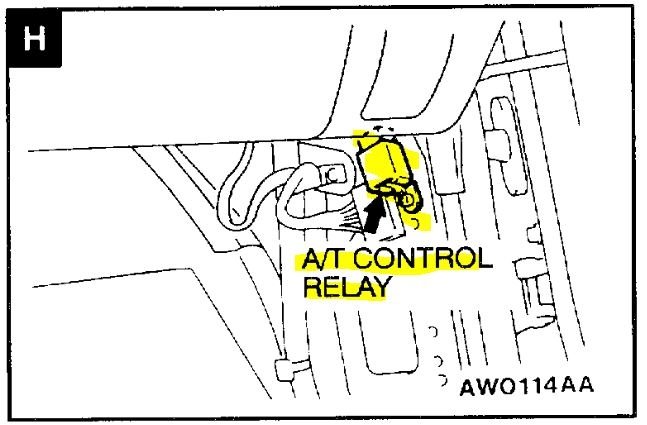

The code you were told is for the engine coolant temperature sensor, so that doesn't fit this problem. Based on what you described and without extensive testing, I suspect it could be related to the A/T Control Relay. The relay is located on the passenger side behind the kick panel. See the attached picture.
What I suggest is to test that relay. The other things which can cause the N light to come on will require upper level diagnostic equipment that most people can't afford. At least I know I can't. lol
Here is a link that explains how to test a relay:

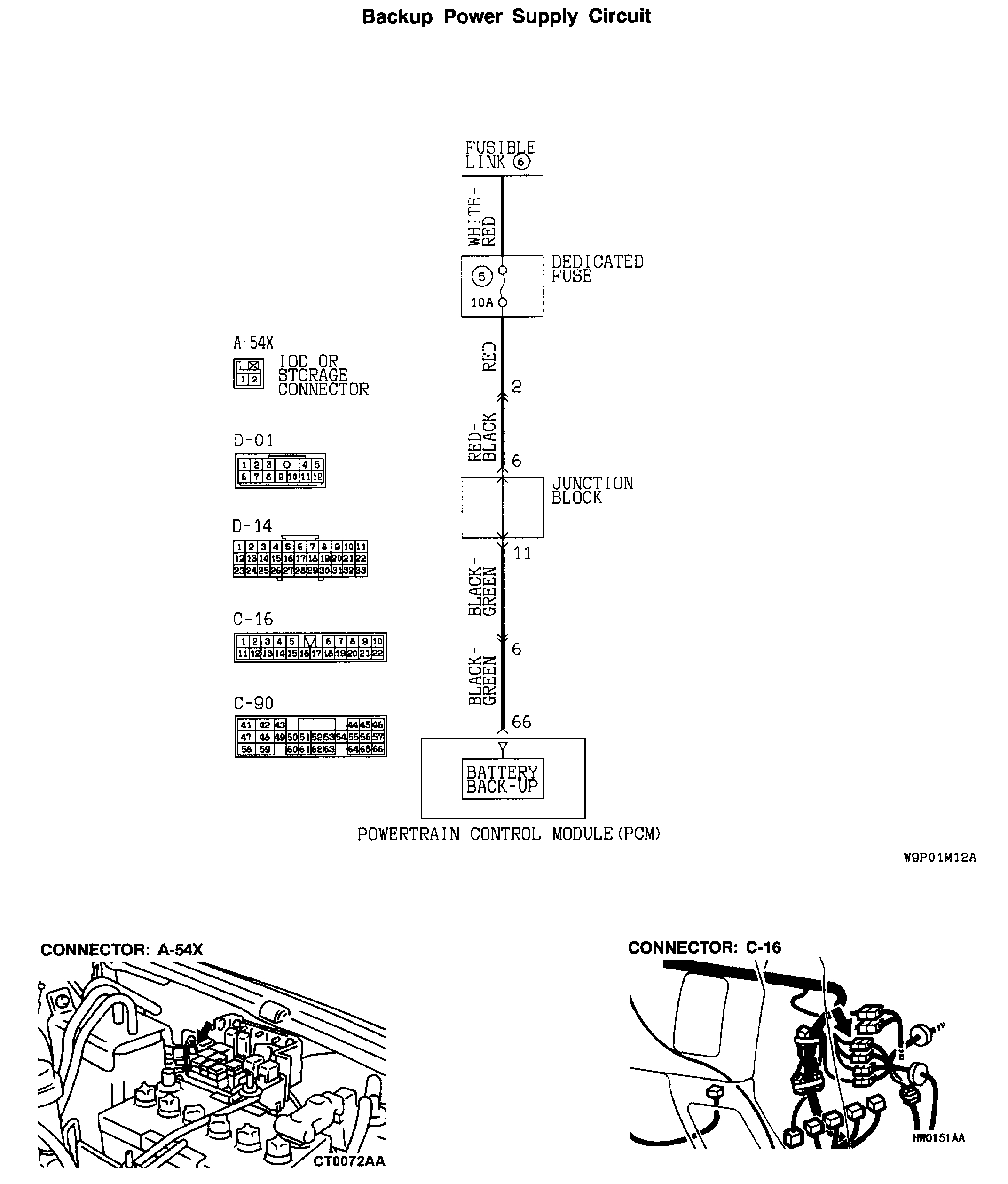

Pls the 2000 Mitsubishi Montero sport 3.0, won't change gear after the second gear. Could this have anything to do with the brain box?
+1
Friday, October 18th, 2019 AT 3:04 PM
  • 110,192 POSTS
Welcome back:
It could do with the computer, but could also be related to a shift solenoid issue, transmission line pressure, transmission range sensor, and so on.
If shifting does not occur while driving and no diagnostic trouble codes are output, a malfunction of the Park/Neutral position switch, or PCM may exist.
The most likely causes for this case:
- Malfunction of Park/Neutral position switch
- Malfunction of pattern select switch
- Malfunction of the PCM
These are the most likely causes of what you described. Here are the directions for trouble shooting these things. The attached pics correlate with the directions. I realize you indicated no experience, so I don't know if you can actually perform these steps. It does require a scanner and some basic electrical testing components. I will add a few links after the diagnosis list you may find helpful.
I don't like adding things such as these directions because I don't want to confuse people more. I hope you understand, but more so, I hope it helps.

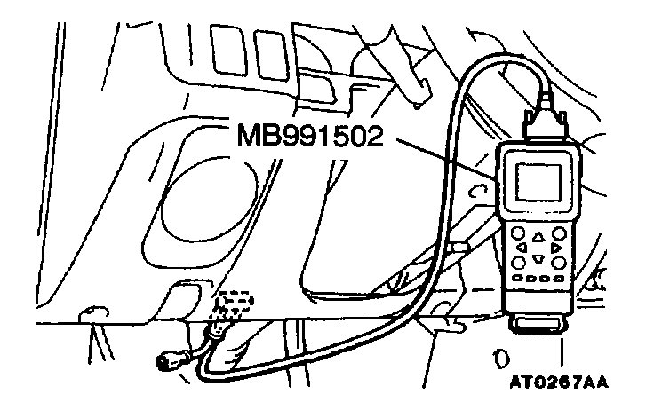

Pic 1
Pic 2
DIAGNOSIS
STEP 1. Does the vehicle accelerate poorly (transmission stays in 3rd gear) when starting from a stop with the selector lever in "D" range?
If yes, go to Step 2.
If no, go to Step 6.

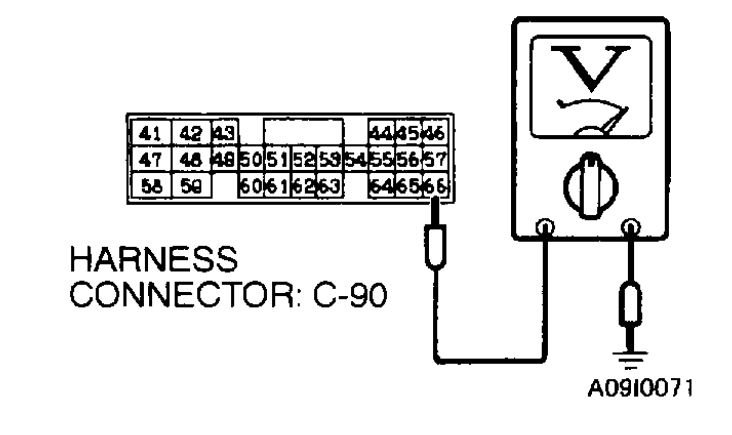

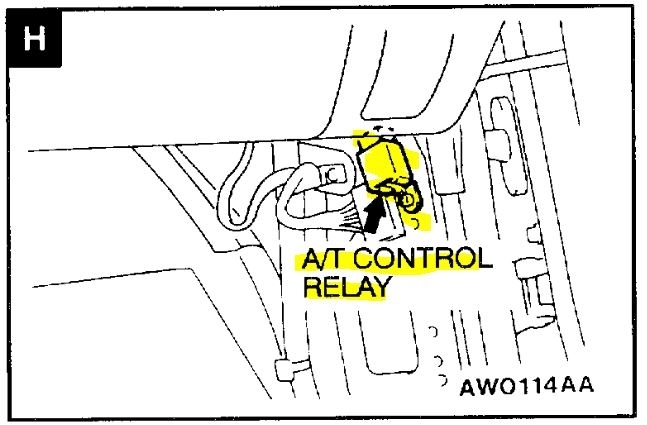

STEP 2. Check the backup power supply circuit.
pic 3
1. Disconnect harness connector C-90 and measure at the harness side.
2. Measure the voltage between terminal number 66 and ground.
- Voltage should be system voltage.
If not system voltage, go to Step 3.
If system voltage, go to Step 5.

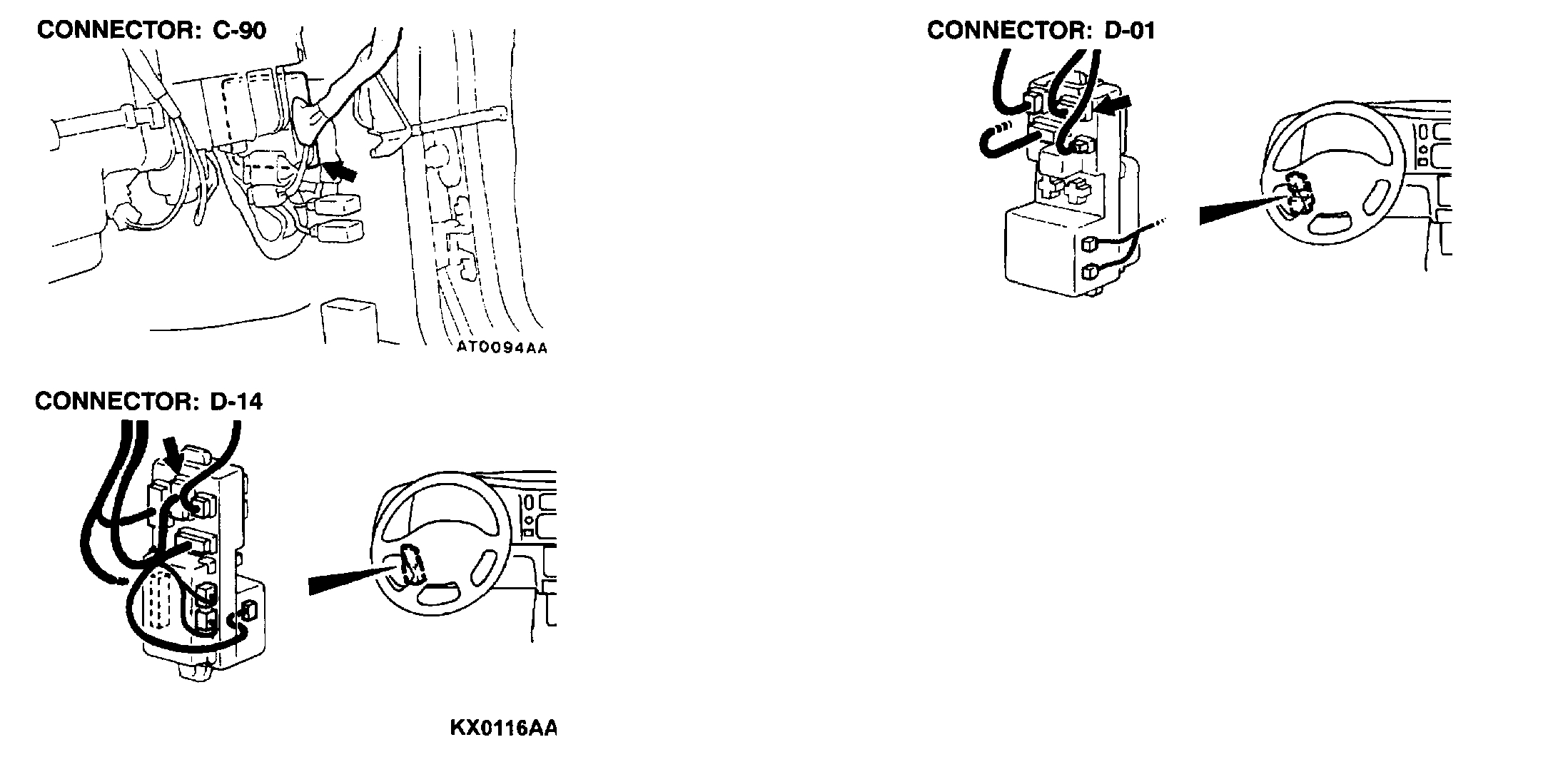

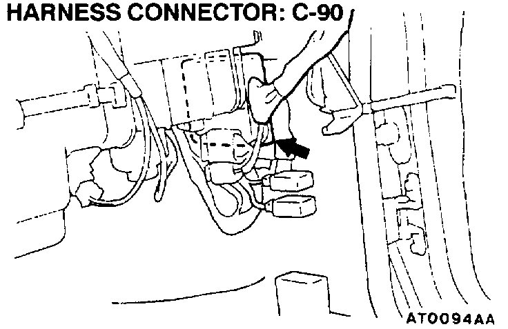

STEP 3. Check the harness connector C-90 at the PCM for damage.
pic 4
If harness connector C-90 is damaged, repair or replace it. Refer to Harness Connector Inspection. Then check the symptom.
If harness connector C-90 is in good condition, go to Step 4.

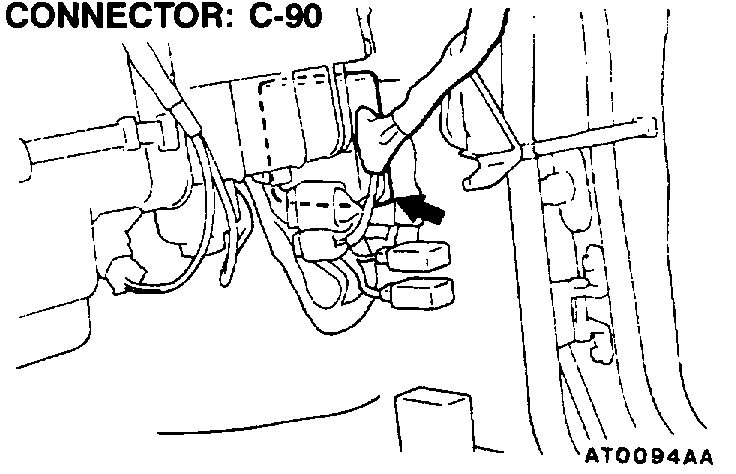

STEP 4. Check the harness wire between PCM connector C-90 and fusible link.
pic 5
NOTE: After inspecting intermediate connectors A-54X, C-16, D-01 and D-14, inspect the wire. If intermediate connectors A-54X, C- 16, D-01 and D-14 are damaged, repair or replace them. Refer to Harness Connector Inspection.
If any harness wire between PCM connector C-90 and fusible link is damaged, repair it. Refer to Harness Connector Inspection. Then check the symptom.
pic 6

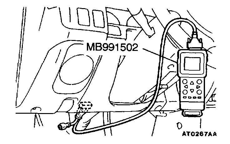

Required Special Tool: MB991502: Scan Tool (MUT-II)
CAUTION: To prevent damage to the scan tool MB9911502, turn the ignition switch "OFF" before connecting or disconnecting the scan tool MB991502.

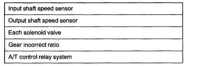

STEP 5. Is A/T diagnostic trouble code number 54 output?
If yes, refer to Code number 54 - A/T control relay system. See: A L L Diagnostic Trouble Codes ( DTC ) > Manufacturer Code Charts > DTC 54

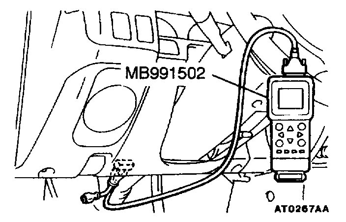

CAUTION: To prevent damage to the scan tool MB991502, turn the ignition switch "OFF" before connecting or disconnecting the scan tool MB9911502.
STEP 6. Using scan tool MB991502, check data list item 61: Park/Neutral position switch.
- Scan tool should show the selector lever position.
If scan tool does not show correctly (Park/Neutral position switch is not operating properly), refer to Code number 27 or 28 - Park/Neutral position switch system. See: A L L Diagnostic Trouble Codes ( DTC ) > Manufacturer Code Charts > DTC 27
If scan tool shows correctly (Park/Neutral position switch is operating properly), go to Step 7.
CAUTION: To prevent damage to scan tool MB991502, turn the ignition switch "OFF" before connecting or disconnecting scan tool MB991502.

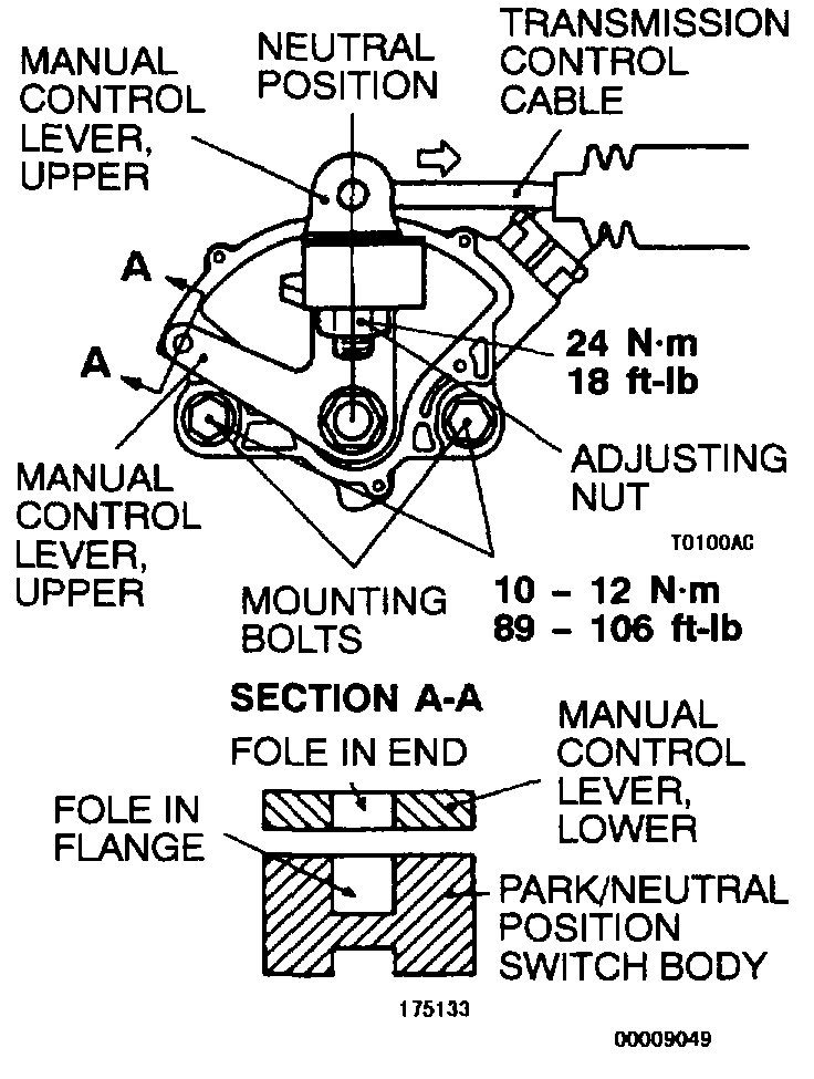

Since it shows neutral when the problem happens, I suspect the problem is the park / neutral switch, but that is nothing more than an educated guess. What I would like you to try is checking it for adjustment. Here are the directions. Also, the remaining pics correlate with these directions.
2000 Mitsubishi Truck Montero Sport LS 4WD V6-3.0L SOHC
Adjustments
Vehicle Powertrain Management Sensors and Switches - Powertrain Management Sensors and Switches - Computers and Control Systems Transmission Position Sensor/Switch Adjustments
ADJUSTMENTS
PARK/NEUTRAL POSITION SWITCH AND CONTROL CABLE ADJUSTMENT
Pic 9
1. Set the selector lever to the "N" position.
2. Loosen the control cable to manual control lever coupling nut to free the cable and lever.
3. Set the manual control lever to the neutral position.
4. Loosen the park/neutral position switch body mounting bolts and turn the park/neutral position switch body so the hole in the end of the manual control lever and the hole (cross section A-A in the figure on the left) in the flange of the park/neutral position switch body flange are aligned.
5. Tighten the park/neutral position switch body mounting bolts to the specified torque. Be careful at this time that the switch body does not move.
Tightening torque: 10 - 12 Nm (89 - 106 inch lbs.)
6. Gently pull the transmission control cable in the direction of the arrow, until the cable is taut. Tighten the adjusting nut.
Tightening torque: 24 Nm (18 ft. lbs.)
7. Check that the selector lever is in the "N" position.
8. Check that each position of the manual control lever matches each position of the selector lever.
