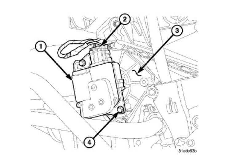

I need help. So cold air comes out on the drivers side when I have the heat on and hot air comes out in the passenger side. I already replaced all 3 actuators and nothing changes. I also put new coolant.

Did you replace the blend air door actuator? I'm attaching the directions. Let me know if this is what you did. Also, let me know if you have dual climate control.

The Dual Zone heating and A/C system has two blend door actuators, one for the driver side and one for the passenger side.
LEFT SIDE

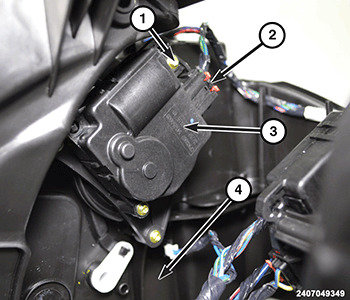

pic 1
1. Disconnect and isolate the negative battery cable. If equipped with an Intelligent Battery Sensor (IBS), disconnect the IBS connector first before disconnecting the negative battery cable.
2. Remove the steering column. See: Steering Column > Removal and Replacement > Steering Column - Removal.
3. Remove the two screws (4) that secure the blend door actuator (1) to the left side of the HVAC air distribution housing (3).
4. Remove the blend door actuator from the air distribution housing. Disconnect the HVAC wire harness connector (2) and remove the actuator from the vehicle.

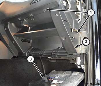

pic 2
2. Remove the push fasteners, disconnect the wire harness connector and remove the instrument panel closeout (3).
3. Remove the glove box and the glove box trim panel from the instrument panel. See: Glove Compartment > Removal and Replacement > Instrument Panel Glove Box - Removal.

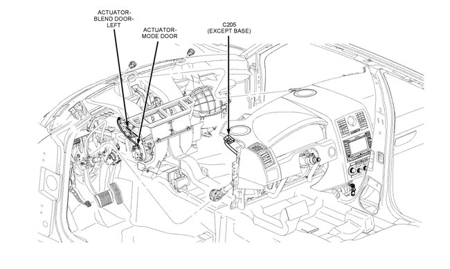

Pic 3
4. Remove the two screws (1) that secure the blend door actuator (3) to the right side of the HVAC air distribution housing (4).
5. Remove the blend door actuator from the air distribution housing. Disconnect the HVAC wire harness connector (2) and remove the actuator from the vehicle.

It is dual climate control and I did everything you told me and cold air still comes out when I have the heater on.

There is only one heater core, so something is preventing the actuator from moving the air flow door. Can you hear or see the actuator moving? Have you checked for power to the actuator?

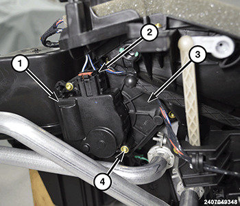

SINGLE ZONE/DUAL ZONE DRIVER SIDE
1. Disconnect and isolate the negative battery cable. See: Battery Cable > Service and Repair
2. If equipped, remove the instrument panel silencer from the driver side of the instrument panel See: Dashboard / Instrument Panel > Removal and Replacement > Silencer Panel - Removal.
3. Remove the two screws (4) that secure the blend door actuator (12) to the driver side of the HVAC air distribution housing (3).
4. Remove the blend door actuator from the air distribution housing and disconnect the HVAC wire harness connector (2) and remove the actuator from the vehicle.

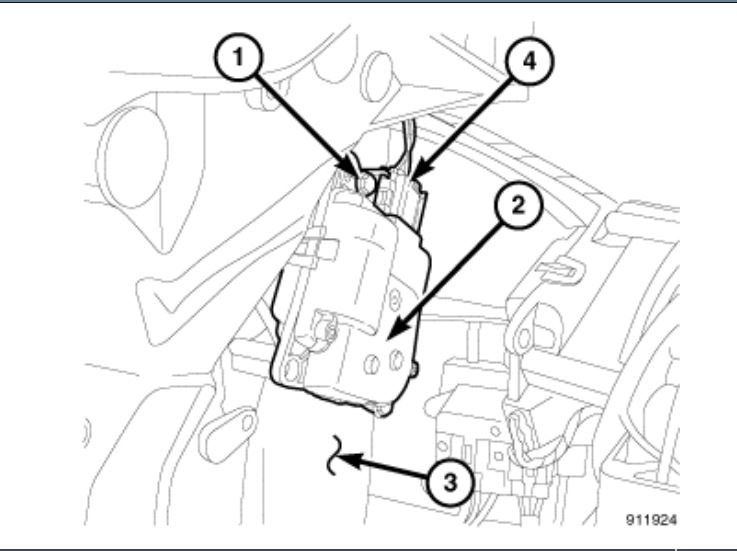

It sounds like the mode blend door actuator is not working right here isa guide to show you step by step how to replace it with diagrams below to help you see on your car.
