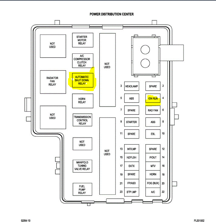

This vehicle has an auto shut down system. The Automatic Shutdown (ASD) relay supplies battery voltage to the fuel injectors, electronic ignition coil and the heating elements in the oxygen sensors. Have you checked fuel for an injector pulse?
https://www.2carpros.com/articles/how-to-test-a-fuel-injector
The ASD relay is in the power distribution box under the hood. I would check to make sure it is working. Also, confirm the ignition run fuse is good. In addition to just checking the fuse, make sure there is power. I attached a pic of showing both the relay and the fuse and how they are located in the power distribution box.

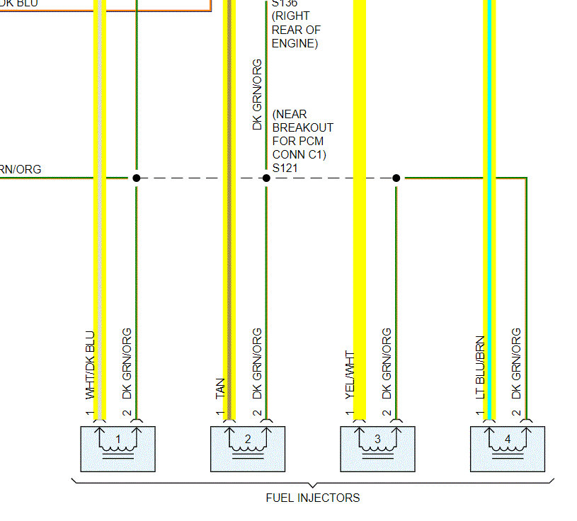

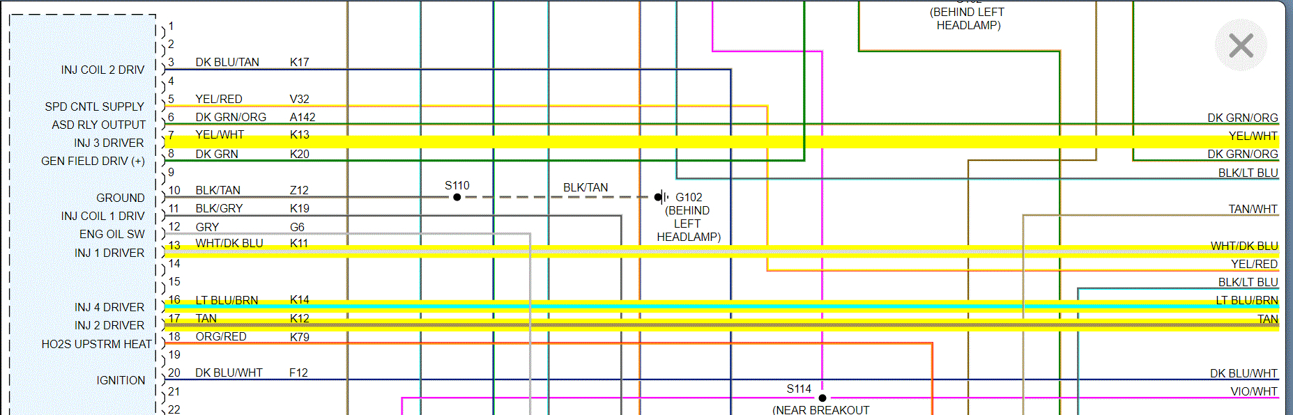

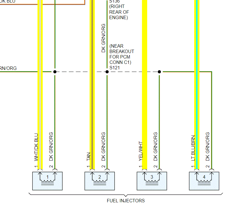

Ha! No problem. Are you checking with the engine being cranked over? The injectors receive 12v at all time. However, the circuit isn't completed until the PCM provides a ground path to each one. You need to go back to the PCM to see if there is corrosion, damage to wiring, and so on to determine why there is no voltage.

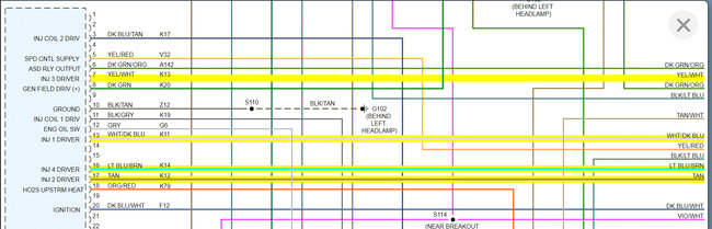

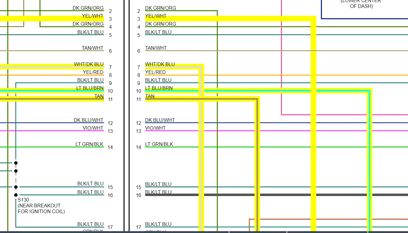

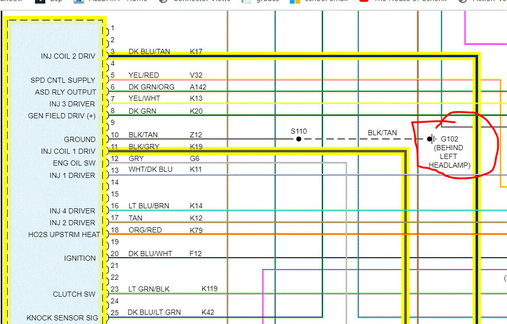

I attached 3 pics. Make sure you are checking the correct wires for power. Also, the highlighted wires go to the PCM (Pic 3). Check those connections.
Let me know what you find.

Are there still no trouble codes? And I know you said it was all checked before, but the ASD relay still is getting my attention. Body grounds? Ugh! Got to love cars.

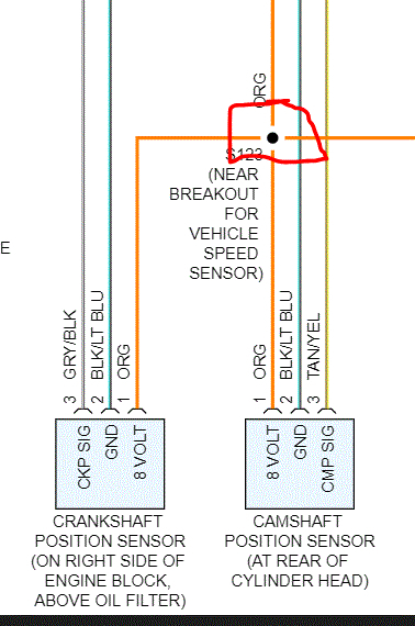

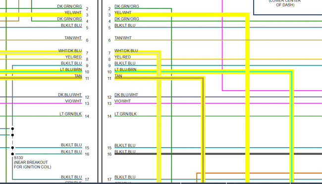

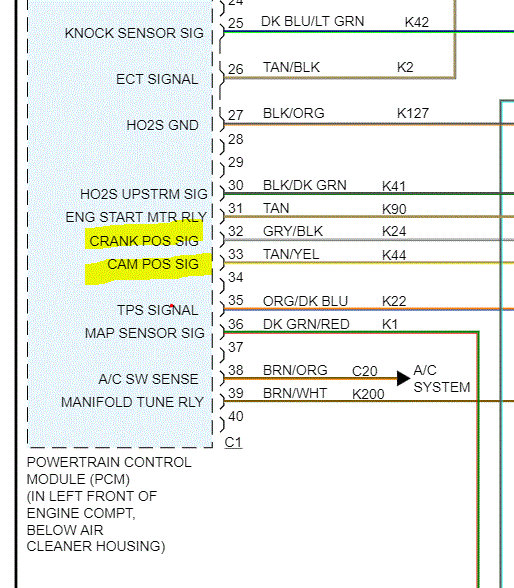

If you look at picture 3, check the ground I circled. Also, picture 1 shows a splice to the crank and cam sensors that could be an issue and picture 2 shows where the signal for the cam and crank sensors are located on the PCM.
