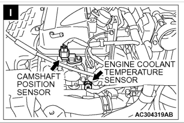

I ran into this problem on my son's 2003 Mitsubishi Outlander AWD 2.4L. It turned out to be the Camshaft Position Sensor. You can test it easily. The sensor is on the right side of the top of the engine, right above the end of the camshaft. 10mm bolt. When it is hot and won't start pull the Sensor out clean it and put it back in. If your car starts then it is the sensor. I got the import replacement at O'Reilley's for $59.99.

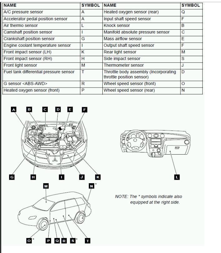

Great addition to this thread!
Here are some helpful guides and diagram (below) to get the problem fixed:
https://www.2carpros.com/articles/camshaft-angle-sensor-replacement

Computer readout said cam shaft sensor, changed that and changed spark plugs and wires still will not start

GINGERGRAYSHINN
P0118 the other sensor has been replaced. Thanks
Friday, November 1st, 2019 AT 10:06 AM (Merged)
SATURNTECH9
  • 30,869 POSTS
Thats the code for coolant temp sensor high input check the connector going to the coolant tempo sensor. Do you have a scan tool that will read live engine data?Also do you have a multimeter?
