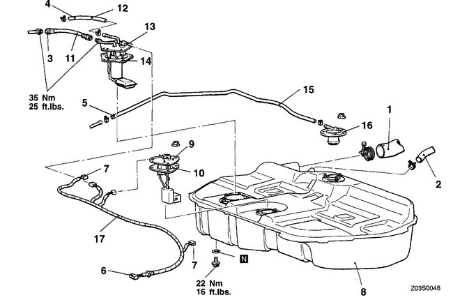

Where is the fuel relay and fuel pump located?

The fuel pump is in the fuel tank and the relay which is the multi-port fuel injection relay is under right center of dash.

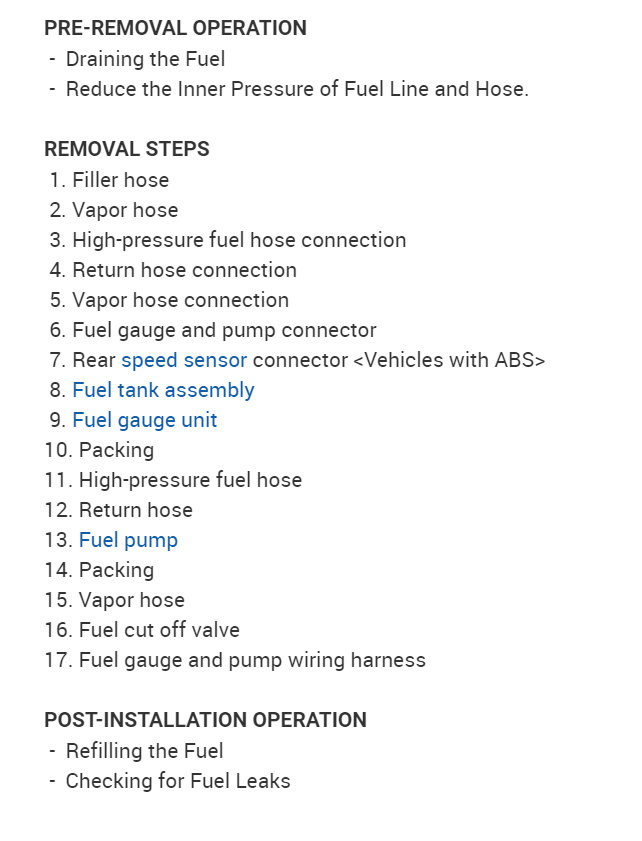

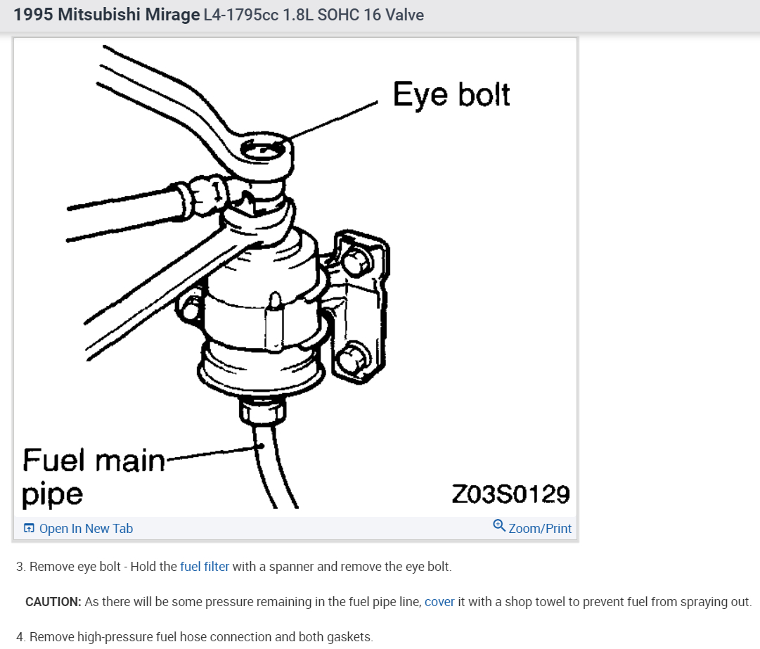

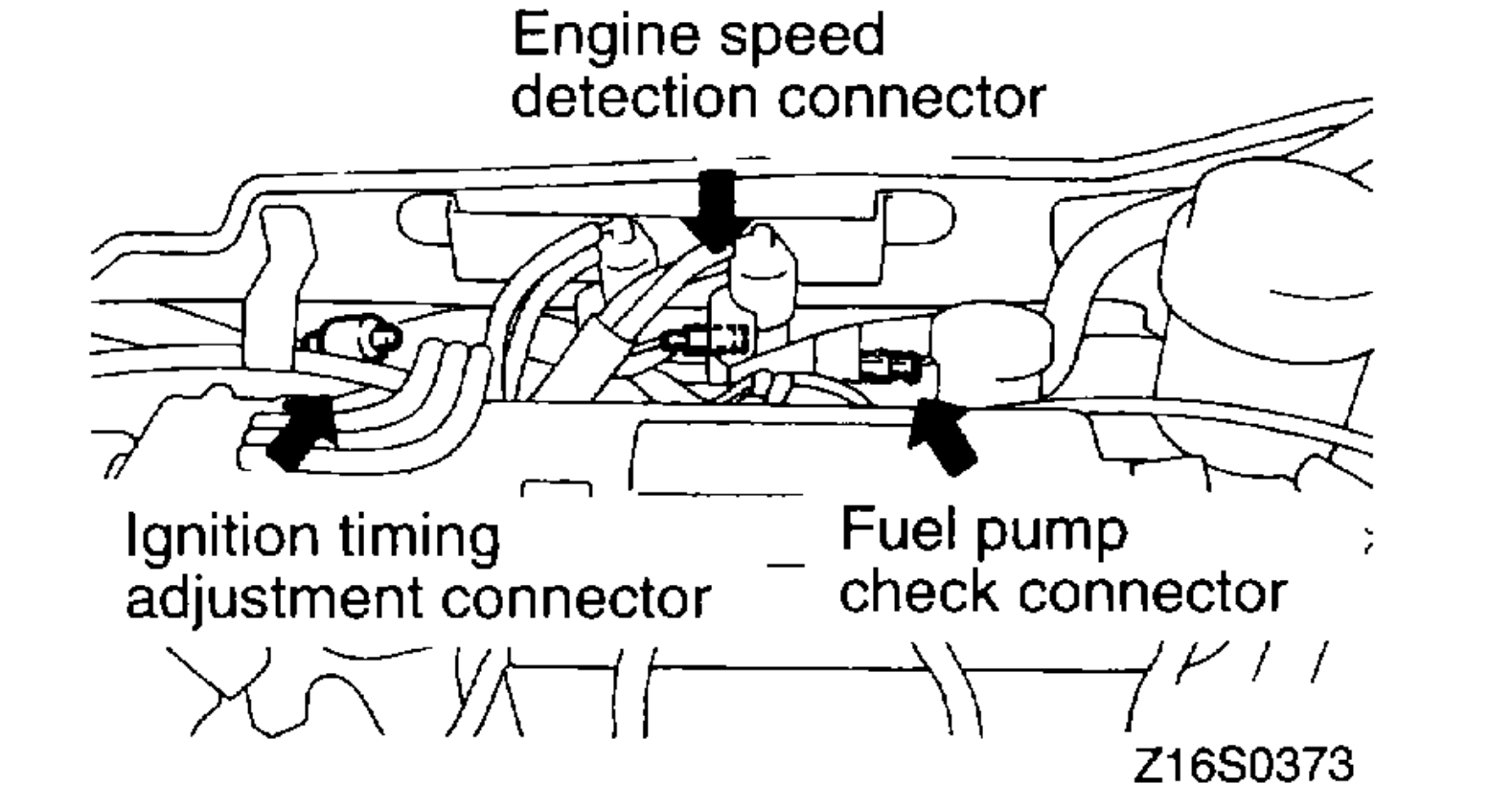

I have a 1995 Mitsubishi Mirage. I ran out of gas now it starts up after I let it said but then such the putt-putt and then shuts off. Is this the fuel filter need to be cleaned and how do I do it?

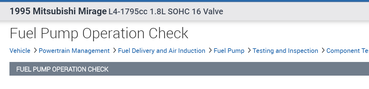

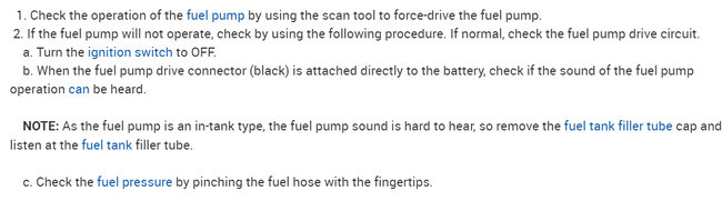

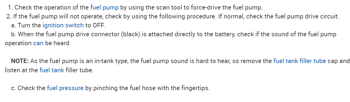

It sounds more like the fuel pump has gone out due to being run dry.To be sure lets run a pressure test. here is a guide to help us get started:

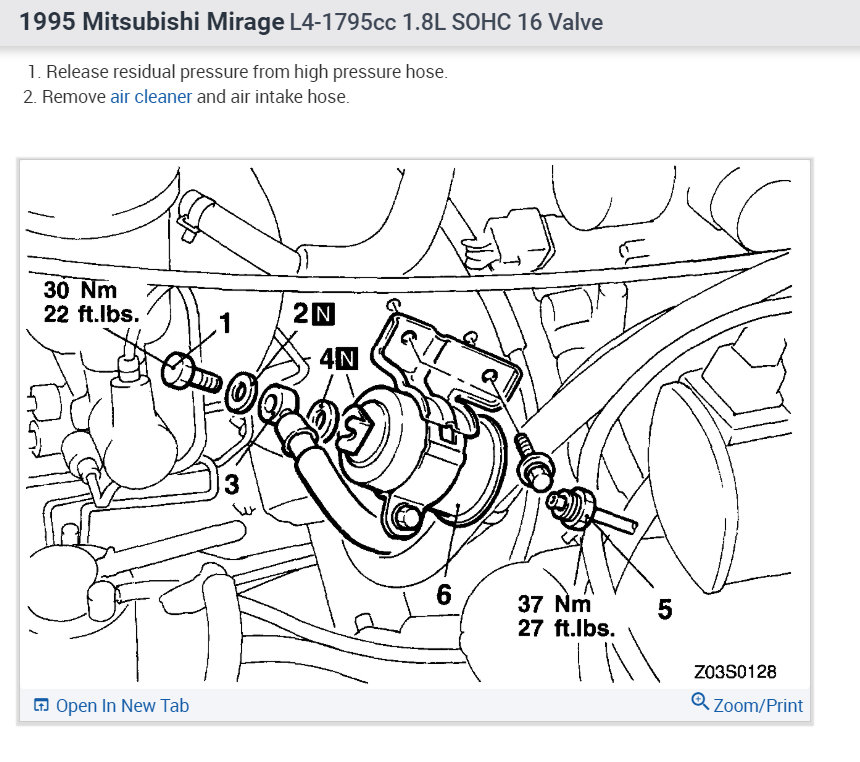

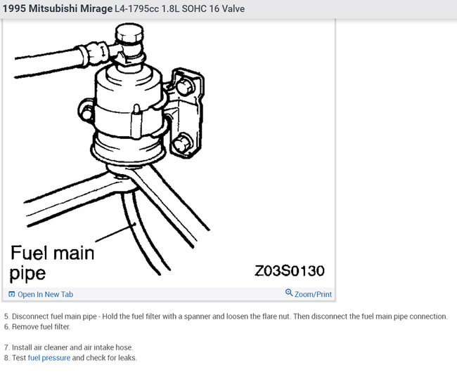

Here is a guide on how to change the filter as well with diagrams below to show you on your car:
https://www.2carpros.com/articles/how-to-change-a-fuel-filter

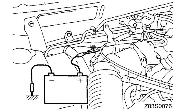

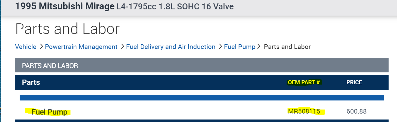

Changed the fuel filter still doing the same thing. The fuel pump how do I get to and do I have to change it or just clean it? Because I hear it click on when I start the car.

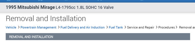

In the diagrams down below I have included guides for testing and inspecting your vehicle's fuel pump, fuel pressure and also instructions for the removal and installation of the fuel pump should it be bad. Please go through these guides and get back to us with what you are able to find out.
